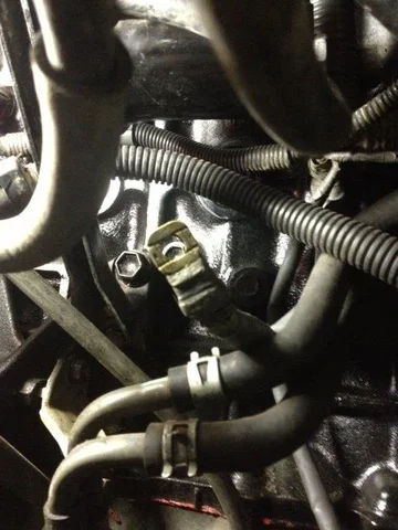

I am about finished with my 1FZ-FE rebuild and putting everything back together. However I am not sure where this one connection goes from the main engine harness. I have attached a picture. I think it connects to the starter but not sure and already have another connection to the starter (stud and nut connection). Anyway I took all of this apart about 7 months ago and can't remember how it should hook back up.
Thanks for the help.....

Ok. I did find the starter pictures in another post and it appears I have the correct starter connections but still not sure where this engine harness connections goes. Can someone post a link the the main engine harness connection diagram? I will continue to search through the forum post and if I find my answer I will update this post.

I'm not 100% sure because I haven't been that far down my engine bay, but it looks like the ground that connects to the engine block. Not sure exactly where it bolts up either.
On a 22r and a 3vz fitted truck, its usually bolted up near the engine mount on the same side as the starter.
TomH,
That's it. Thanks so much for the picture and help.
