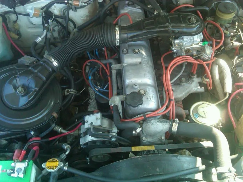

It's a 62 air cleaner, but an 80 could be modded in a simlar way I suppose. The key is:
1. Need to desmog
2. Find a carb cap (difficult).
1. Need to desmog
Lovetoski-
Love either your diff breather hose extension cap or someone nicked the other end of your fuel line from the the fuel filter!
Nice air filter build.
its probally a differential breather solution....using a small fuel filter...

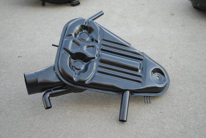

I'm using a 62 filter can with the 80's reusable filter element in it for my engine swap. As supplied the lid to my filter can was configured to bolt the air flow meter in place. It looked nothing like the filter in the pic above. More like this:
There are two filters...one is for the front & rear diff breathers, and the other is for the transfer case. I probably could have found a more elegant way to finish those off, but the cheap and durable zip tie won out due to it being so easy.

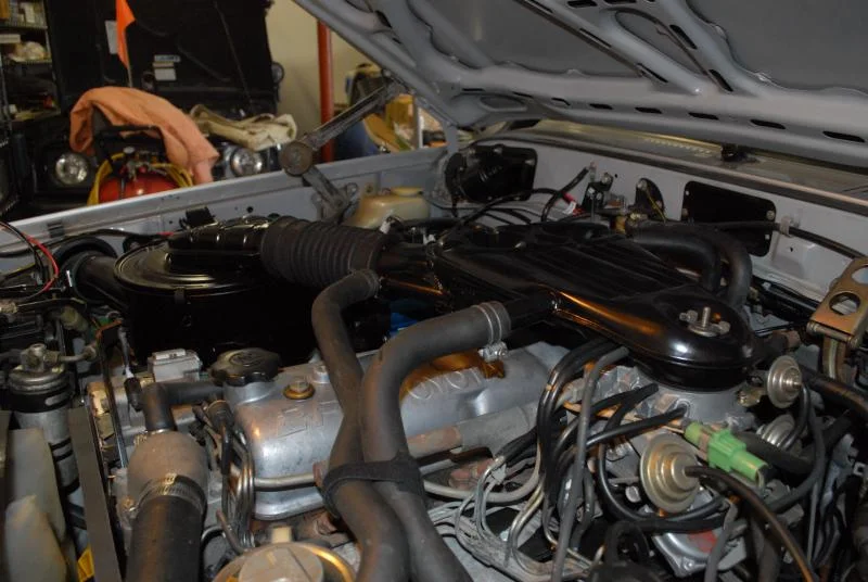

If your wanting the 62/80 air filter canister so that you can hook-up a snorkel to the 60's carb here's another option.
Take the 62/80 air filter canister, pick-up an Isuzu flex air filter hose from a "Pick-n-pull" scrap yard and convert your existing smog equipt air filter assemble to accept the new air filter canister and keep all your smog gear intact.
Good luck

Additional shots...
