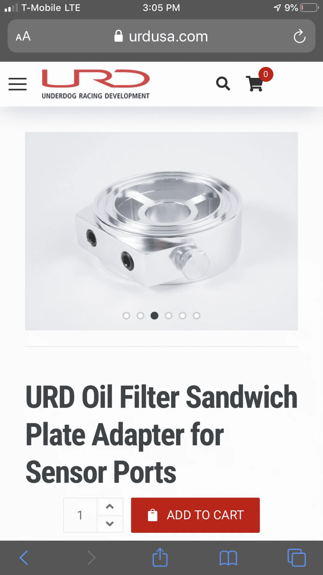

I ran my aftermarket sensors (temp & pressure) off a sandwich plate adapter that was threaded for 2 sensors. It fits flush between the engine block & oil filter.
Yeah I was thinking sandwich plate if I'm unable to only use just the aftermarket oil sender. Ideally I want to use the single aftermarket oil sensor to send signals to both the PLX and oem in dash idiot light. I still want the dash light just in case if I don't catch it on the gauge. I like the idea of backups!

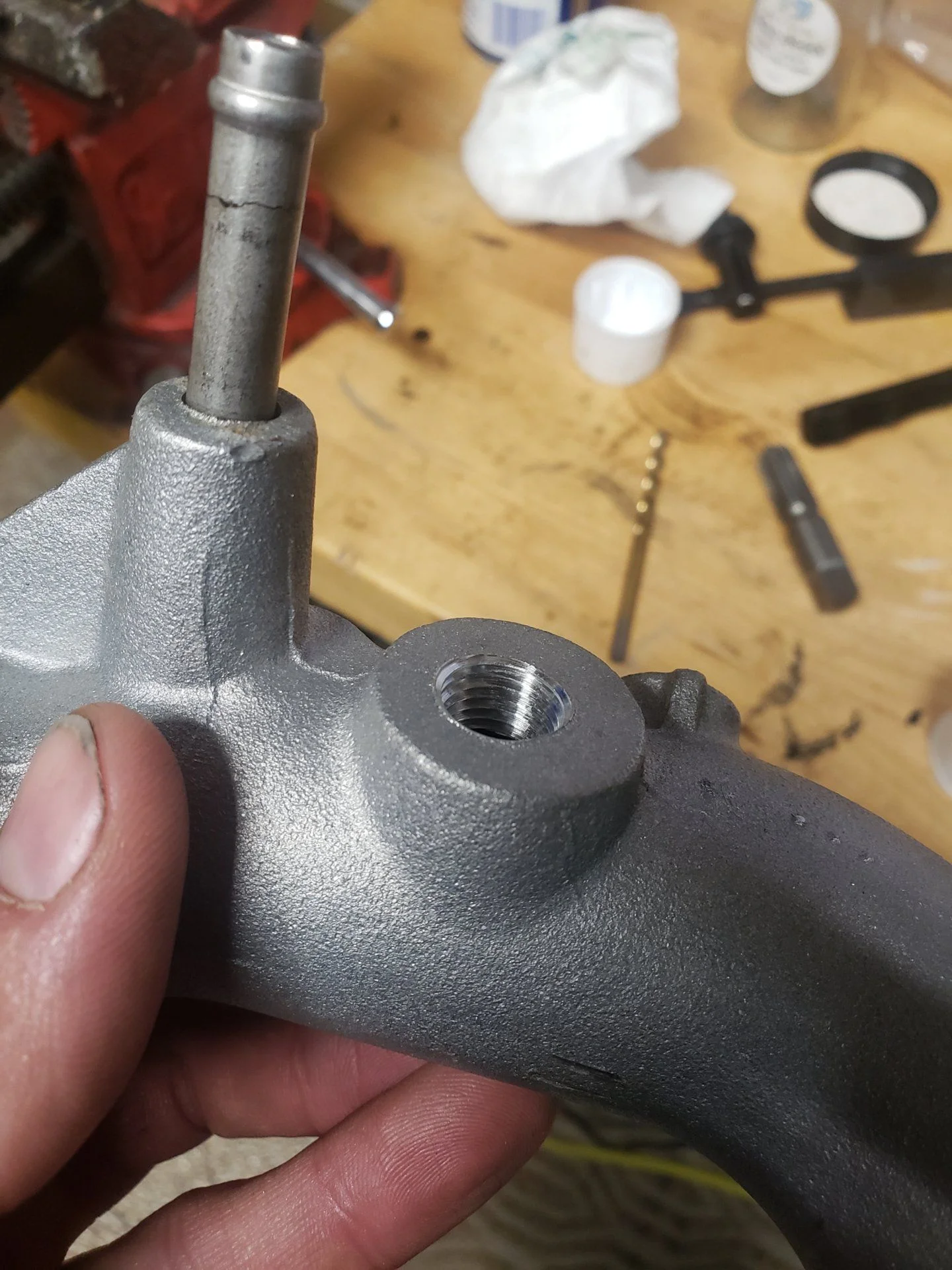

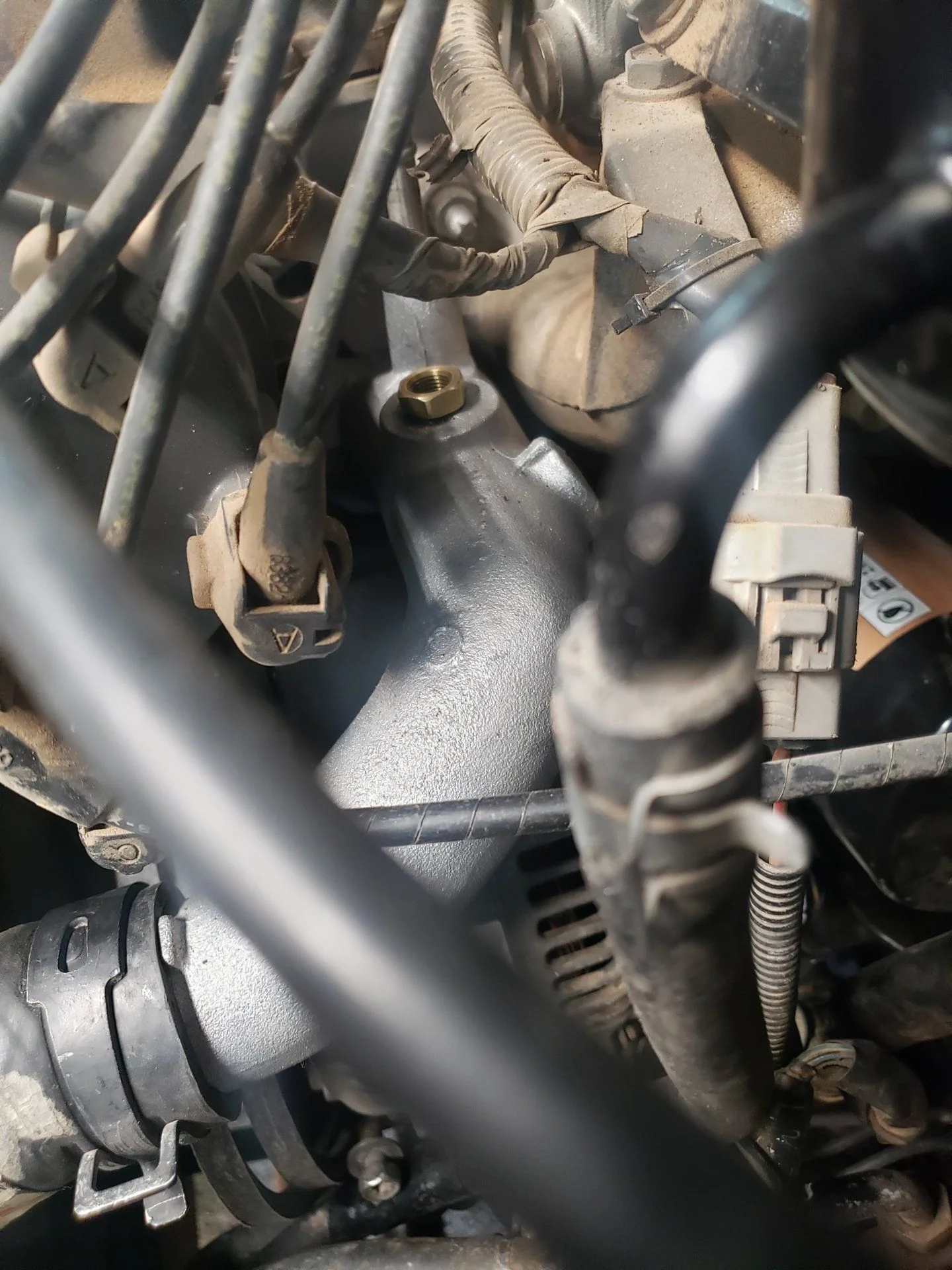

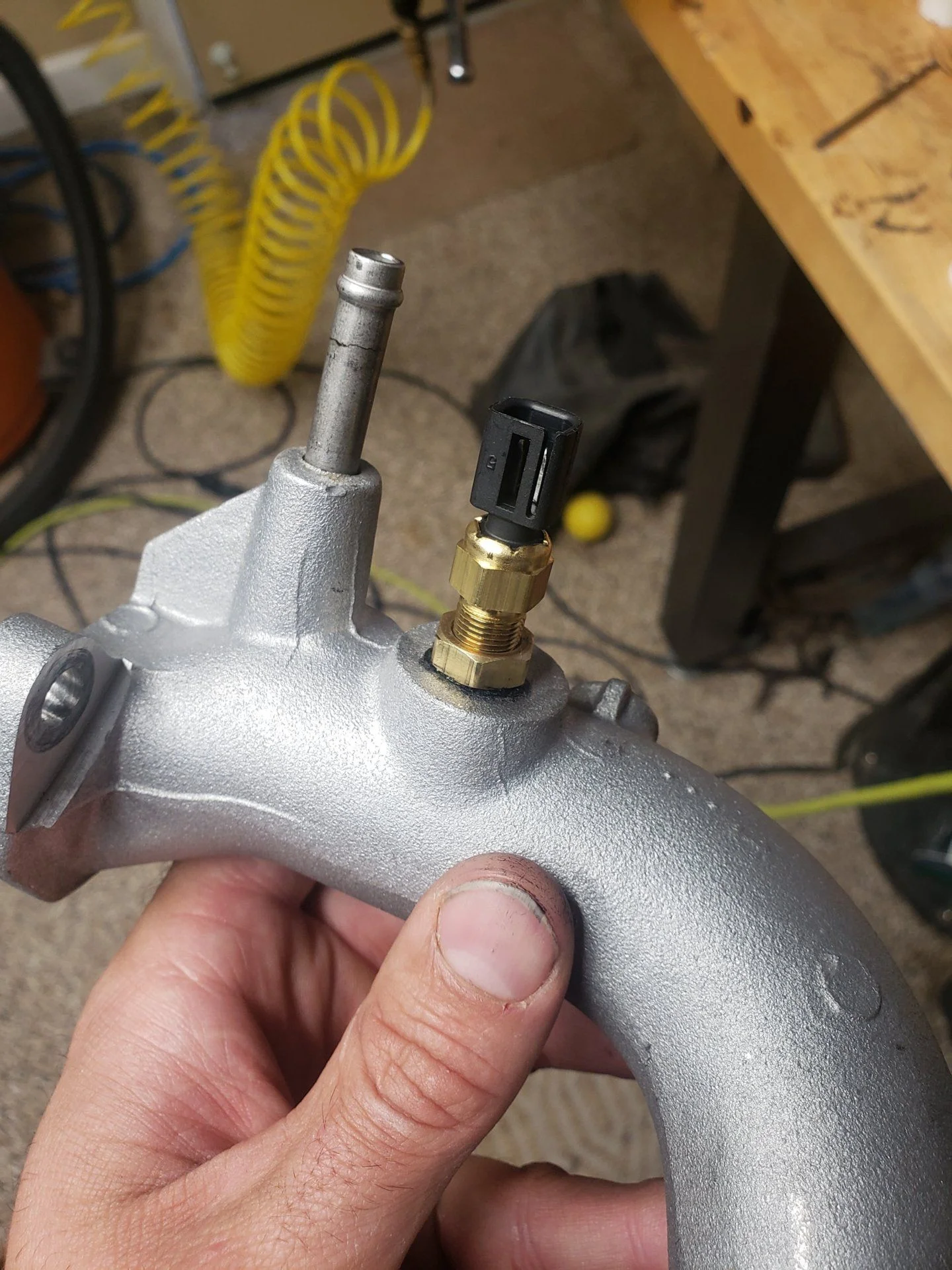

I went back and forth on where to mount the water temp sensor, I wasn't a big fan of cutting the hose and putting in one of those adapters. After looking around a bit I came across a spot on the upper hose tube that bolts to the block. It looked like it was begging to be drilled and tapped, so that will be my project in the morning. I'll be sure to post an after pic of the install. I attached a few pics showing the location, looks like a perfect spot for a temp sensor. It's a little painful pulling the tube, I removed the alternator, then the alt. mount bracket to access the two bolts that hold it to the head. It would be a great time to replace the coolant tube and gasket if you have heavy corrosion. I had replaced it roughly 5k miles prior during HG job, it was in bad shape.
I'll be sure to post a follow up once all the gauges/sensors are installed.
