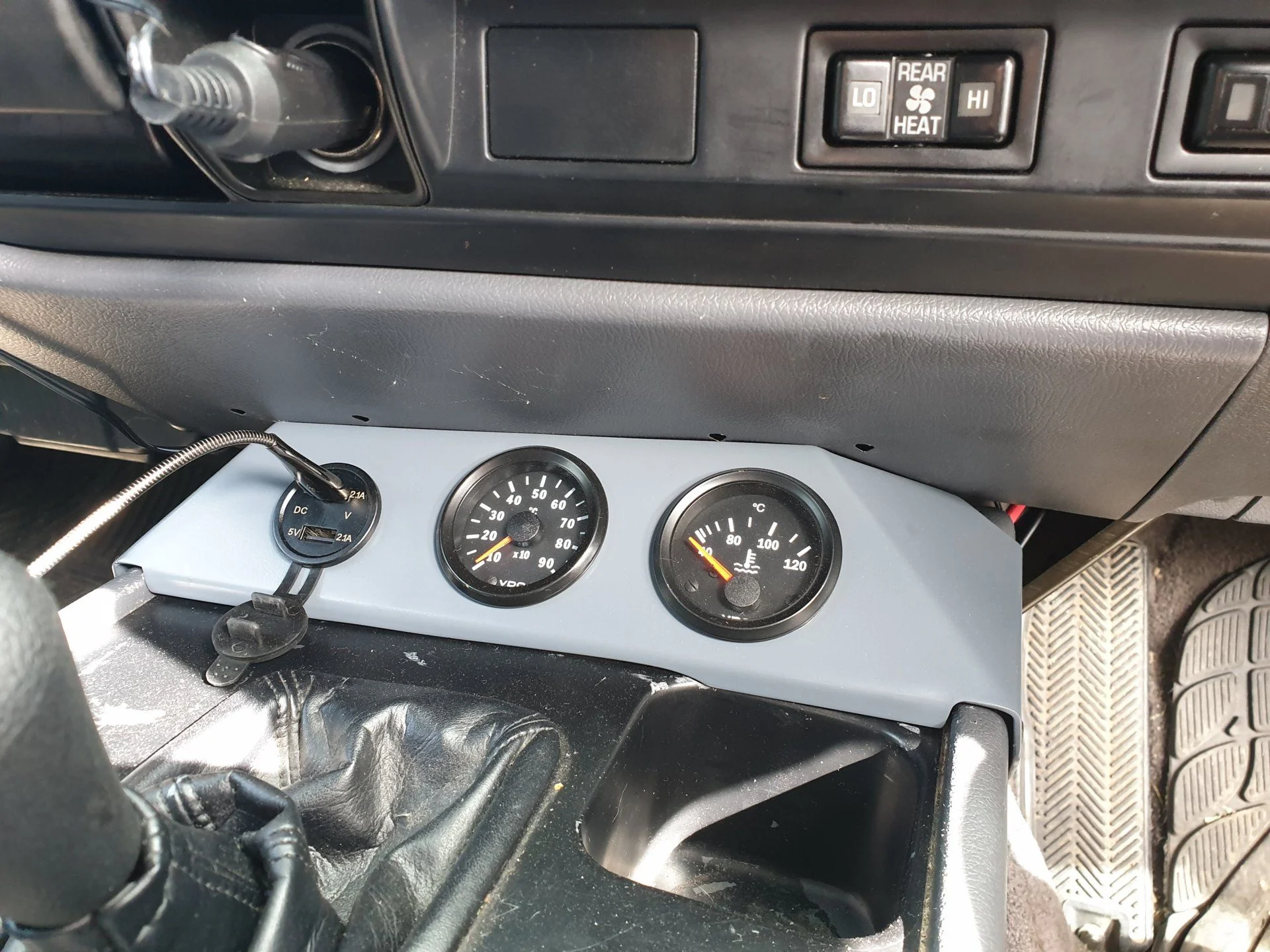

VDO EGT and transmission temp gauges plus a 2 port USB with voltmeter DRO. The paint match is closer in real life, the photo makes it look much lighter than it is.

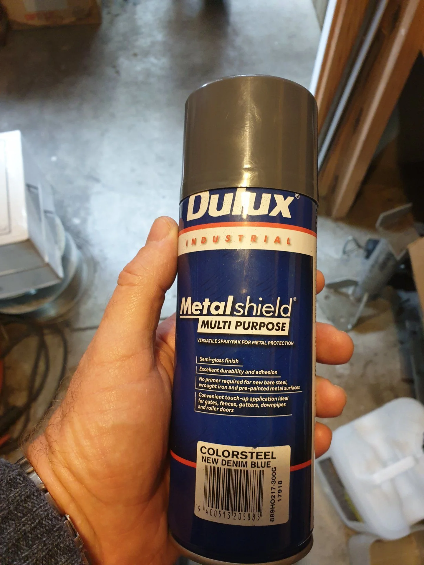

Nice! What paint did you use?

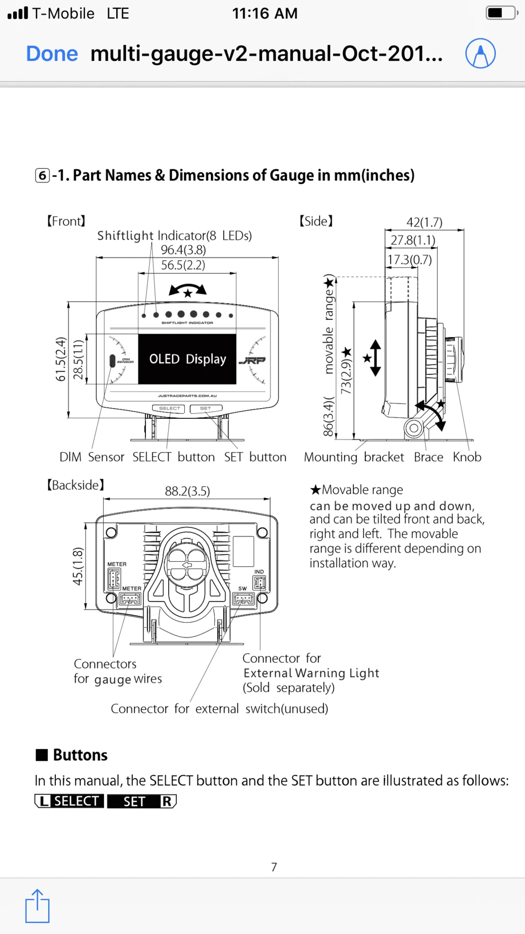

Does anyone have the overhead aux/compass unit? Can you measure the opening like this for me?
Wondering if i could mod a 14-1 sending unit and program a new screen in an opening the size of it.
52mm high and 200mm at widest and 190mm wide at bottom cause it’s not a rectangle. My Innovate AFR gauge body measures 50mm wide but I’m mounting it on the pillar.

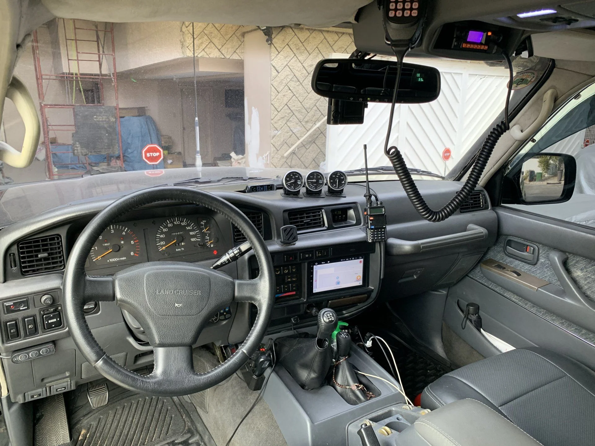

I’m running Defi Advance RS gauges. I like them because I only have to run one cable to the gauges from the control unit, and daisy chain the others. All the sensors go directly to the control unit and tucked out of sight. Aso has a button to show peak, and can set visual and audible alarms. Currently have them mounted on the dash because there’s nowhere else to put them. Doesn’t really block outward view (unless you prefer to see the hood instead of the gauges). Thinking of maybe trying out a pillar mount

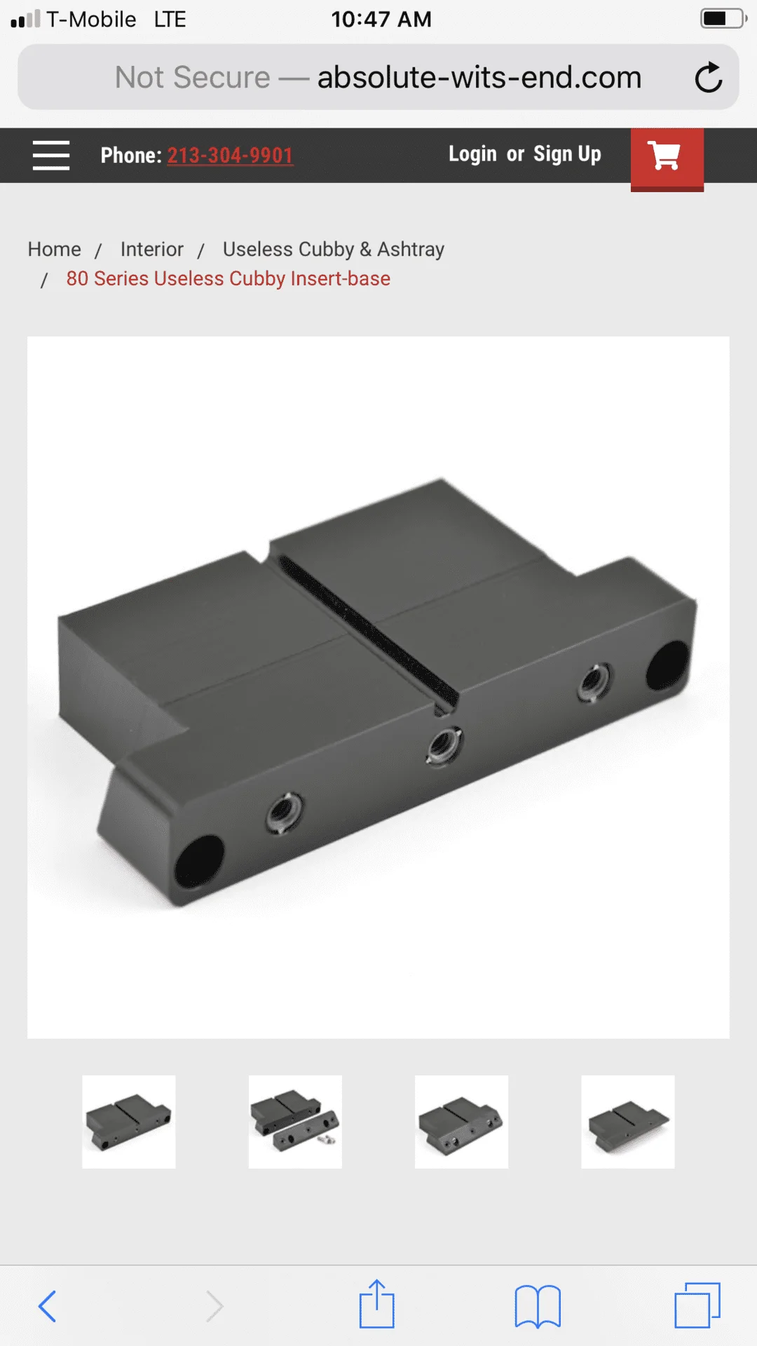

So ball with a 1/4-20 male stud would screw into the Wits End dash piece.
I’ll need to see if there is a threaded insert on the gauge. I’m guessing not, as it would go into the body of the gauge & take up space.

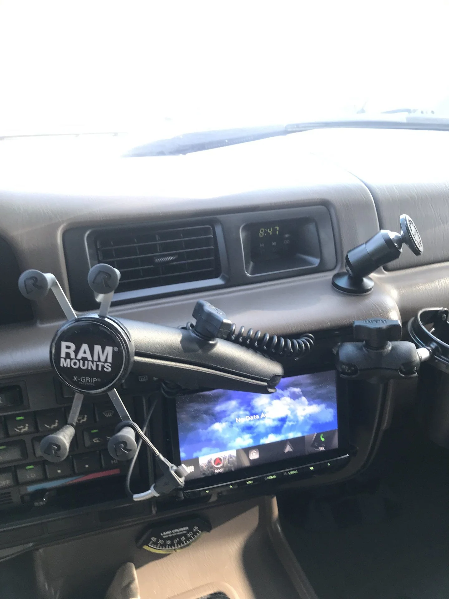

I’m using the RAM mount and Wit's End cup holder insert with a ProClip cell phone mount. I'll take a photo this weekend. You can also use adhesive to attach a ball mount to the back of the gauge. And then there's a variety of "arms" that go between the ball mounts depending on reach and angle that you want/need.
Here is my setup using the cubby mount and ram products to hold my phone. If the gauge doesn’t have space for a threaded 1” ball to be affixed to it, you could probably use the exact setup I have. The ram phone holder is spring loaded for a friction fit. They also offer 2 holder sizes, the one in the picture is the smaller one. If that doesn’t suit your aesthetic, you could apply a thin metal plate via double sided tape to the back of your gauge and a magnetic ram mount with 1” ball in place of the spring mount. The plates are sold separately for phones to use magnetic mounts. All of these products can be had on Amazon.
RAM arms are pretty big, but you don’t really notice it behind a cell phone.
