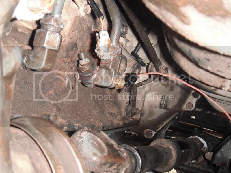

This is how wholesale crappy matics do it.
Please excuse thier dodgy work (swine's broke the factory temp sender pulling my trans)
You could remove the fitting off the trans & drill through from the inside, Use a larger drill to counter sink & line up the fitting in a drill press, Then drill through with the correct size drill.
Hamo
Tried to do it that way... but the inner elbow is convex and and your bit will "walk" unless you have a precision press and just the right tools to center - i.e. your own machine shop. So, giv'er!
Edit: You also need to ensure the sender is spaced out an exact amount - like in your pic, so that it doen's restrict flow. VDO senders barely work, but any longer and no bueno.

back in the day what I did .. in order to keep the factory sender / light and aftermaket gauge ..
main.php
My Bad - M14 x 10.5
This is what you need:
