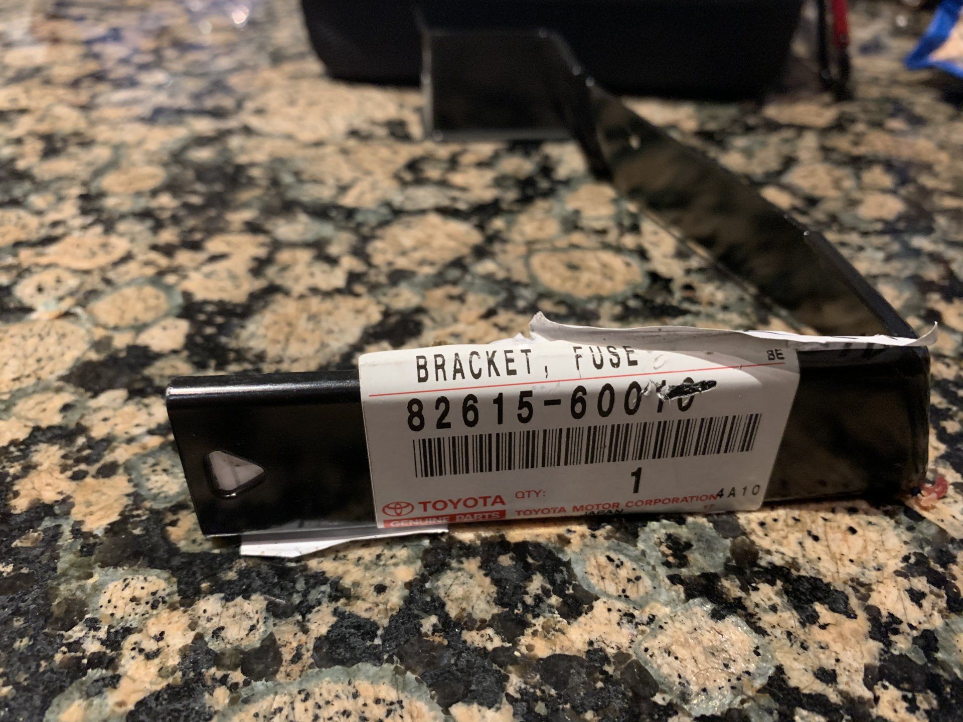

I can’t find this part number to save my life, any ideas?

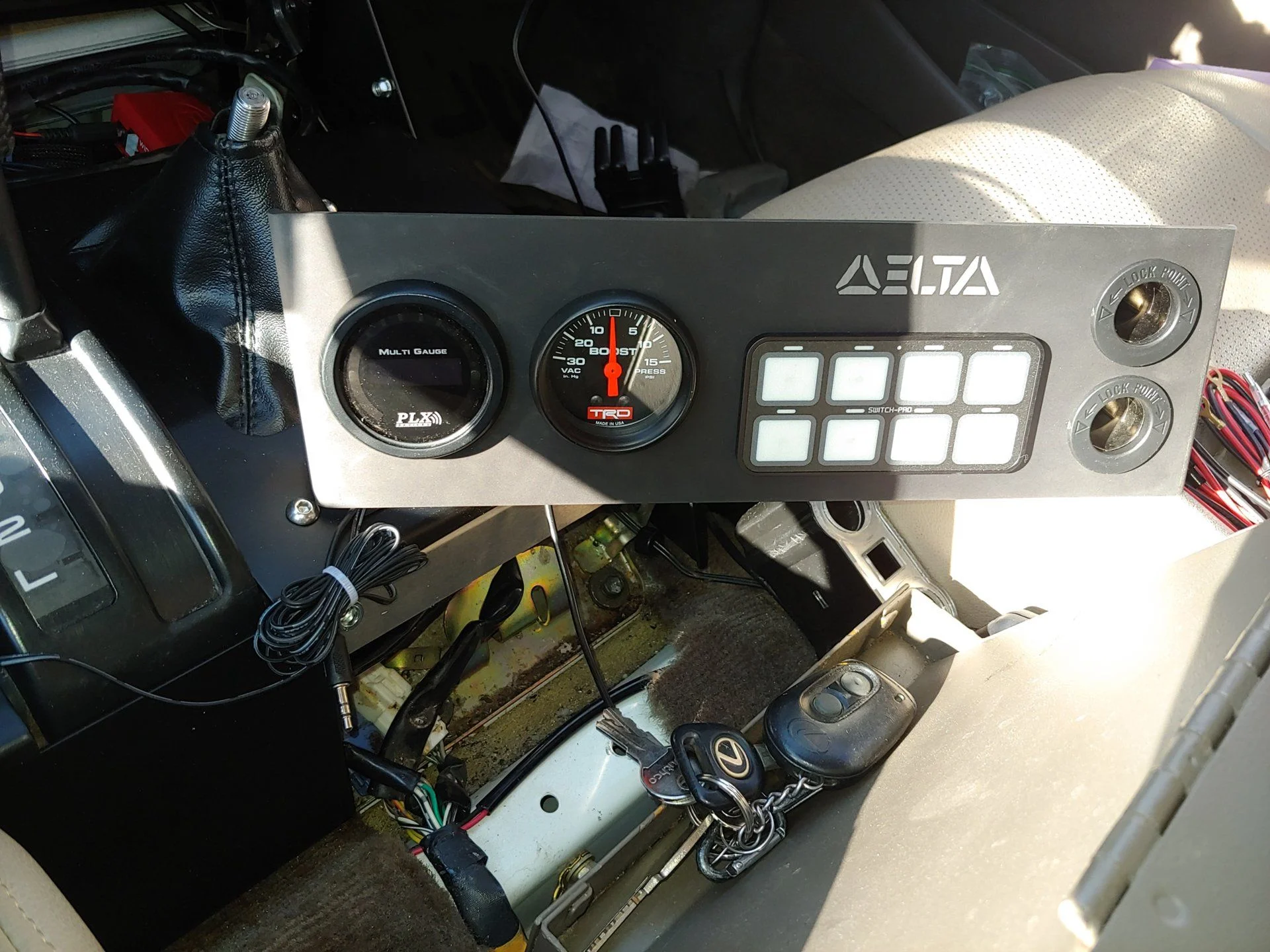

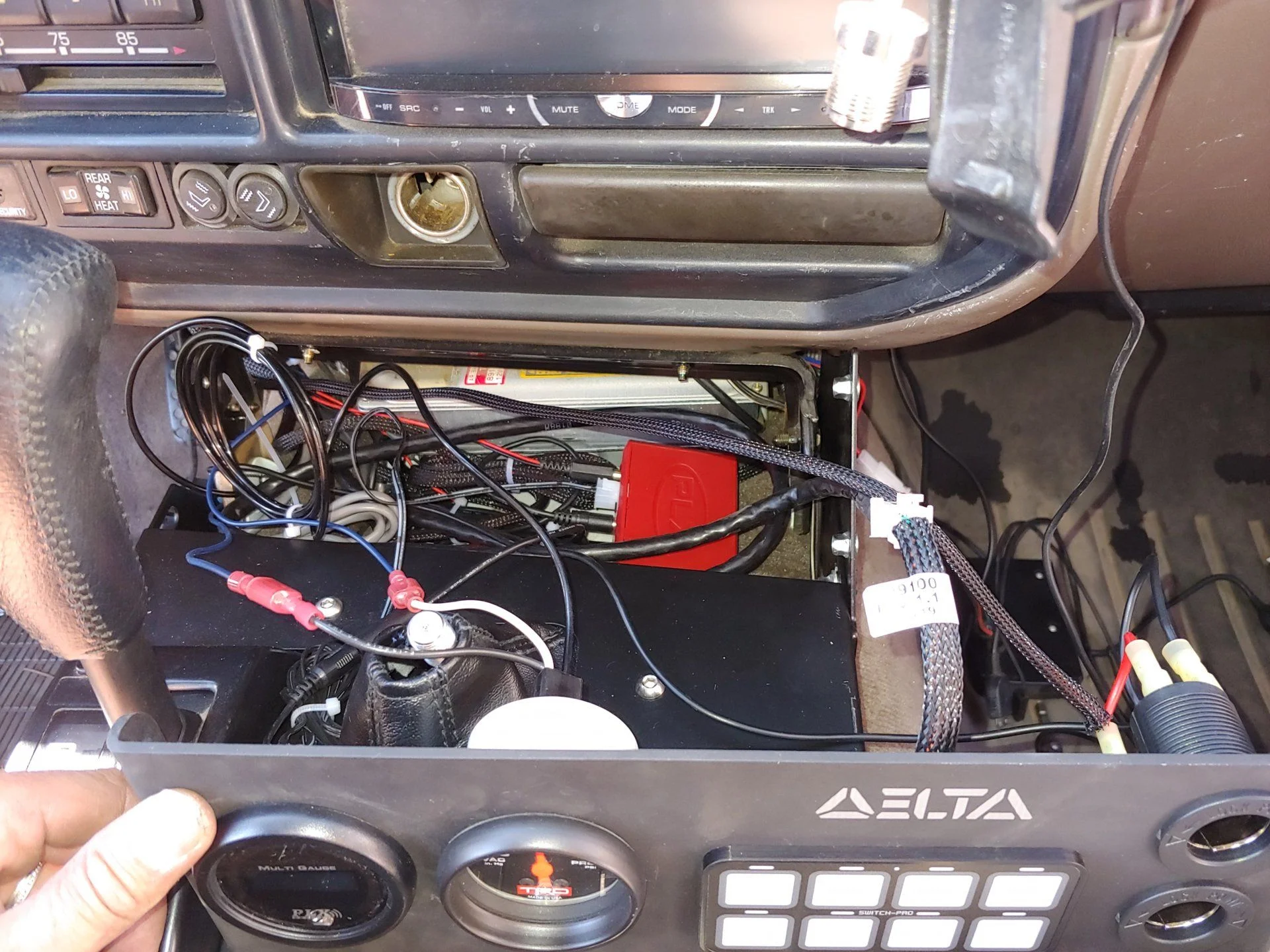

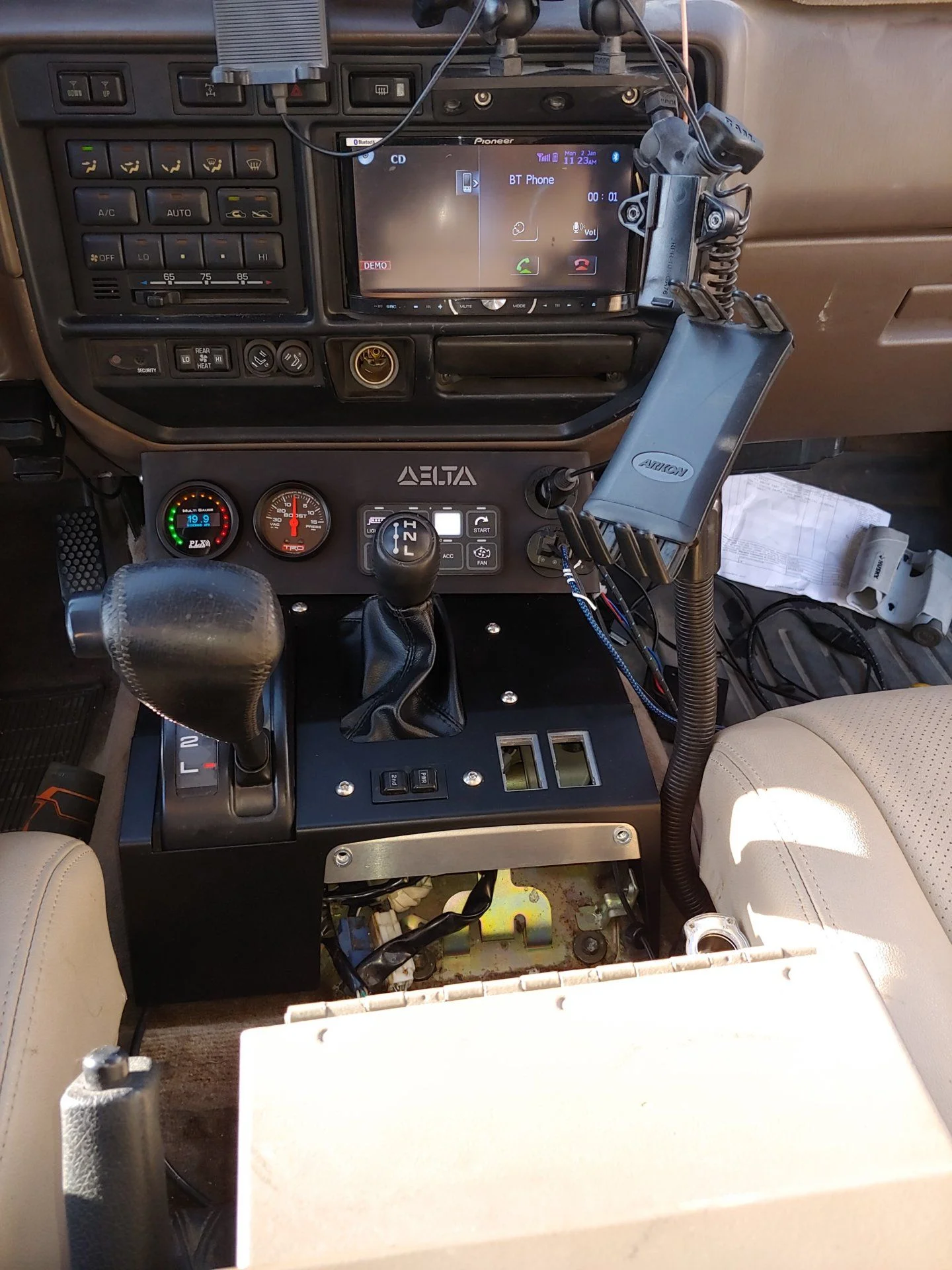

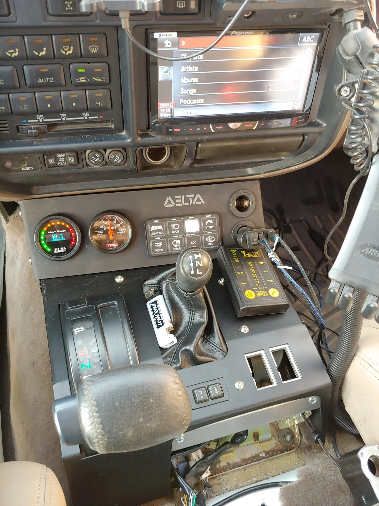

Delta shifter console, Switch Pro 9100, Plx Gauges, TRD OEM Boost gauge, Tmax Dual Batt and 12v wiring. Need to cleanup my Wits End Useless cubby but she's almost complete.
Had to remove my TUFFY cup holder for now. Still waiting on my @Delta VS center console to finish the interior.

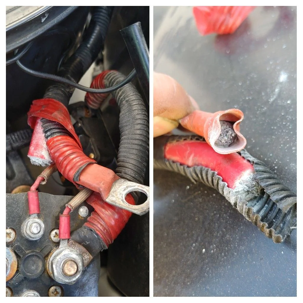

Been having trouble with my dual batt not charging for months now. It also consistently clicked on and off repeatedly.
I thought my rewire after the rebuild was wrong or my batt was dead or my isolator died. I threw it on the trickle charger and it took a charger fine. Only problem is when the isolator linked the 2 batts didn't actually link an charge my 2nd batt. When linked it evens out the voltage.
I took out my power probe and started diagnosing. Turned out the higher alt voltage wasnt making it from 1 lead from isolator to aux batt positive. I took out the aux cable positive wire. Batt side came off fine. As soon as i touched the isolator end it broke apart and disintegrated.
I usually use solid copper wire but I ran out when I put my system together. So I used some copper clad stuff i had laying around. Note to self. Never use that copper cladded crap ever again. It's as good as garbage.

Whoa!...note to others, never use copper cladding no matter how much cheaper it is.

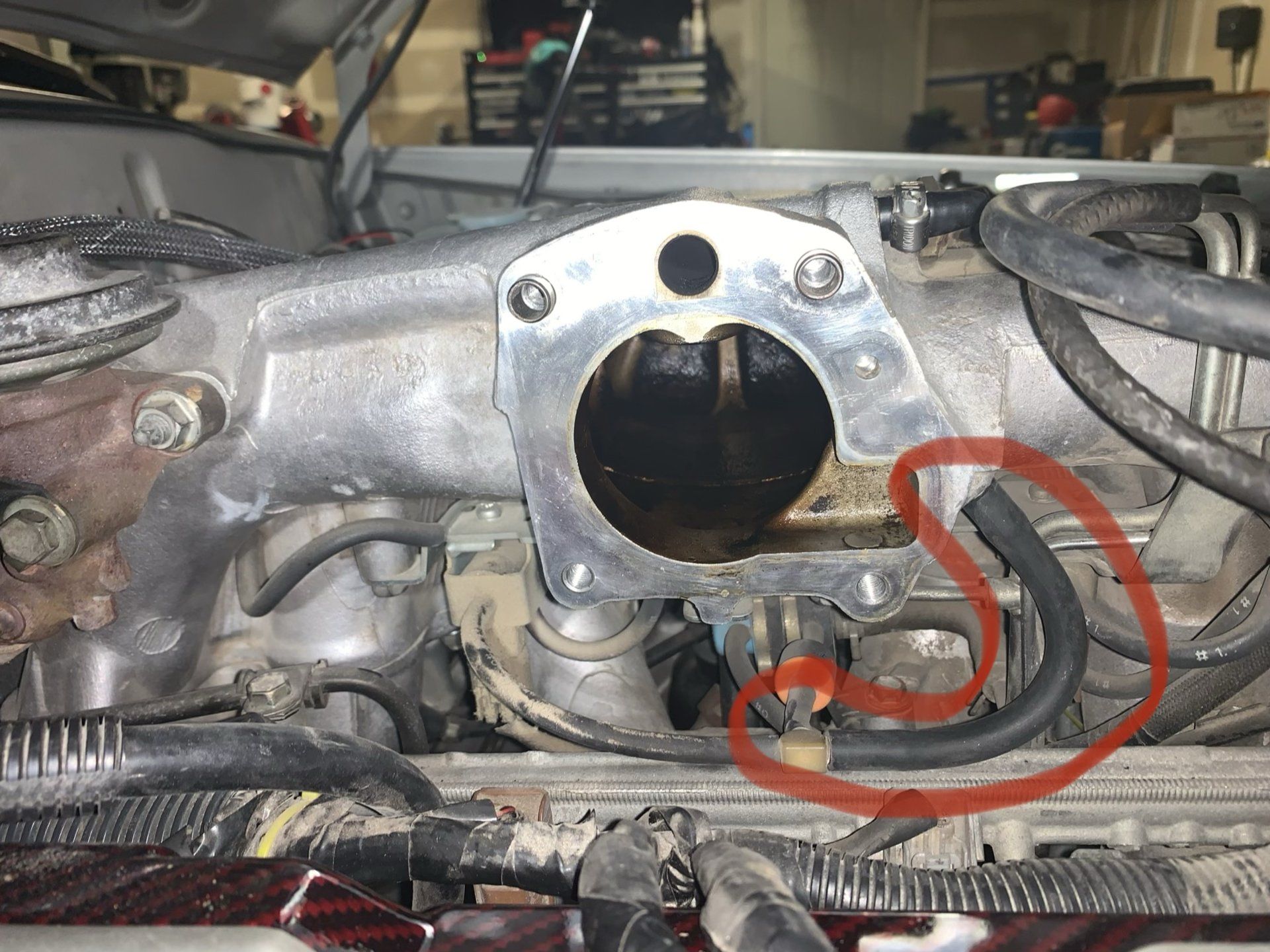

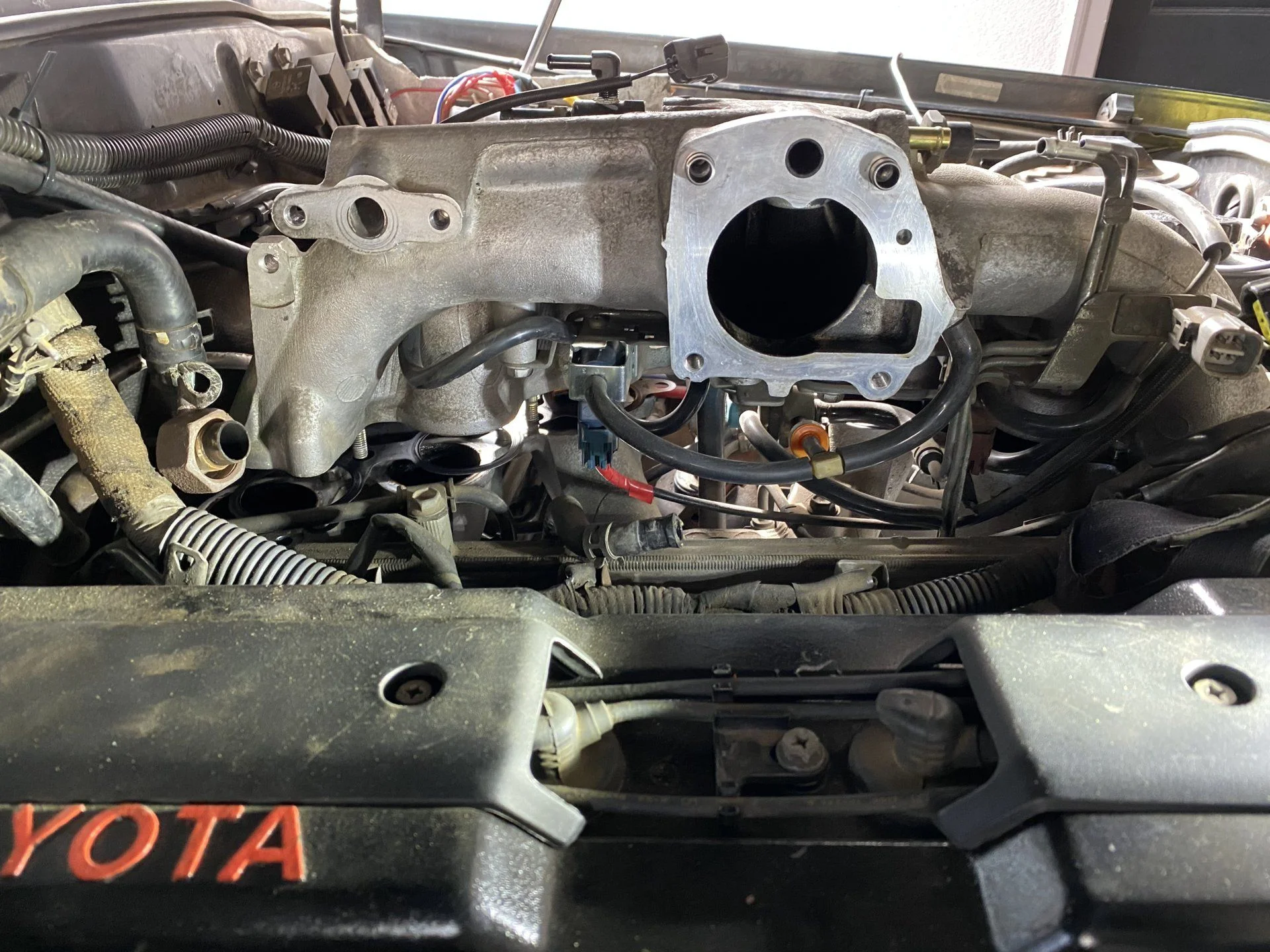

Since I have removed my Supercharger, I have a few extra steps to get the turbo installed. Before I put the throttle body back onto the intake, I want to make sure I get this vacuum line correct. In a SC setup, this port on the intake is blocked off. Would you mind looking at your vacuum plumbing to see if the T under the intake is running up to this intake port?
