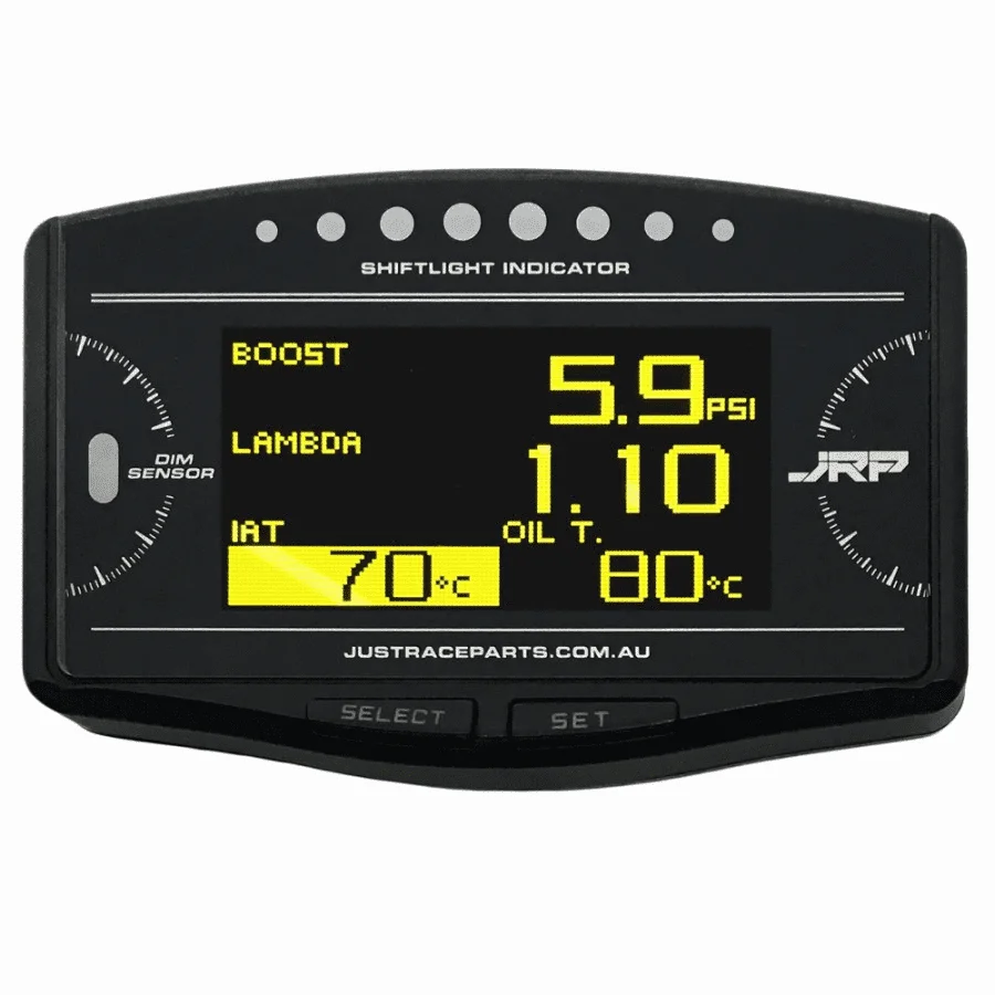

14 in 1 gauge display

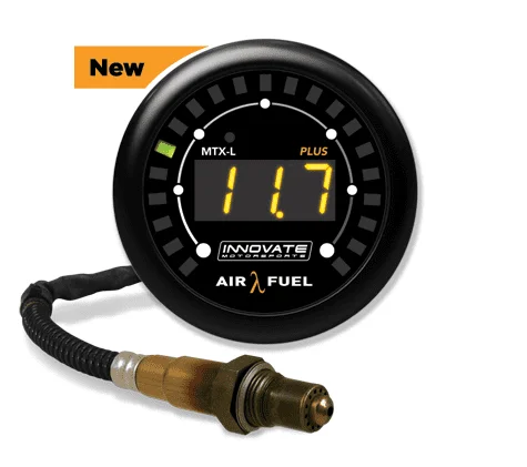

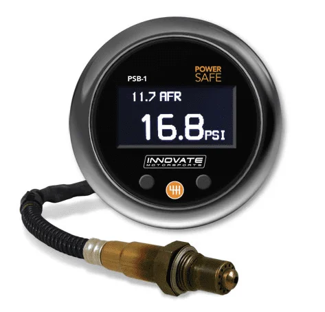

I'm looking at the combination innovate gauges like these:
I've run this wideband (innovate MTX-L) in multiple cars. They're bomb proof, easy to log AFRs to an excel sheet and use a GM sensor i believe that's easy to replace at the local auto parts shop
Trying to find some of the older PLXs as well. I recall they had digital faced gauges that could display up to 4 sensor read outs.
Hoping to run AFR/Boost on one of those innovates and everything else on a PLX.

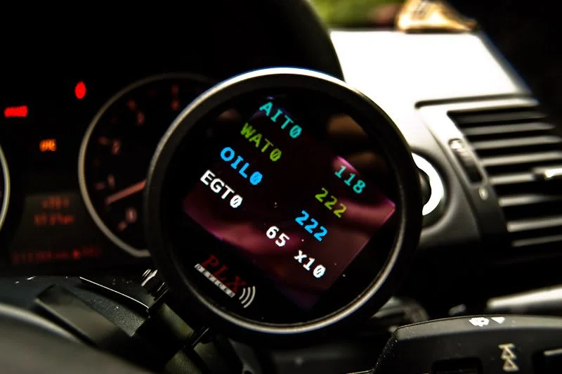

The closest one I could find was the PLX DM200. This look familiar? This would not be a bad solution. Just need to make sure it has the correct read outs that we are looking for as well as it being easy to read, regardless of it that is on or off the tarmac.
That looks more familiar for sure! with that and the combo afr/boost could be pretty well covered with 2 gauges.

That 14 in 1 from justraceparts looks pretty cool. Not overly pricey.
Yeah the form factor is not my favorite though and not sure about quality of the unit though haven't looked at reviews. Not sure where you'd place something that large.

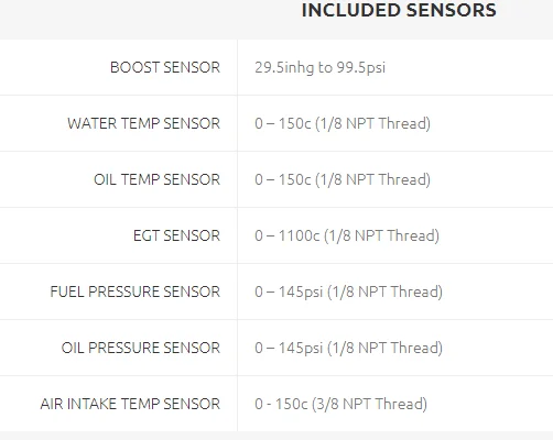

That's just the screen for that price. you need the base system and sensors that are sold separately.

I'm thinking the same + the innovate wideband & boost gauge. Though a LOT of PLX stuff is out of stock right now. Looks like they had a big sale.

Make sure you realize that's just the screen for that price. you need the base system and sensors that are sold separately.

14 n 1 is about the size of an ultra gauge?
$75 for the display
$150 for base unit with most of the needed sensors
$150 for AFR sensor
$75 for the display
$150 for AFR sensor
Vs
$260 for DM200
Plus $170 for AFR sensor
Plus other sensors

I'm mostly on the hunt for a clean, minimalist install. The dm200 unfortunately is a larger diameter than most A pillar mounts will take.

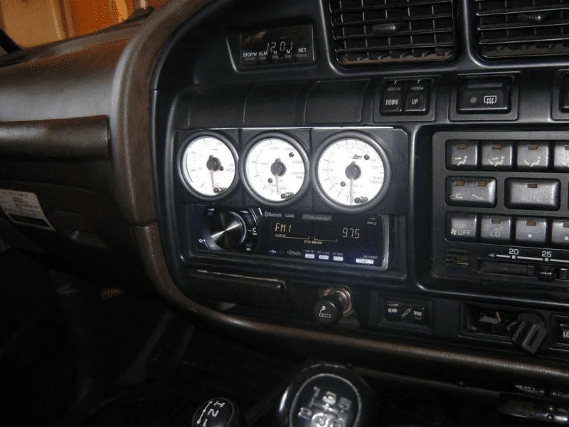

Another idea I was toying with, though it's a bit low and forces use of a single DIN stereo:
1949768
(photo found via google, from someone on 'Mud).
