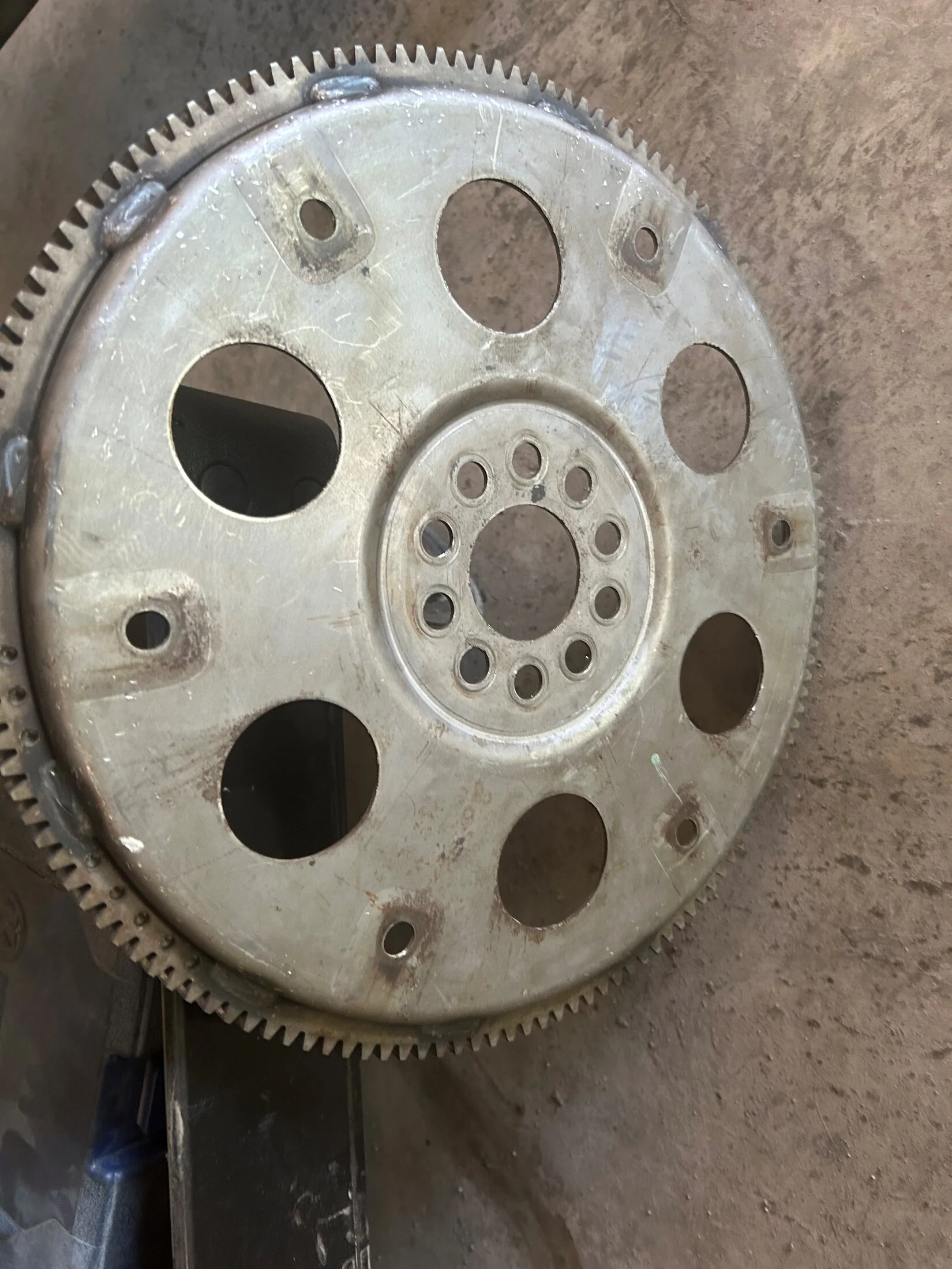

The working theory following that discovery was that the Torque Converter was not fully seating into the pump and overtime it just completely lost engagement and thus no fluid was moving and no drive. My thought was that this could be due to missing flywheel spacers or a flywheel issue. I've just finished pulling the second transmission and it appears that the two flywheel spacers are indeed present so I'm at a loss as to what the issue could be. The flywheel does appear to be bowed out a little bit in the center compared to another one off the shelf. I have a pump and drive gear in route but I'd really like to know what caused this to happen a second time.

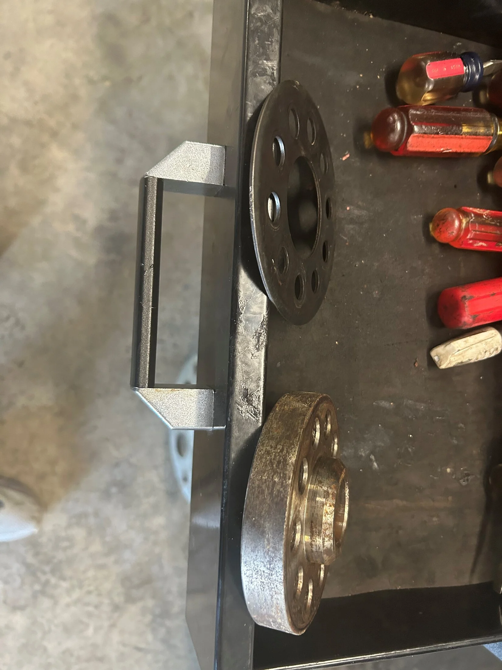

Can anyone confirm that the two spacers below are indeed the one's mentioned in the FSM?

Those are the only two that sandwich the flywheel to the crank.
Thanks. I thought it had to be, but the inner one doesn't look that big in the FSM.
Looks like you didn't have the converter installed correctly and it broke the pump gear you need to make sure it goes in twice .then measure the converter to the bell housing as shown in the FSM
I had a similar issue with this, accompanied by an unsolved gushing leak off the input shaft.
But the fsm’s recommendation of 15.7mm from bellhousing to TC mounting surface is incredibly incorrect. It should be seating in near 30mm +/-
