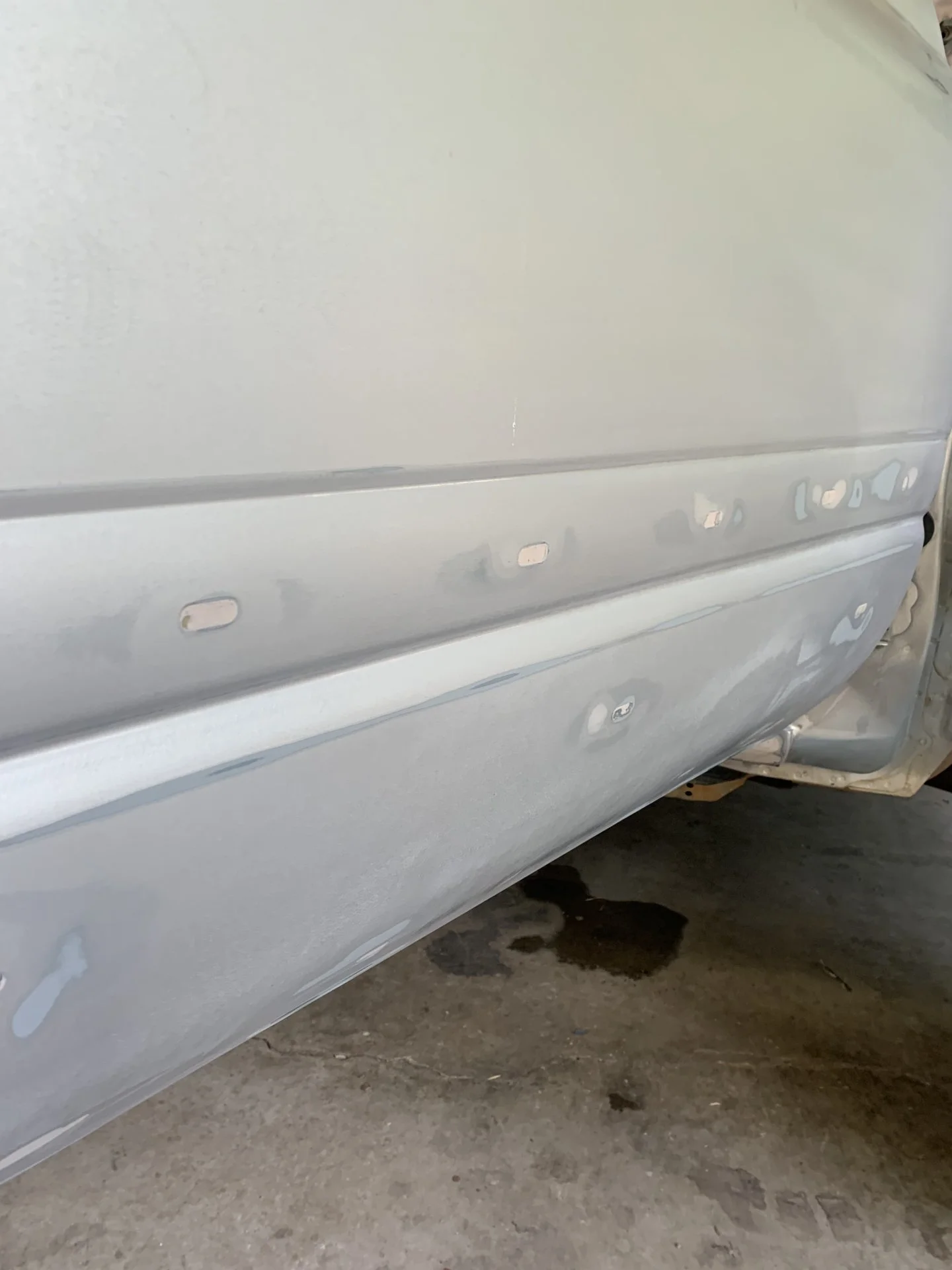

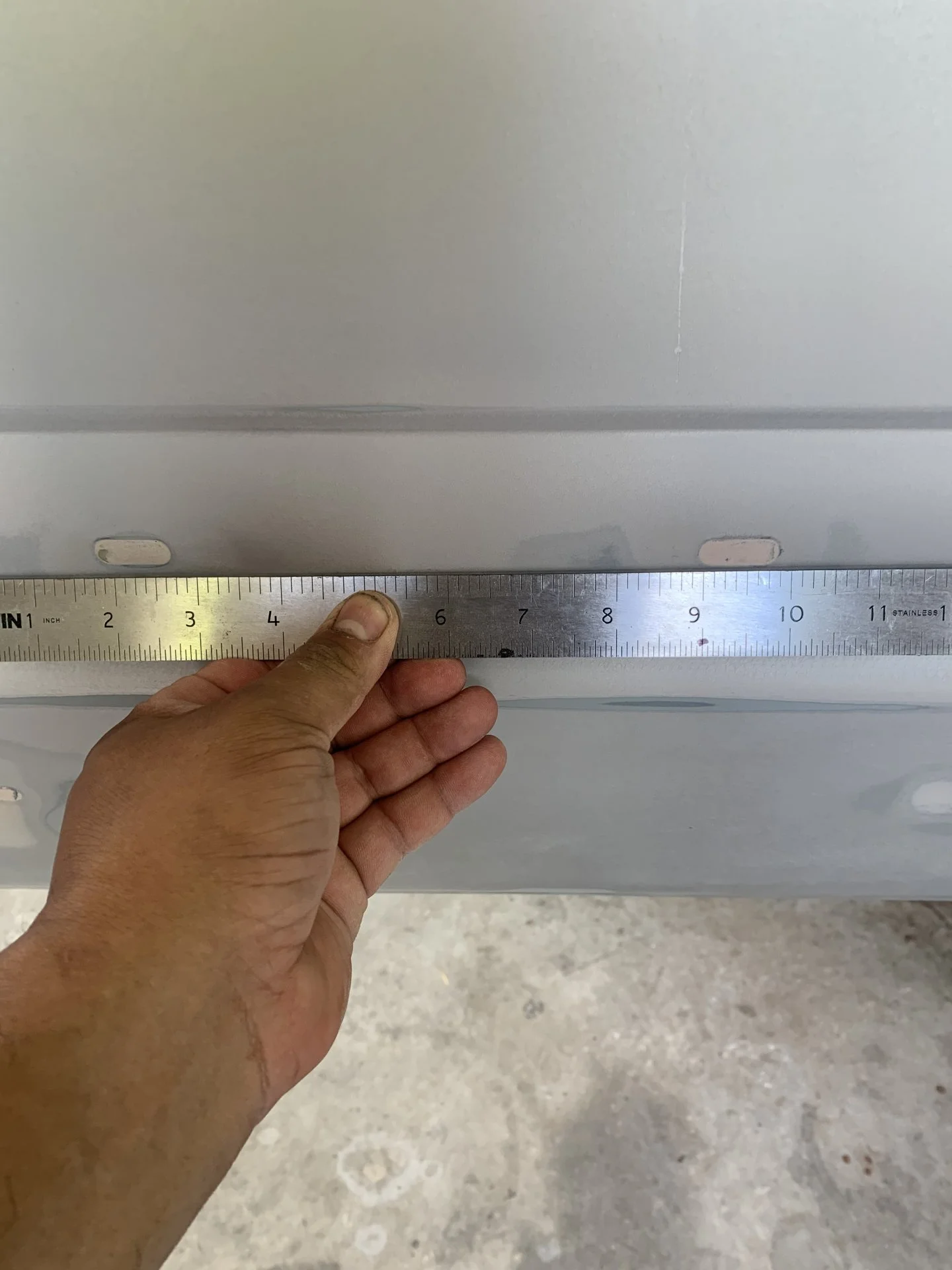

Over 100 holes. What a pain in the butt.

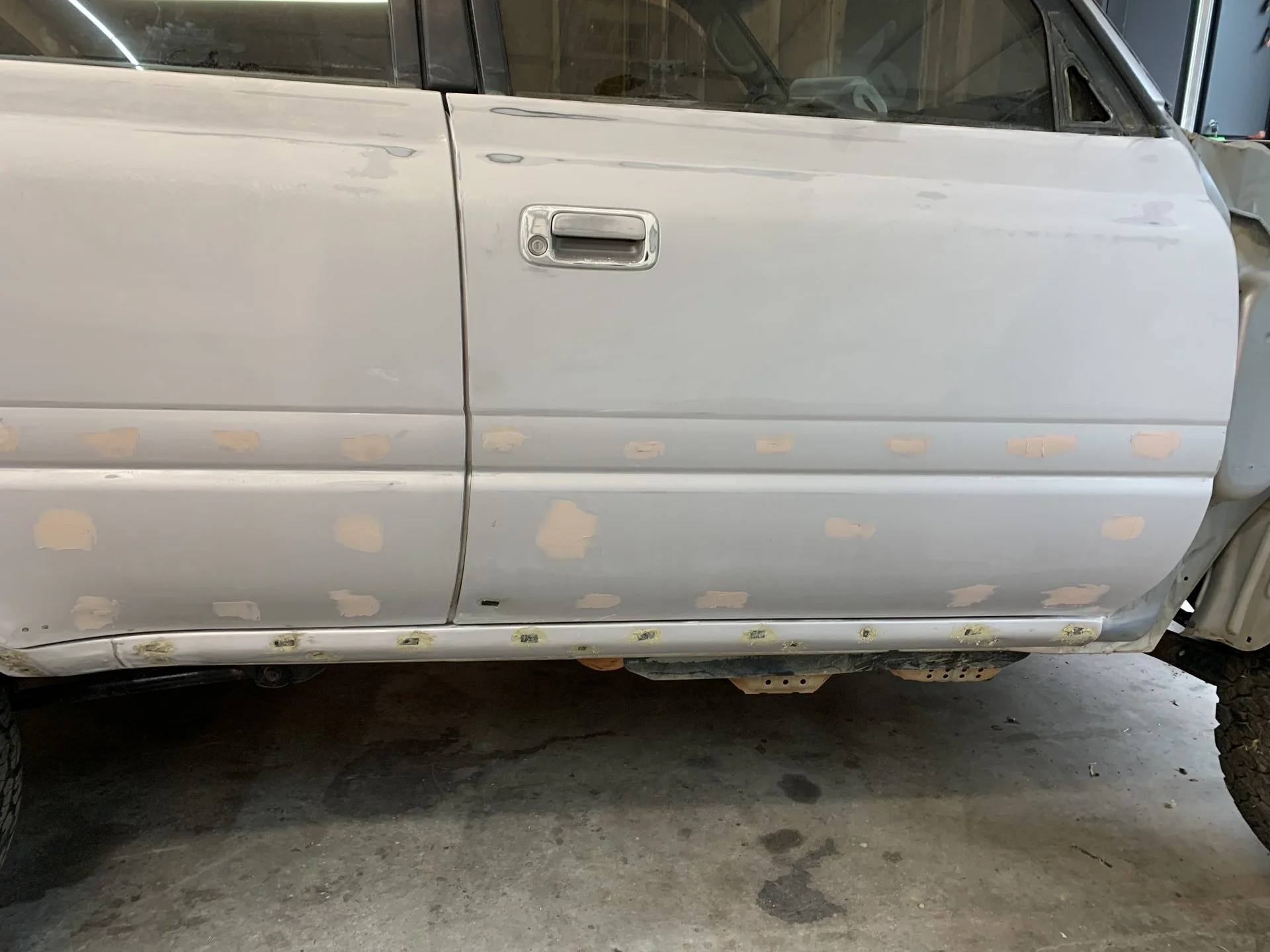

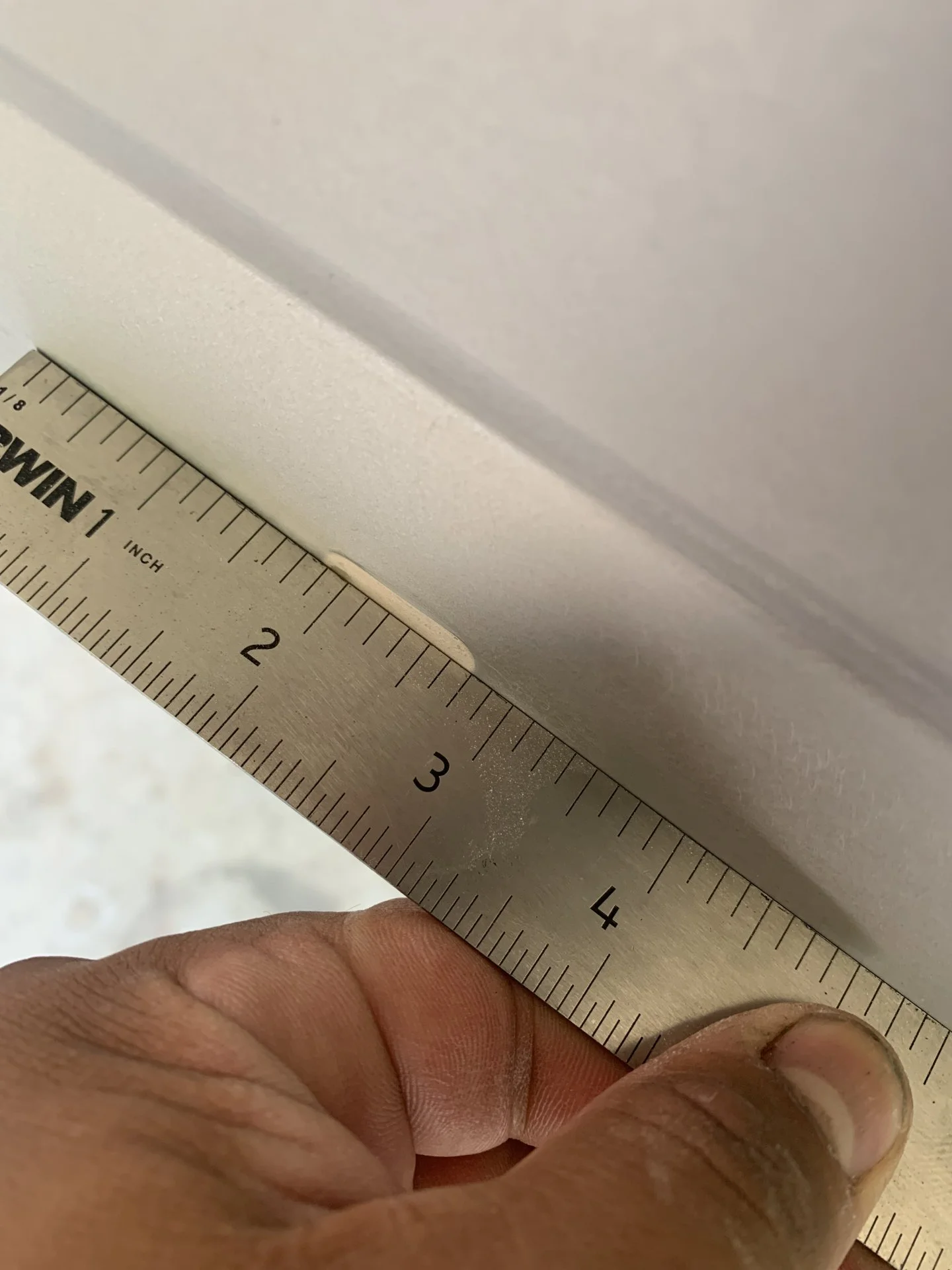

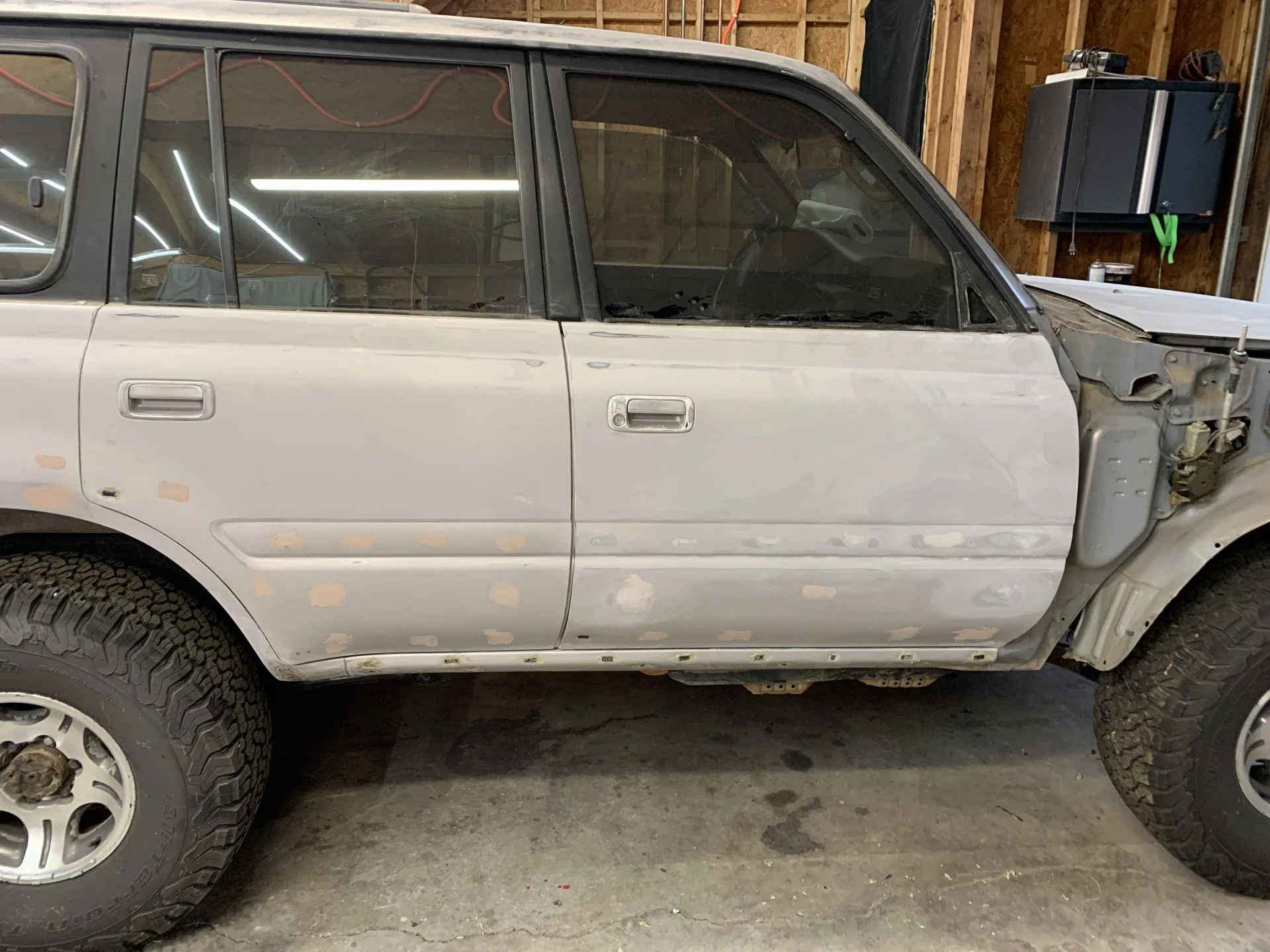

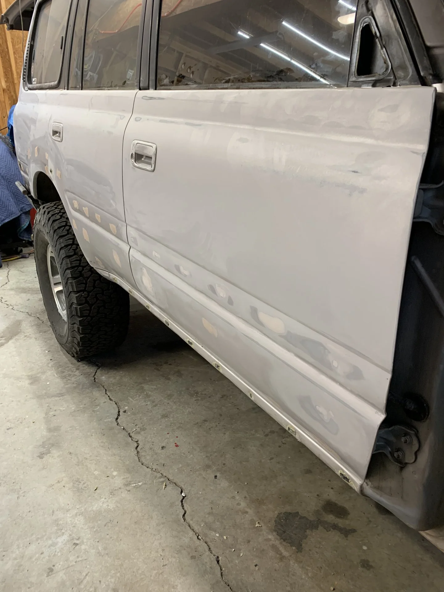

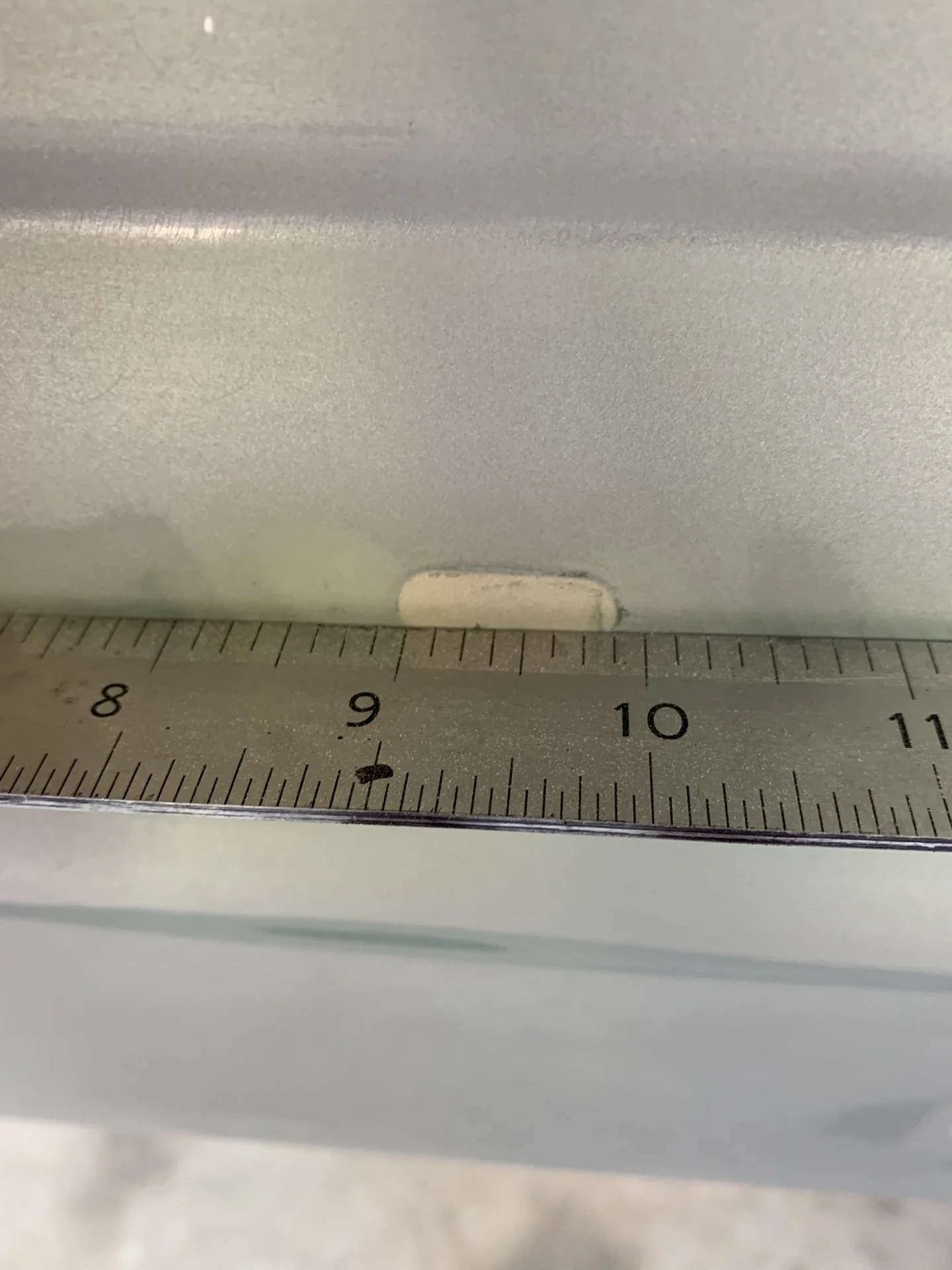

So far so good. The truck is sanded down all the way to 400. I’m sanding the bodywork right now.
I really want to start taping tonight but will see.
Looking good!! Sanding is the hard part of the prep and attention to detail makes the final product.
Yeah. Luckily the body is pretty straight I just have to deal with paint chips mostly and the body work where I patched the holes. But since I used epoxy there is zero warpage. I’m sure if I would have welded the holes up I would have to do way more body work.

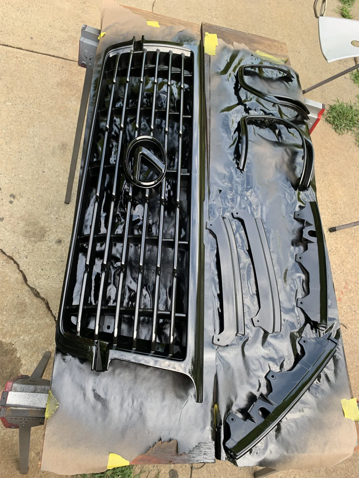

Taping has started. Trim is painted. Going to be a long night. Doing all seams and body tonight.
This will let the paint dry and I can start putting it together tomorrow.
I will do the roof once the paint is dry enough to tape over it. Then keep putting the truck together while the roof dries.
