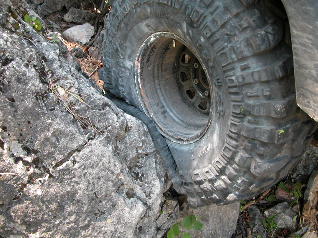

I run 35 12x15s on 10 rims on my FJ40. I run 8 pounds on the Rubicon and they definitely burp. They are also harder to turn due to a wider stance but I like the traction and would do it again.
I have 35s on a 10" wheel (BFG 35X12.50). I normally air down to 7 to 10 lbs. Have only chirped a little bit of air out of a tire on a sharp rock that pushed in the side wall. It would have happened to any size wheel. It all depends on the tire when it comes down to it.
Doubtful...
:lol:
got me there
Wow, how much you got it there? :eek:
Those are 38.5x14.50x15 Swamper SX's on 15x10 steel wheels...
Probably had 8psi in them at the time.
It was parked there, unbeknownst to the owner, for over ten minutes while the vehicles in front on the trail ride in the Black Hills got a vehicle moving that was stuck on the trail.
:meh:
