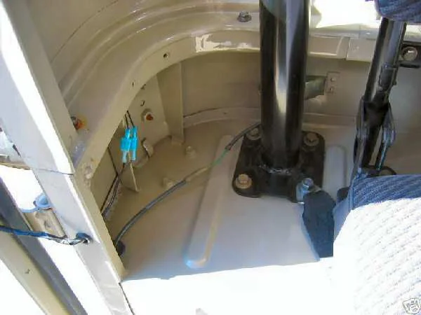

Does anyone have pictures of where the rear side marker light harness enters the tub on the inside? Specifically 79 ish. Both sides please.
THanks
same on 79-82 that I've seen, wire goes up vertically above the taillights thru a rubber bushing to the side light.
Yeah, that is what am tying to figure out. I replaced the tub, I don't have access to the old one, and I am trying to figure out were the wiring harness comes trough the wheel well. The tub I have as 3 holes, none of which are large enough for the grommet attached to the harness. Before I make one bigger I'd like to know approximately where I should drill.
Here is a pic of a 1977. Should be the same...
