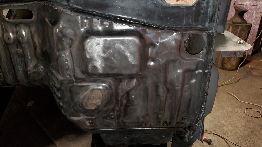

prepping the firewall for self etch primer (2 coats) and then high build primer (3-4 light coats)...
i.php
i.php
i figure the firewall is a good place to learn spray painting 2pack for the first time. there wont be much block work needed here prior to the cyngus white and it will allow me to build and mount the drivetrain for the last time..
oh dang. Did they change the firewall stamping at some point? Mine does not look like that. And I am not talking about how his steering is on the wrong side.
