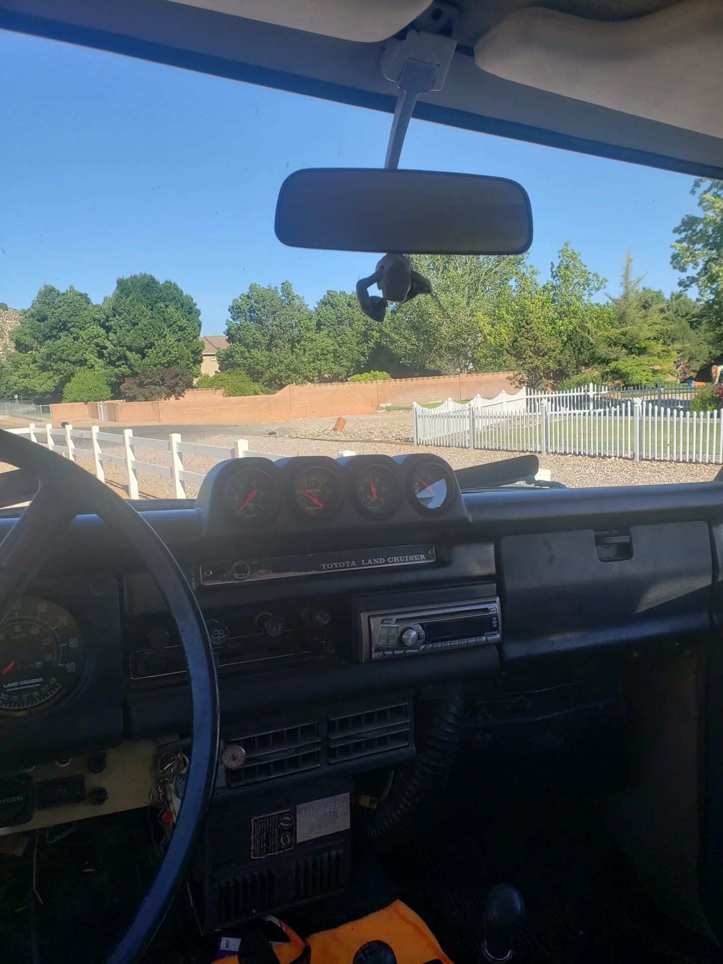

And this idea to fit 4 x 52mm gauges to replace the factory dash pod:
i.php
i.php
Looking at these gauges..
