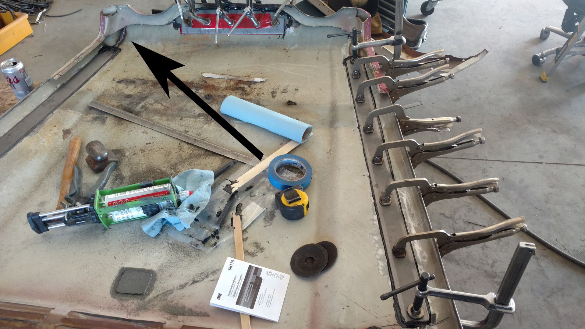

This may give you a few ideas that could be useful.
On this hood I used a thin strip of steel to double the seam at the glue joint and welded the ends (see arrow). Not shown in this picture is a thicker strip of steel on the bottom side wrapped in tape to prevent it from being glued to the hood but help hold everything flat.
After the glue has set a quick sanding and the seam is ready for a skim coat of filler and primer.
This hood has a hard life on the front of my buggy and it's still holding strong.
Would you suggest I do something similar with a backing strip? It's not something I've considered figuring the current setup would be adequate..
I don’t know that there is a “right” or “wrong” way to do it but the advantage of gluing for me is the speed of making the joint and minimal work required to get back to paint, making the lap joint on the long straight sections accomplishes both for me. Adding the flat strip is fast and easy but you could also “flange” one side and do the same thing. Google flange tool or homemade flange tool to see what I’m talking about if you’re not familiar with flanging the panel.
My only concern with all the spot welds is you might actually be compromising the glue and ultimately end up with a weaker joint.
