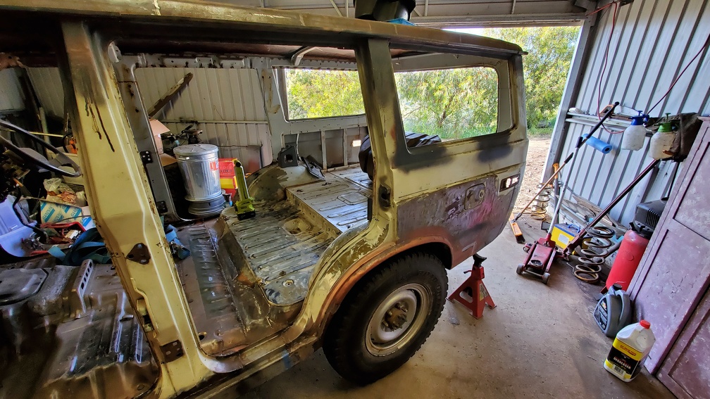

Finished welding out the 2nd row floor..
i.php
i.php
With that welded out I've wire wheeled and primed the underside ready to seam seal and coat with sound deadener.

Yep thats where im headed. I'm finishing of the floor welding (floor to B pillar tie ins) before seam sealing.
i.php
i.php
Trying to avoid laying down seam sealer then have the heat from welding mess it up.

Just one more mod before paint! I want to weld in captured bolts to the underside of the rear cargo area so i can bolt down a frame for fridge slide and the like. I looked at the 80 this evening and its got tiedown loops so will likely grab them and combine the two.. weld some nuts to 3mm spreader plate (say 50mmx50mm?), spot weld that under the floor and we're done.
Last night I fabbed the plates with the welded nuts to put under the floor. There is a tiedown hook from the 80 and a welded nut. I also got to seam seal most of the floor.. there are still some areas that need to be hit with a caulk gun of seam sealer but for the hard to reach stuff its all done. Then I hit it with a single coat of spray on sound deadener. I think the texture is ok and it came up good. I only have a 1LT and I probably used about 75% of that. I need to get some more to apply after I've done all the fuel tank mount welding to the body.
