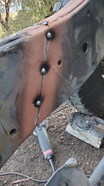

Wheelbase is now 2710mm (stock is 2700mm) .. measures F &R coil towers lengthwise and diaganol and they match up, straight edge along the underside of the chassis rail.. jig position confirms 140mm shortening on both sides too..
it took me two tacks to figure out i forgot to turn on the gas..
