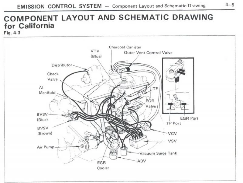

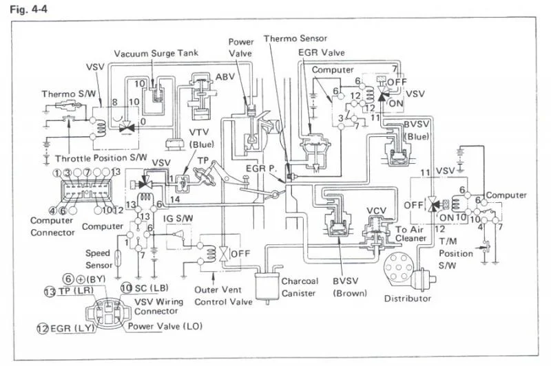

Does anyone know what missing the Blue VTV valve in the above pics would do to my engine performance?
Running pretty good now that I have made the initial adjustments to the carburator as well as fixed the vacuum line routing and replaced with new lines. I did notice however that this VTV was missing on mine.
Thx,
Pwelco
I don't think the missing vtv will have much of an effect. Your throttle positioner should still function to maintain a slightly higher RPM at deceleration than at idle. The TP might just function a little more abruptly, but I don't know that you'll notice it.
Does anyone know what missing the Blue VTV valve in the above pics would do to my engine performance? I did notice however that this VTV was missing on mine.
