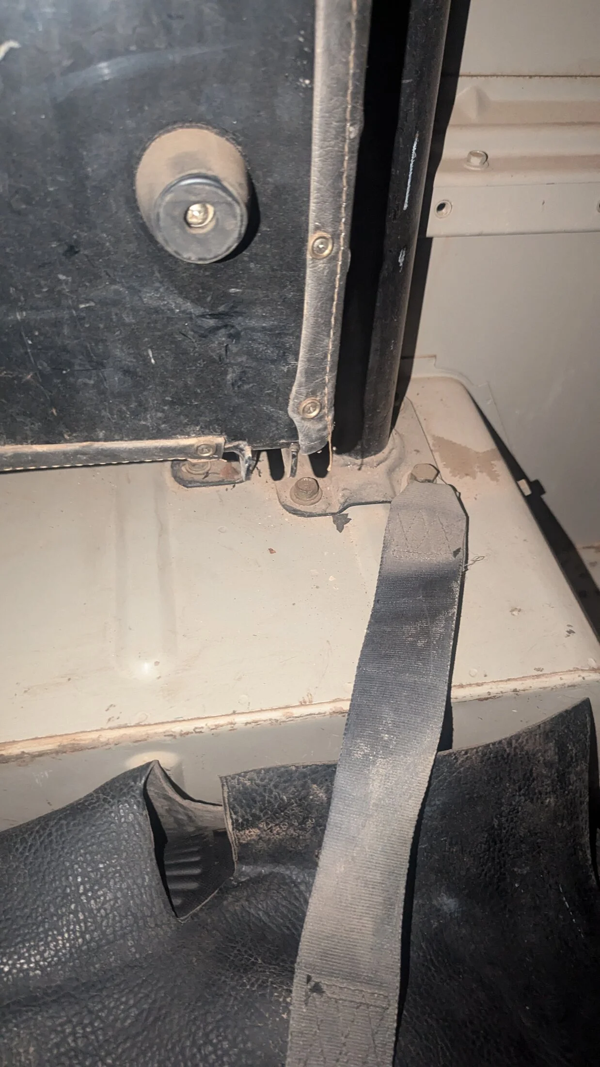

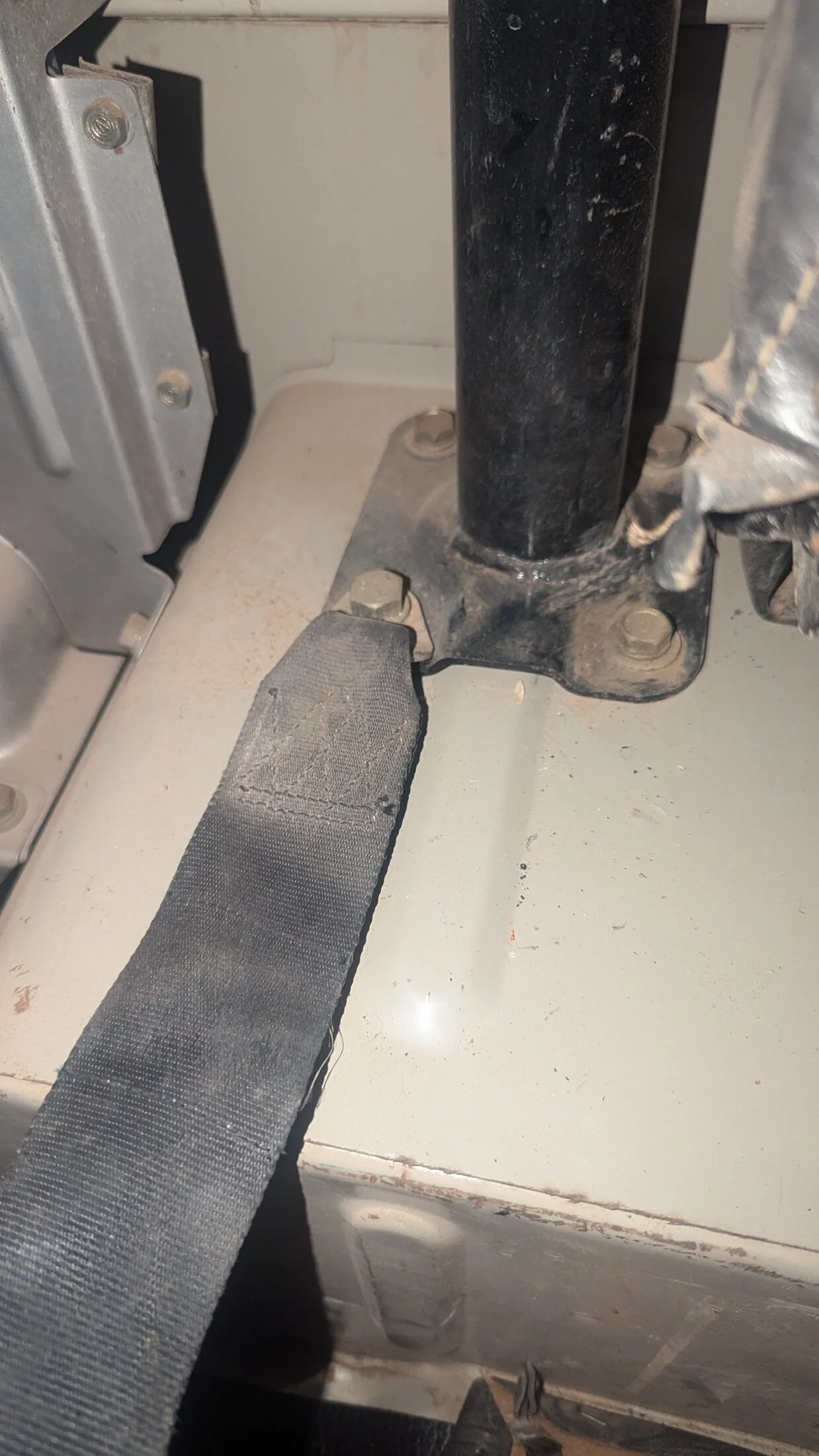

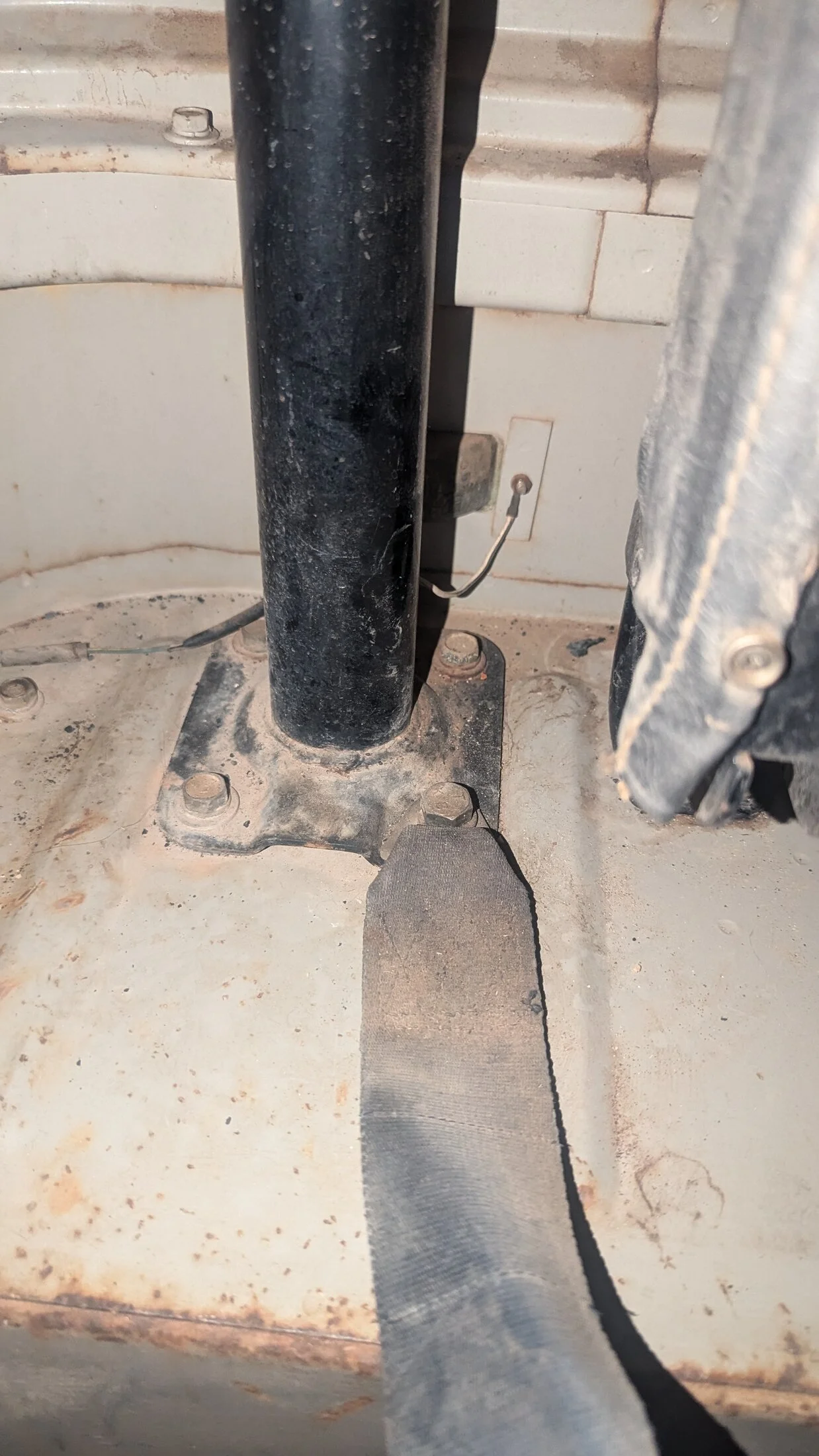

Does the rear jump seat belts attach to the roll bar bolts or jump seat bolts?
If you have a roll bar it attaches to bolt on the roll bar. You use the one that different than the other three.
This is my 10/75 76 model. Should be able to figure out which is each post. It is the front inner bolt on post.

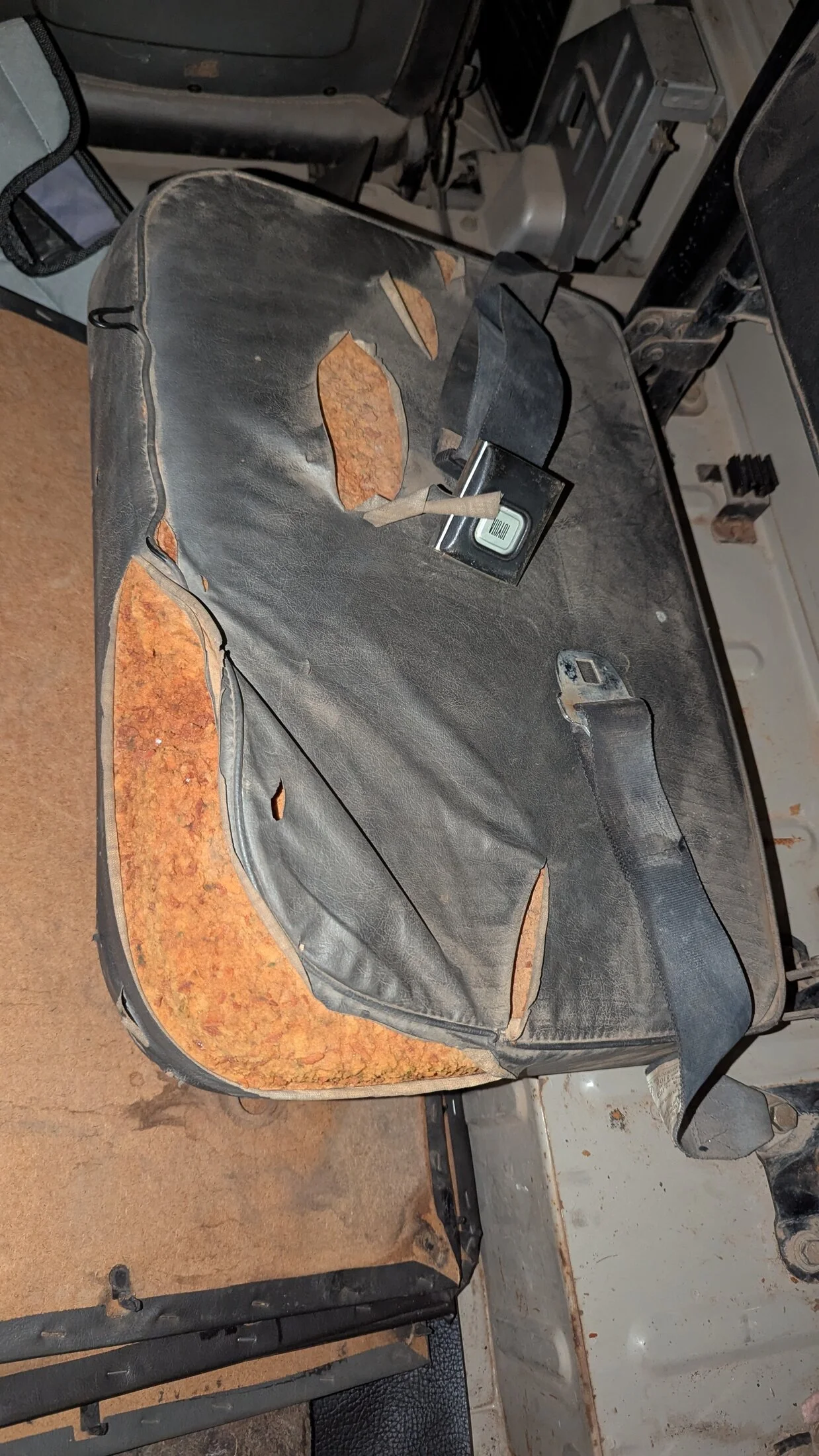

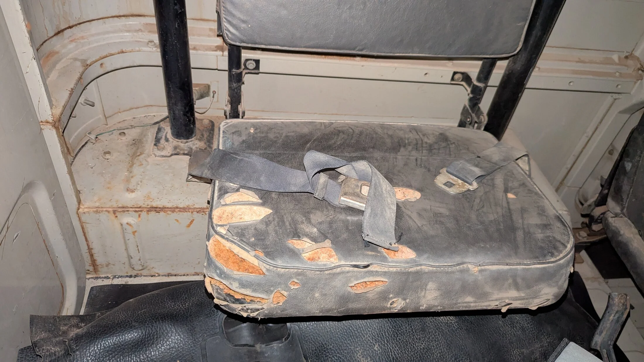

Sorry forgot about this. Original pictures I took seat were folded up and seat belts in-between. Couldn't tell anything. Plan B looked at the pictures I posted earlier and some 78 jump seats set belts I have. But picture with the stitches towards the end is not the buckle end. That is the driver's side. So buckle is on the right side. Unfortunately will probably be July before I am around the 76 because of health issues in the family. May possibly be there mid June for a day or two. Will check it out first change I get .
