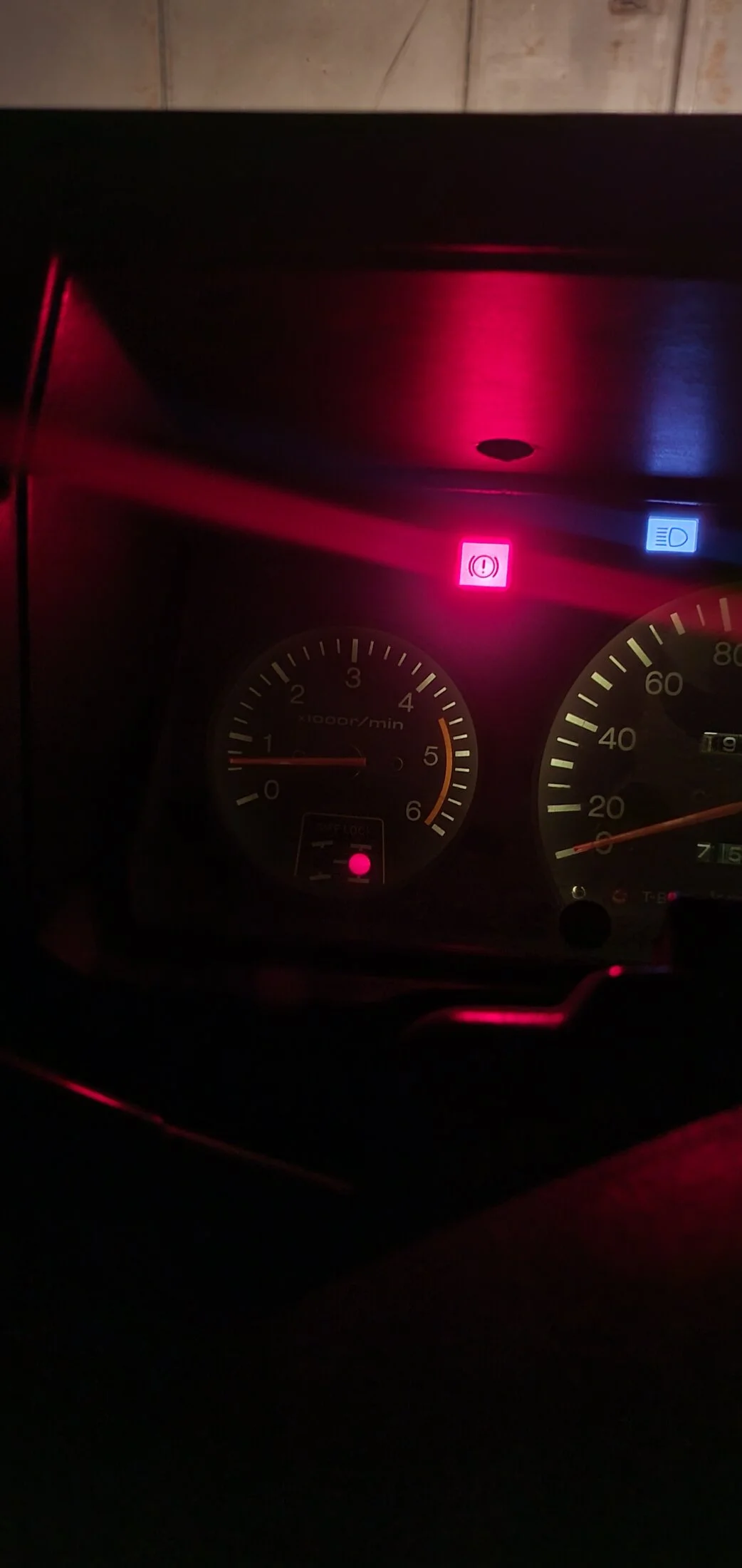

hi guys anyone experienced the rear factory diff lock light on dash illuminating faintly after around an hour of driving. have confirmed diff lock isn’t engaged it’s just the light that’s the issue
thanks in advance

Might be water in the relay

might be starting to ground out somewhere and your getting a trickle of power through it

it’s an electric diff lock so it’s either open or locked
the diff isn’t locked when the light is faintly on it must be a wiring issue

It may be either a peeled wire or a poor ground.
Get a wiring diagram and check the wiring and your grounds.
