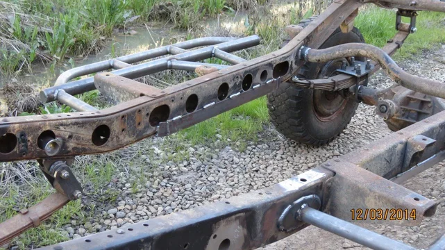

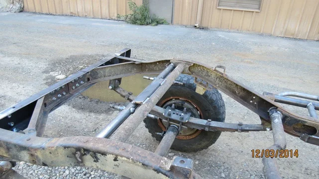

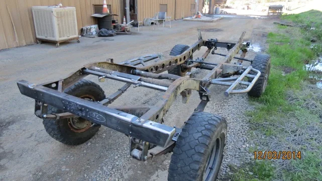

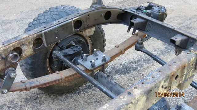

Let's see if we can get the frame pictures in!
WOW! We're on a roll!! The Gremlins seem to have been eliminated. :clap:

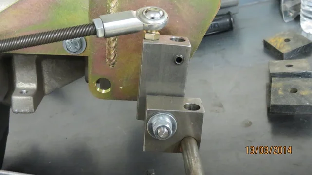

Here's a picture of the twin-stick with set screws to make installation and maintenance much easier.
The set screw on the outside block is accessible from the back, so the threads are in the thickest part of the block next to the hole.
