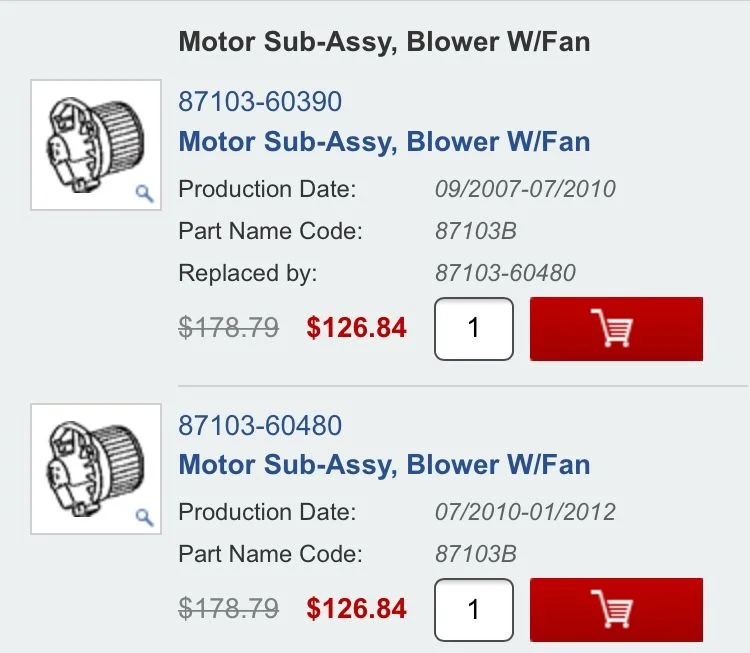

Theres a thread with the part number you can order If you can turn a screw driver, you can change it yourself.

The OEM fan only costs around $125. (Motor with the fan)

Here is the part number I came up with
