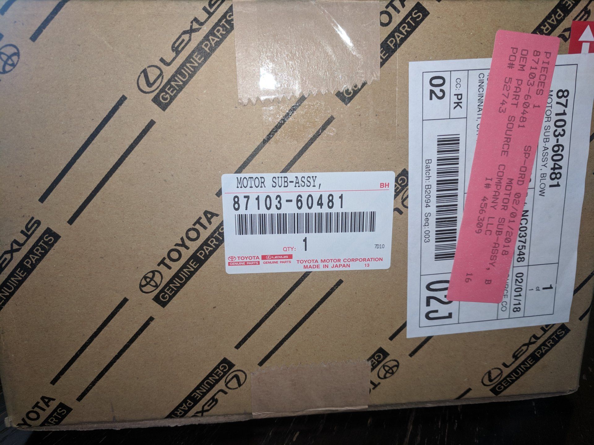

I see from the label on the package that it’s the motor sub assembly. Do you mind if how ask how much it see you back? And yes, it looks to be a relatively simple repair. I was digging around under the dash this afternoon, and if I’d had another half inch of clearance I would have had the motor out without removing the glove box....but no such luck.

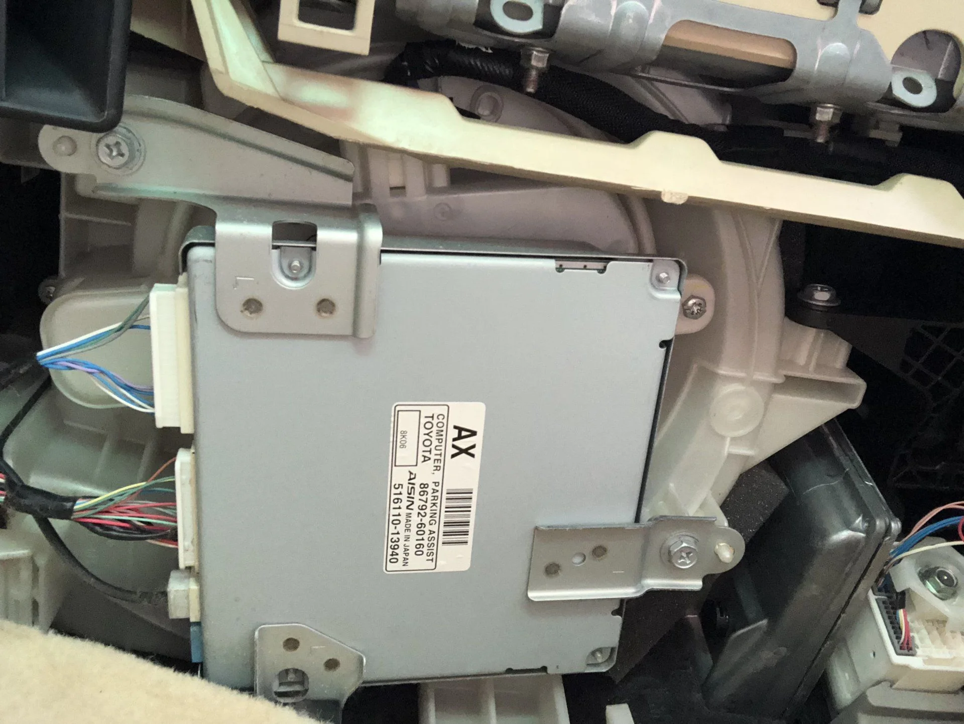

My replacement blower came in on Friday afternoon and I was able to get it installed. Took me almost an hour to get the old one out but after re-reading this thread several times I managed to get it out. Thanks for your tips on this install ForrestGrump! I ended up having to remove 3 bolts to get the radar unit out, then another 3 for the blower assembly.
Once this thing is off you can see the blower and the three screws that need to come out of it to remove:

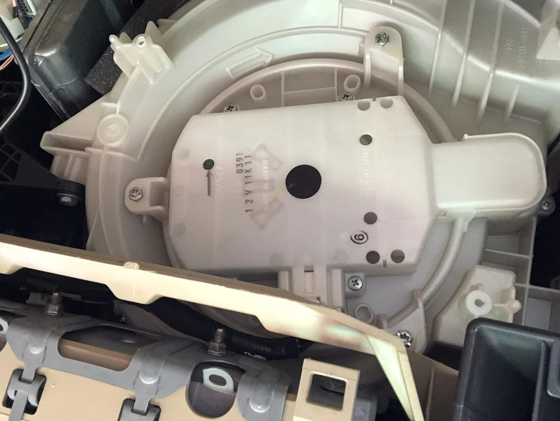

Here's a close up with the lip of the dash that makes it kind of a pain to remove the blower. The connector is right above it and it's tight in there...

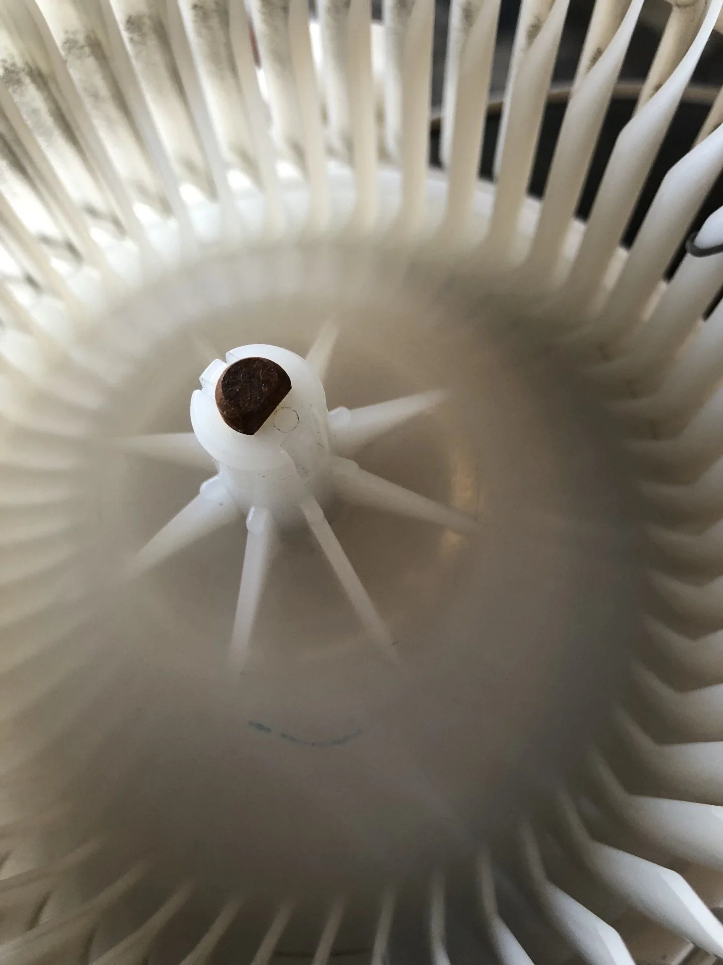

Here's a shot of the rusty old spindle. This thing wouldn't spin around easily at all. i can see why it was so noisy and vibrating so much.

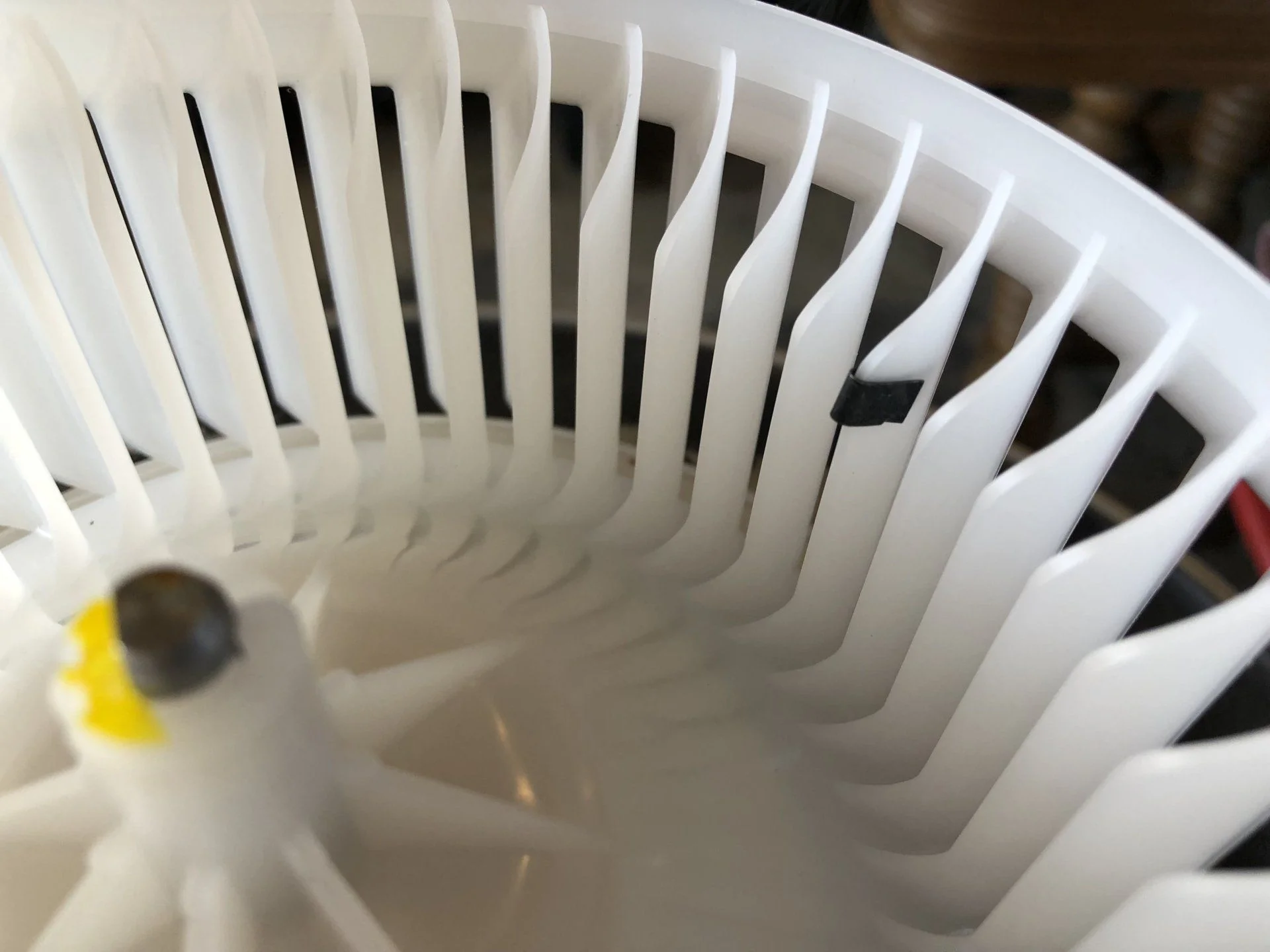

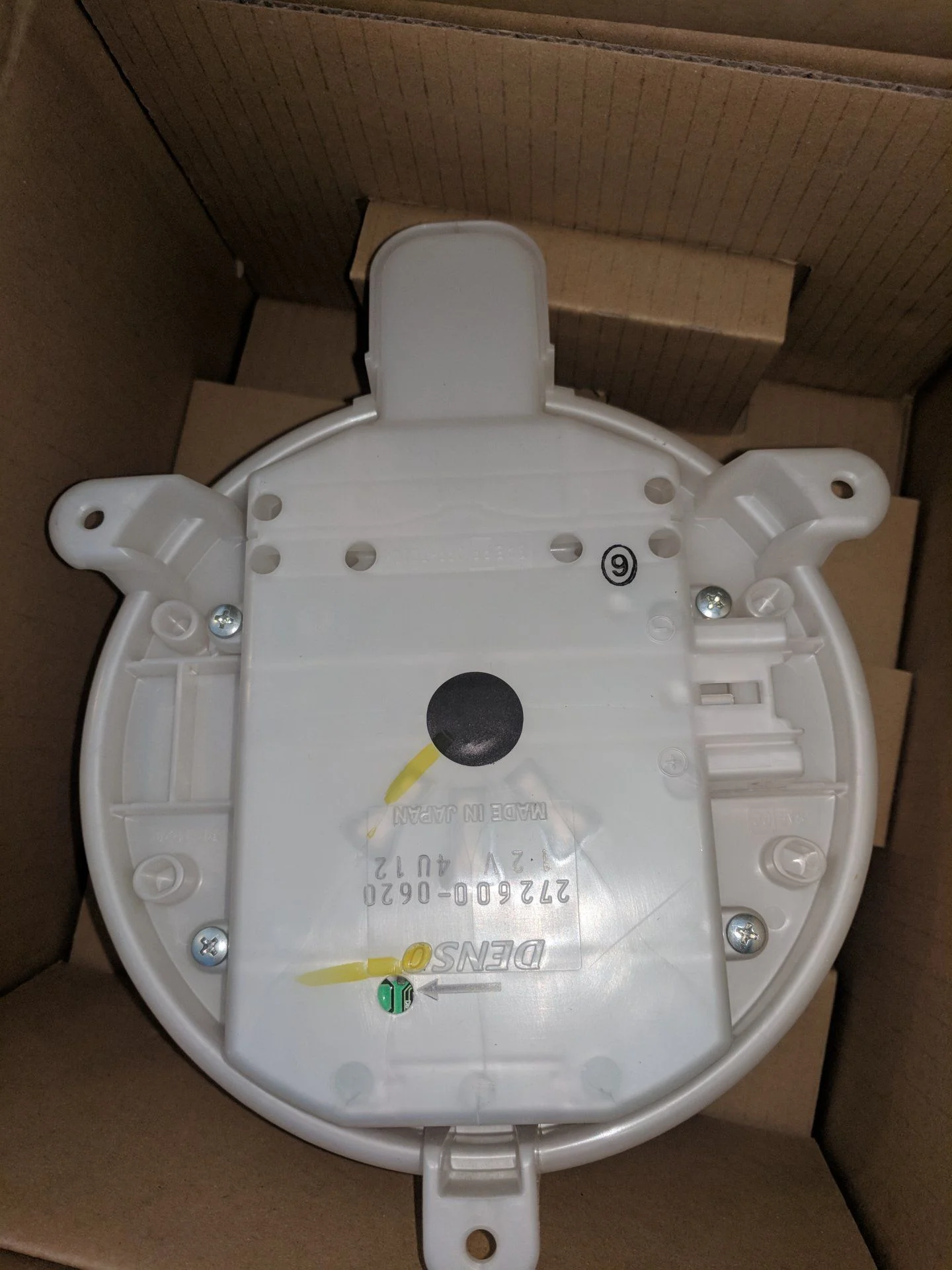

And finally a shot of the new unit - this one had a metal clip on one blade (I'm assuming this is for balancing) and then the blade directly across from that one had a small piece of black tape which is probably also to balance the fan I'm guessing.
The new unit is super quiet, all my vibrations are gone and it blows strong. This is easily the best 150 bucks I have spent on this truck to date!
