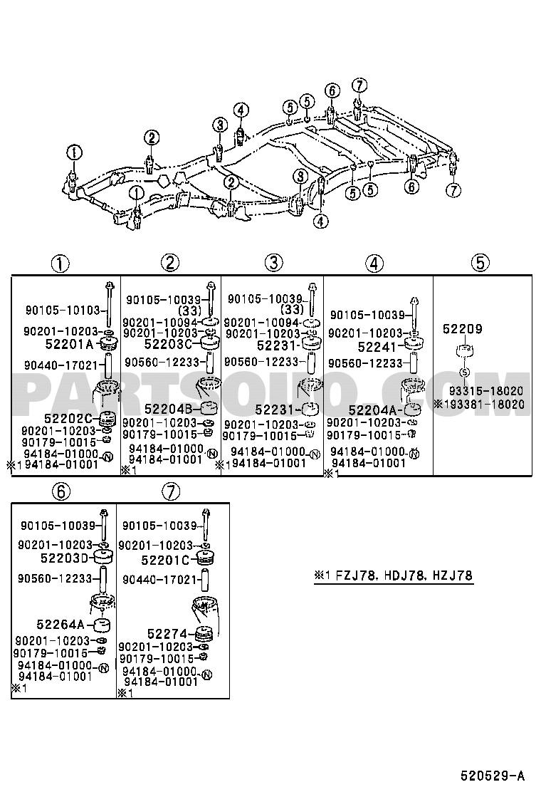

@WarDamnEagle @coldtaco How big of rubber spacer is there between bed and frame mount? Either of you know where to get bolts? looks like some sort of T bolt is used
PN 4 x 66418-95400 - Mounting Bolt
I had some energy suspension mounts from an FJ40 and just welded bar stock to the top of the bolt and used it.

we think alike. i bought another fj40 mount kit last week for this purpose, until I saw the mounts on the bed side and realized there is some sort of T bolt.
No T bolts on my '94 FZJ75 as far as I can tell. I am not home so I can't look at the truck but here is the relevant Partsouq.com diagram and the bolts are all hex head. Hard to tell how tall the spacers are from the photos. Maybe 2"??
On the 79 bed I believe there are 4 regular style nuts and bolts and then 4 of the T-bolts.
We made our T bolts 1/2" longer to accommodate the spacers we are running....
