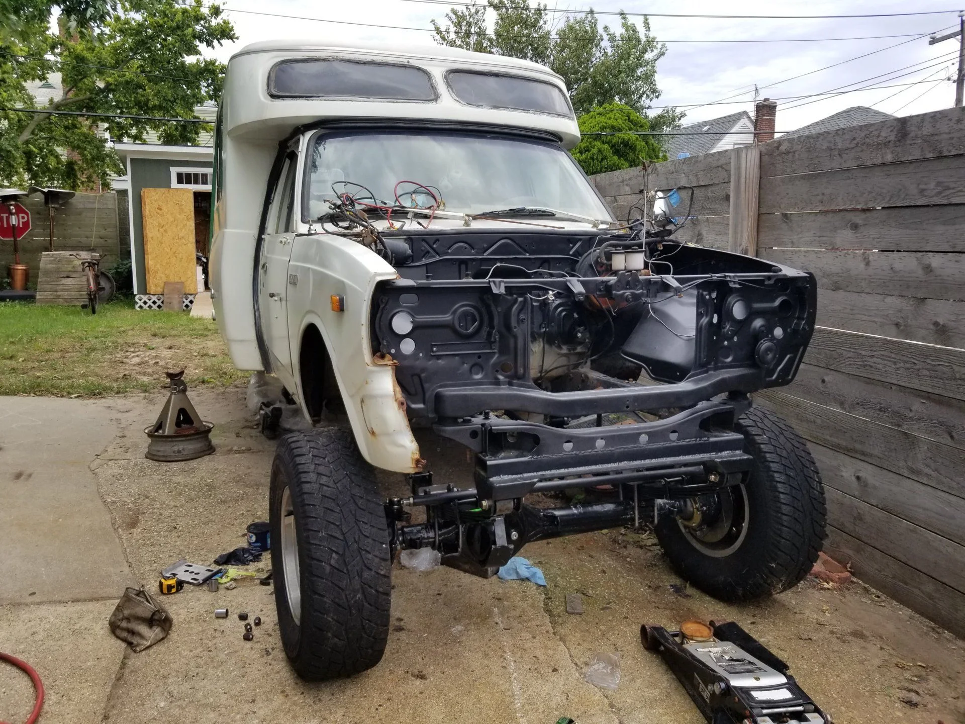

I'm building a 75 chinook in Rockaway for dirty travels. I've done an sas swap on the original frame with elockers front and rear. Drivetrain get's mocked up next. More to come.

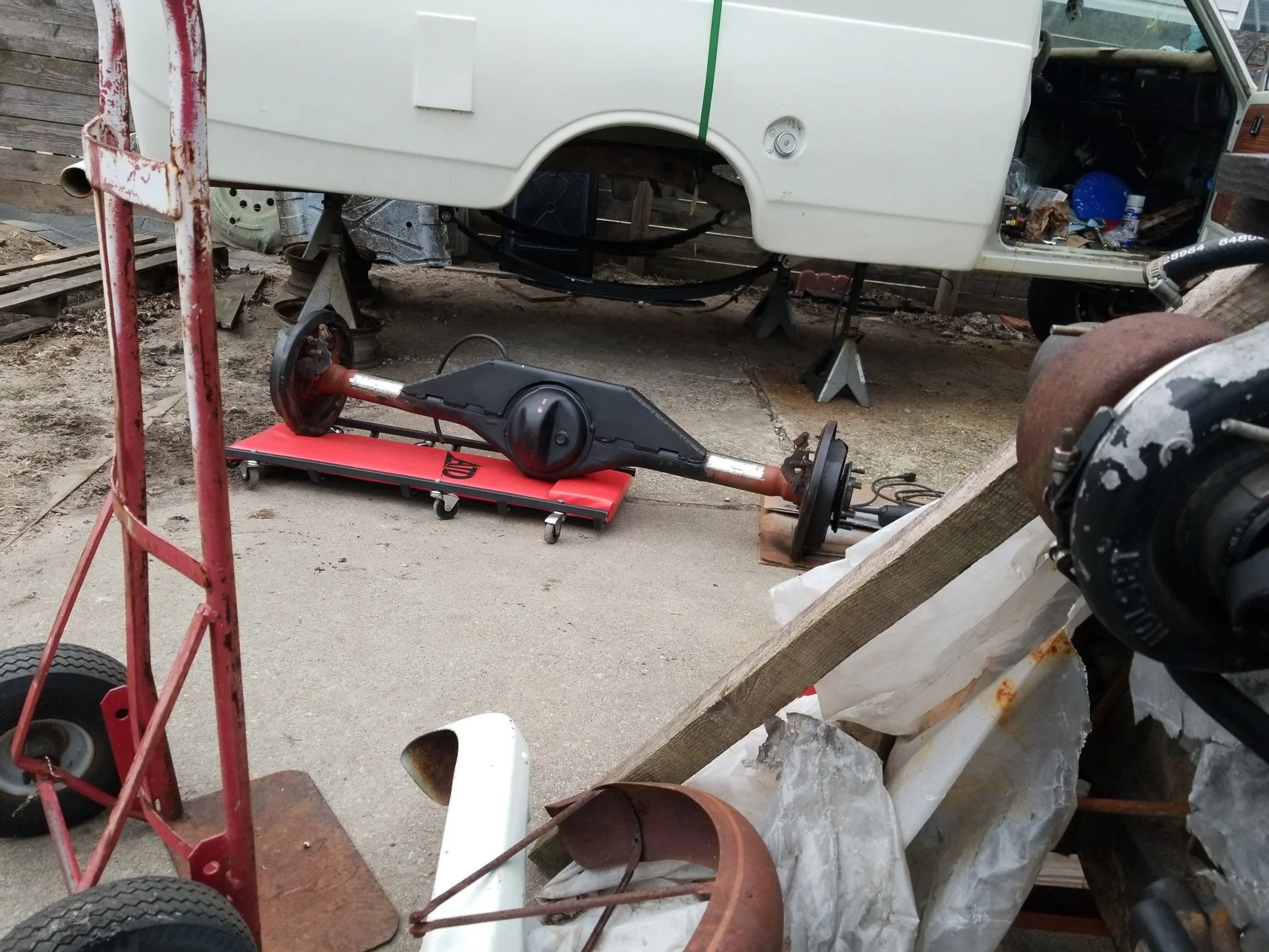

The inside is gutted, so unfortunately there's nothing to look at. I'll eventually redesign the interior with more headroom and hopefully a better layout. Right now I'm just trying to get it rolling again. This weekend I got spring attempt #2 in with an elocker 4runner rear. The rears are 52" Chevys. Not much else will fit the stock frame and these worked all right. I'm waiting until the drivetrain is mocked up to tack the spring perches in.
This is mocked up at final ride hight with 35s. One of the worst things about the chinook is that if you're tall your head hits the overhang above the door (my excuse for big tires, lol). I'm happy to say that won't be a problem anymore. My girlfriend is going to need a step to get in but every build has it's compromises.

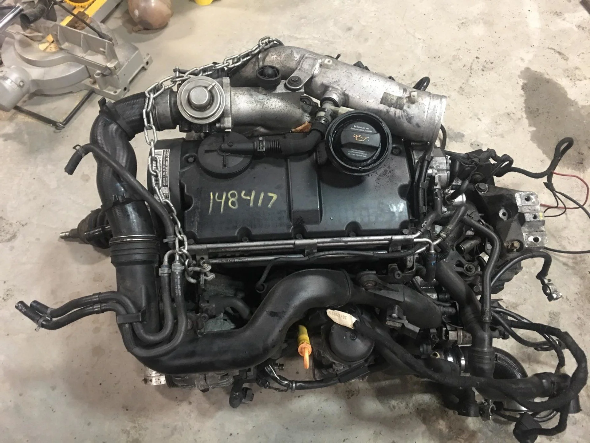

The motor is going to be a 1.9 TDI PD150. I got an adapter from TDconversions.com so that's in the works as soon as it isn't 9 degrees outside.
