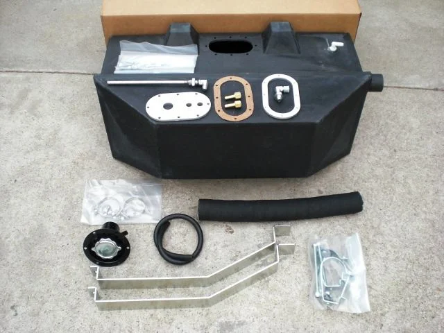

I want to remove my front tank under the passenger seat. What are my options for a rear tank? I have a fill point for the rear already. Is there a stock tank for another vehicle that will mount easily?

Steel tanks are not as strong as the nylon tank Mark sells. During laboratory testing the steel tank ripped open, and the nylon tank merely dented. Plus the nylon tanks have no seams/welds to become a problem. Just saying.
