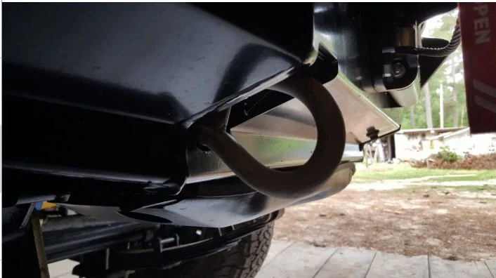

So got the pricing sorted. Works out to about 135 USD. 4 kits ordered. They sell for $174.95 INC GST AUD.
No worries if that changes anyones mind in getting these, i will have 4 sets with 3 spoken for already.
Edit, all spoken for.

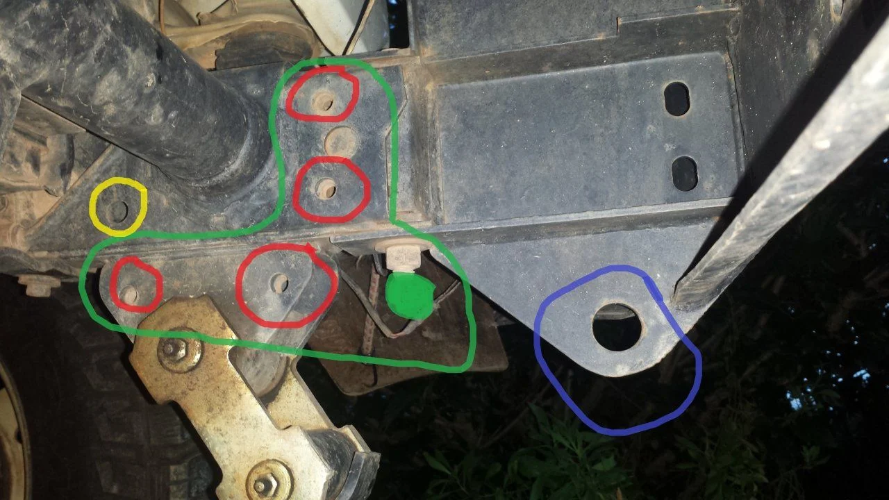

Recovery points for 75 series is a pain isnt it, Once you put the arb bullbar on it really limits your options because ive been told that the two points down the bottom are for winching/ tie down points not for snatch strap other wise they start to go oval as theyre only 6mm thick.
The only decent option is the outback ideas one the L shape one but they utilise captive nuts in the spring hangers. I guess thats alright unless your really stuck in thick mud and a putting a heap of load on them. I think i'll fabricate some of my own unless the ones you get Andrew look decent.
Heres a picture of my left chassis rail with a ARB commercial winch bar (1995 model)
Blue circle is the bullbar winch point
red circles are where the out back ideas point bolts
the yellow circle is where is looks like that blue recovery point bolts but on mine it doesnt have a captive nut
If I was going to make one id use the design of the Green outline and probable cut and fold up the bull bar metal sheet to the right of the arb point so the strap doesnt rub on it.
anyway thats my 2 cents.
Keen to see the points you brought fitted Andrew

^ why do all that? Wouldn't it be easier to drill the existing hole out a little then add an eyelet and a few plates for structure? I honestly don't know, not trying to be sarcastic.
I've shown Rob these photos and he is now fabricating his own design. (One that will work with a factory winch and skid plate).

The reds add both vertical and horizontal stability, you spread the load on the frame this way. Even a plated bumper would shift eventually as there is play in the mounting brackets during a hard yank. I have never liked bumper recovery mounts, good for winching, but even then have seen some move and need to be re positioned during a really hard pull.
i would also prefer the above to a bumper plated jobbie.

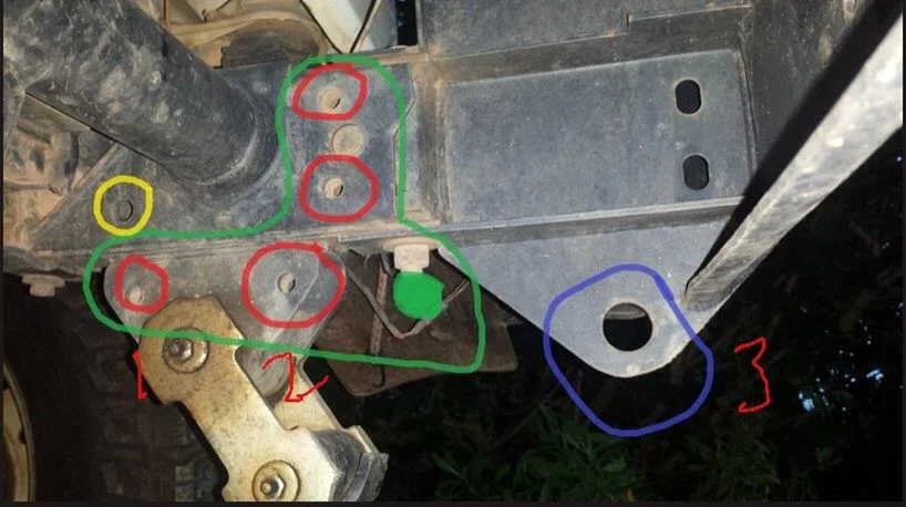

I would rule out numbers 1,2 & 3 very quickly.
Agreed, you need all red ones. you could get by with the two vertical reds + yellow in a Y type config. I would be comfortable with all reds and the yellow.
I would never pull on the brush bar and I would be very reluctant to pull on the spring hanger unless you could pull very gently.
