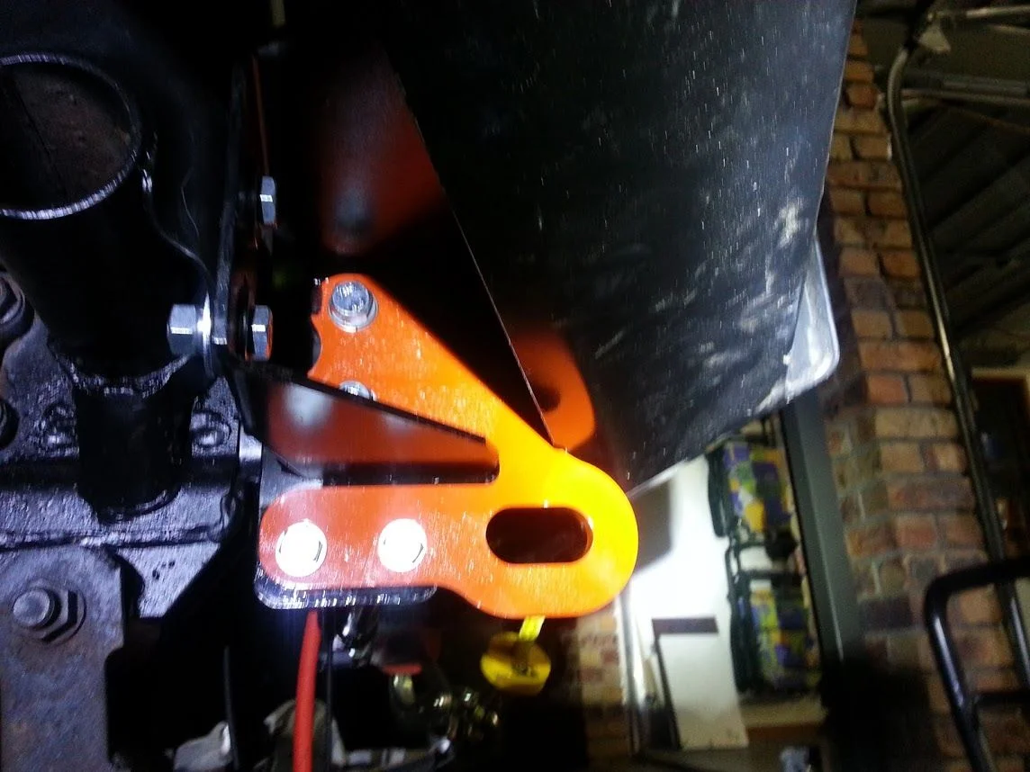

I've spent a bit of time playing with front recovery points for early 70 series cruisers (eg. narrow front).
I've got some commercially made points from a mob called 'outback ideas' but they're no longer making recovery points. No pictures unfortunately.

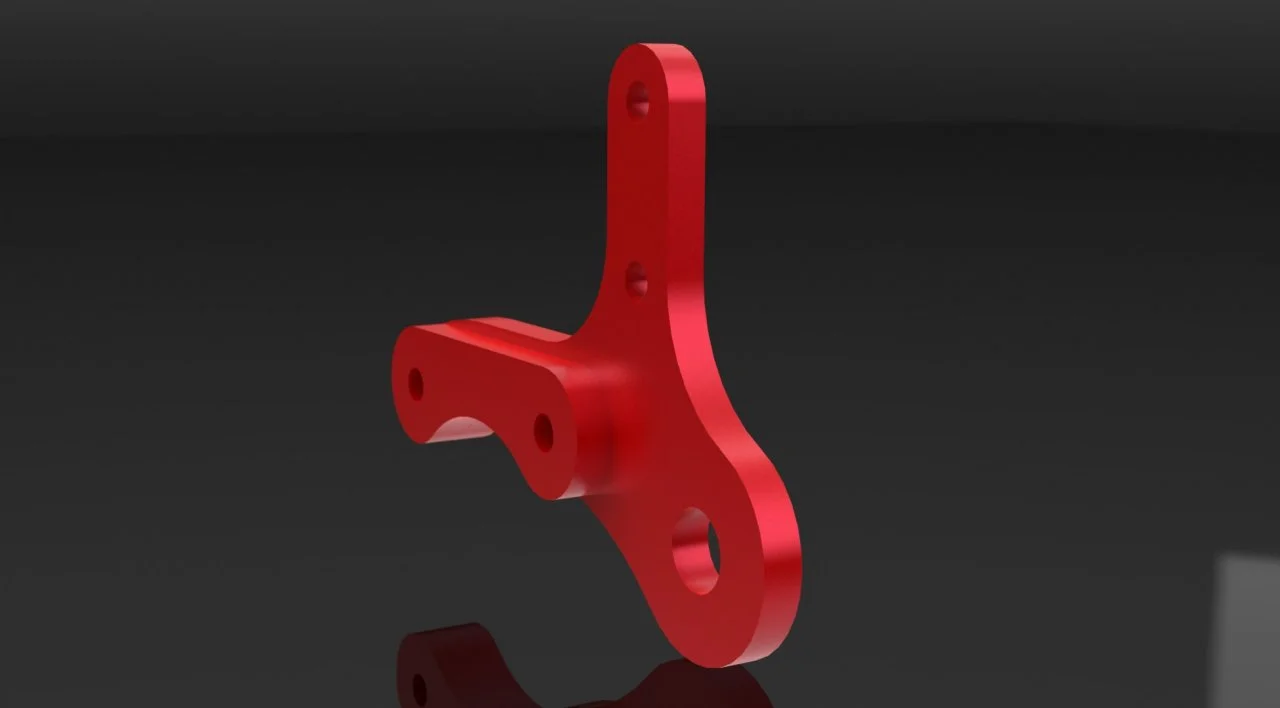

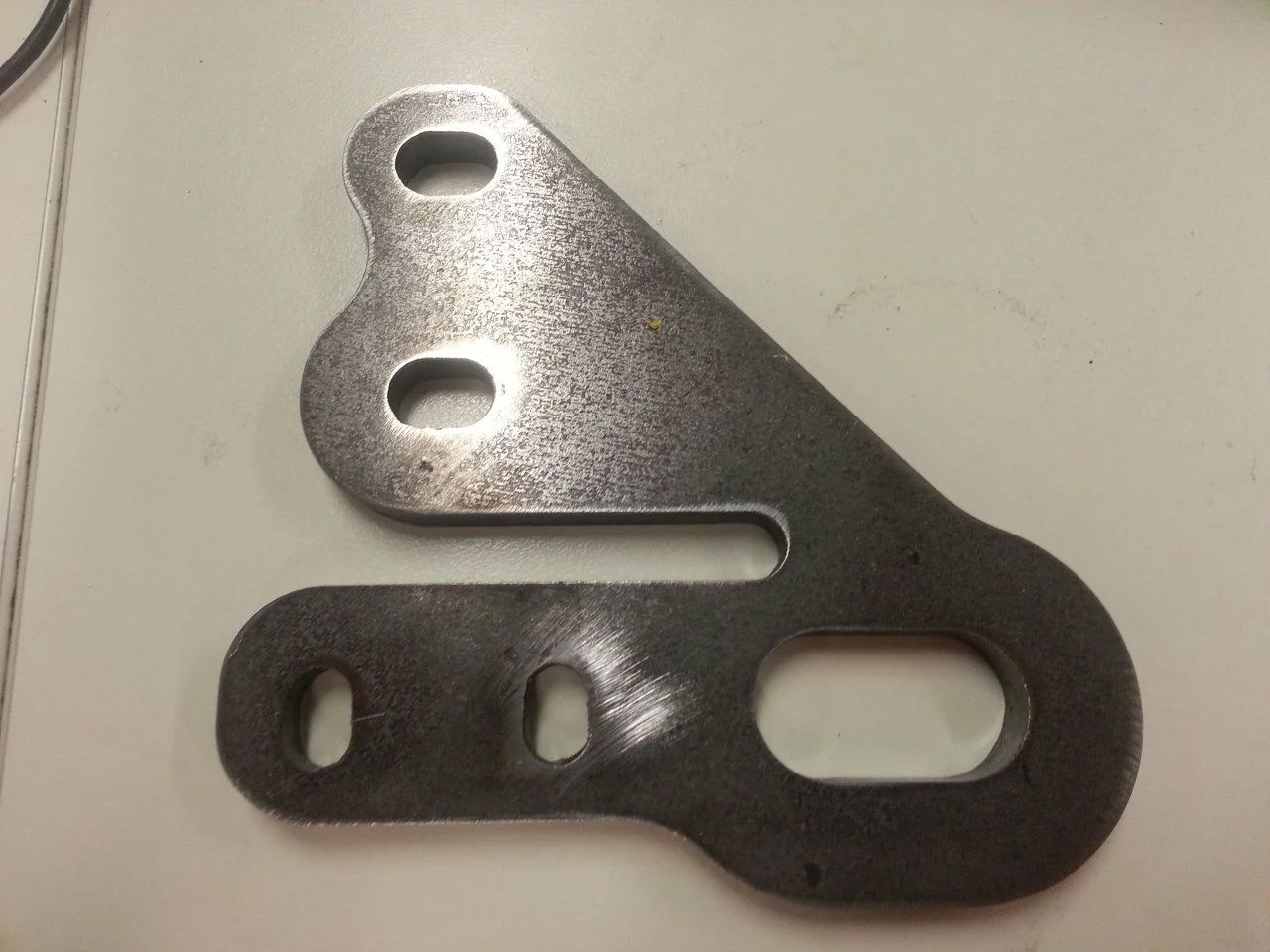

Next up are some recovery points to suit the TJM Outback Deluxe winch bullbar that I designed and made to go on my brother's BJ74 and another mate's ('Chuckles') BJ74.
First in CAD

Then in the flesh

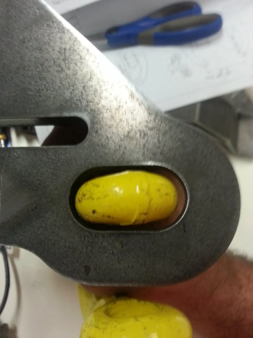

Test fitting for shackle clearance (4.75 metric tonne shackle)

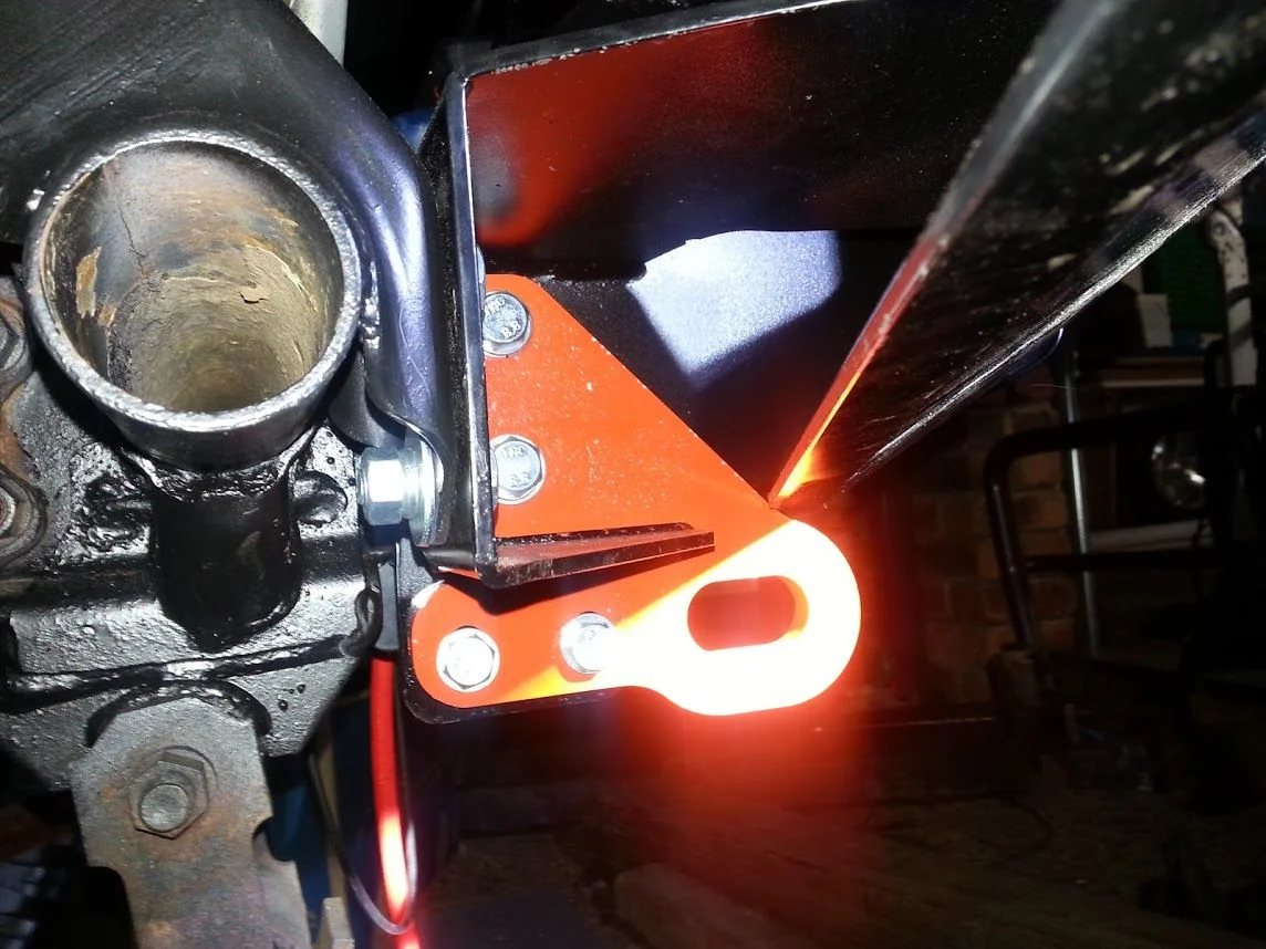

And finally on the car

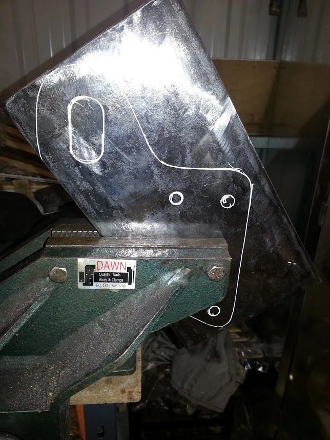

I also helped a mate make some recovery points to suit his LJ78 Prado. We'd fitting an earlier TJM 75 series winch compatible bullbar, it took a bit of Fab work on the mounts but wasn't too hard to bolt up.
First we marked them out on some 10mm plate.

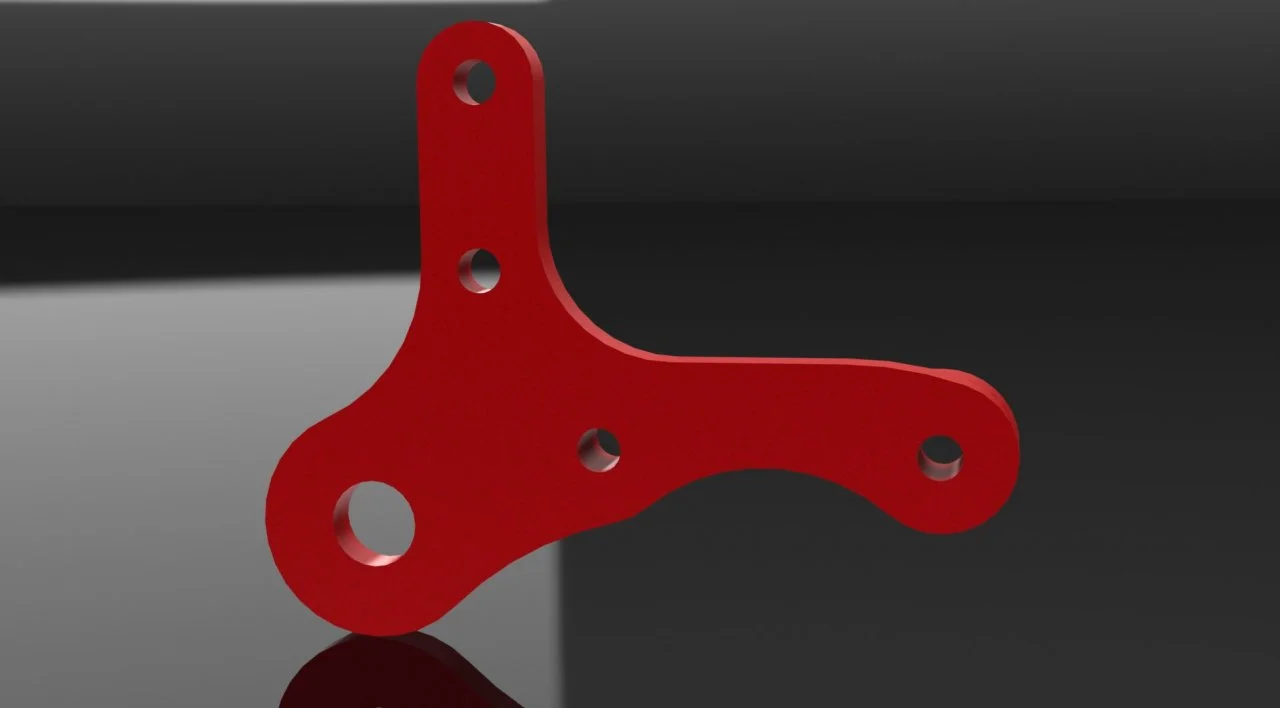

I've also drawn up some recovery points which would suit my BJ74 with its ARB deluxe bullbar on it, but have never got around to making any because as I mentioned earlier, I've got these outback ideas points and have no issue with them. They basically combine the best features of the outback ideas points with the best features of the commercially made points in the 'painting' photo in the previous post.

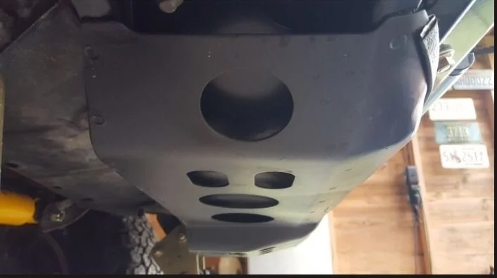

I assume these recovery devices only work if you don't have a factory winch and protective skid plate.
lol... I bet i could make it work with 550 cord and 10mph tape :D
