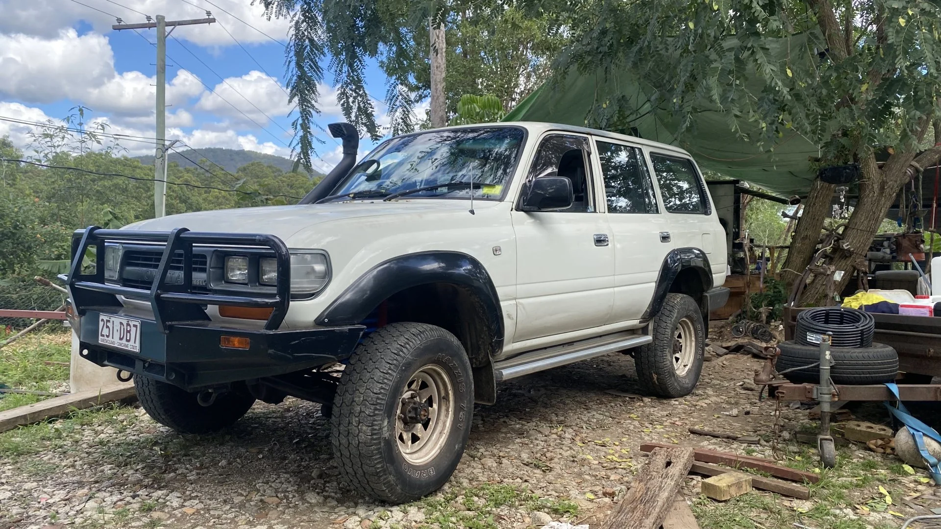

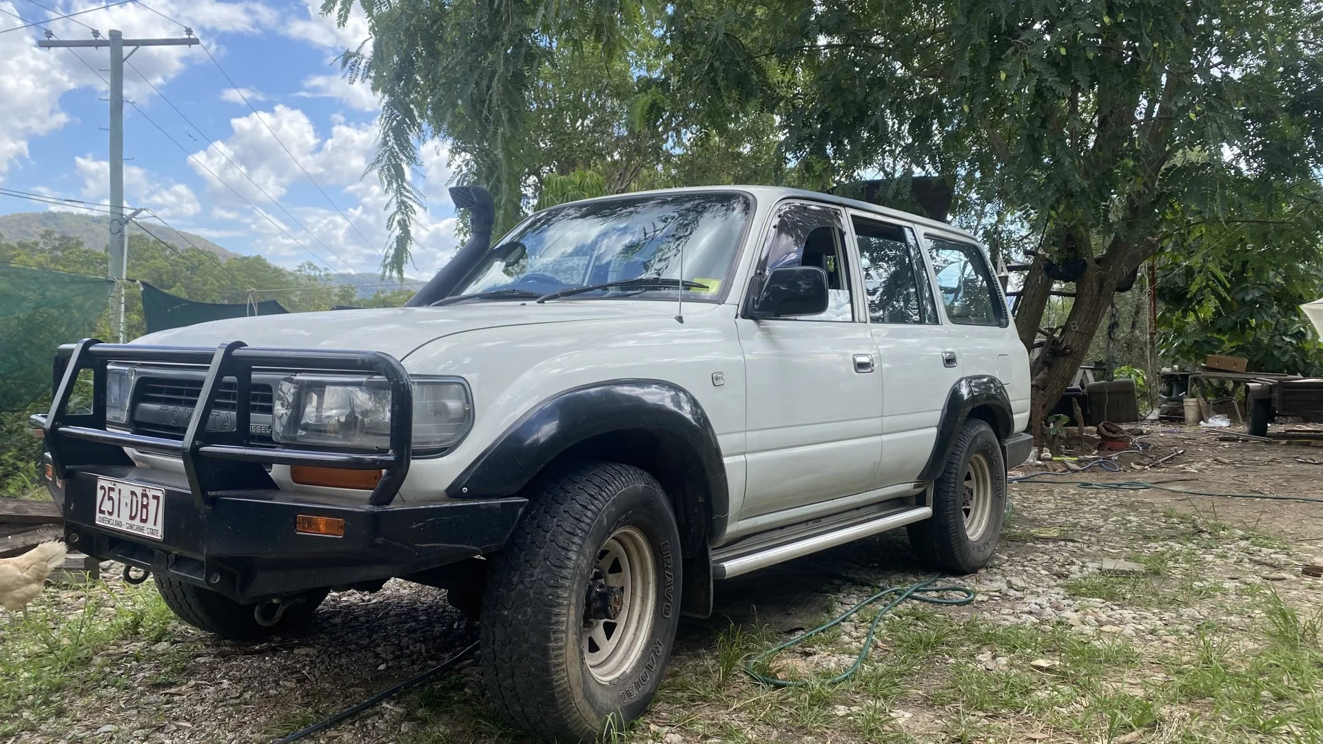

Before
Afta… with 2” lovells heavy duty coils and EFS Xtra shocks…
No more squeaks!
