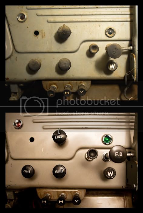

just a cleanin? what did you use? looks much better BTW.

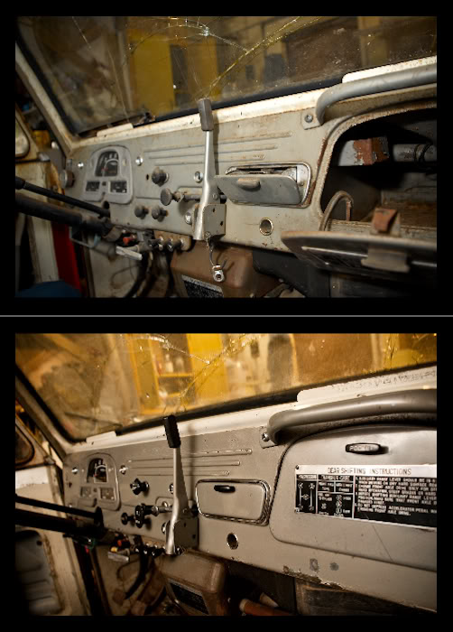

Thanks. I'm really happy with it. I scrubbed it with simple green, wet sanded, rubbing compound and waxed. It all started with the knobs. I read a thread about refurbishing the knobs and couldn't stop there. The gauge cluster, radio, transfer lever, ashtray and pocket door were all removed and cleaned separately.

the light switch goes where the choke is and the throttle goes over the choke:meh:
According to the owners manual you are right. Although, some pictures of other LV dashes show the same configuration of knobs and switches that I have. I would be surprised to find out that these had ever been moved. With this Cruiser it just seems like it's never been fooled with. Maybe they were different on the wagon compared to the truck or maybe it's one of those weird '67 wagon things where some parts are just a little different.
Both my 67s are set up that way,light switch on the right above the throttle control.Any pictures of your cruiser?

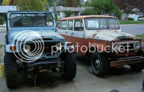

her'es a pic of my cruiser
Umm... Your plush green carpet is supposed to go on the Floor, NOT on the roof... Check your service manual for correct installation of vehicle interior carpets.
Other than that the body looks straight and dent free. :clap:
