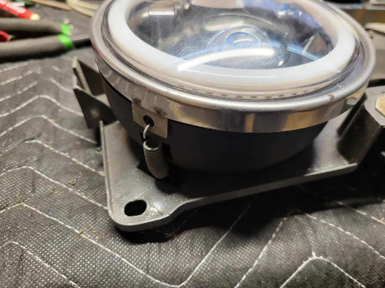

Desire LED headlights with turn signals and running lights. Decide i need to terminate the wiring, so I should do this right away-ish
Remove the OEM FoMoCo script glass lens sealed beam headlights.

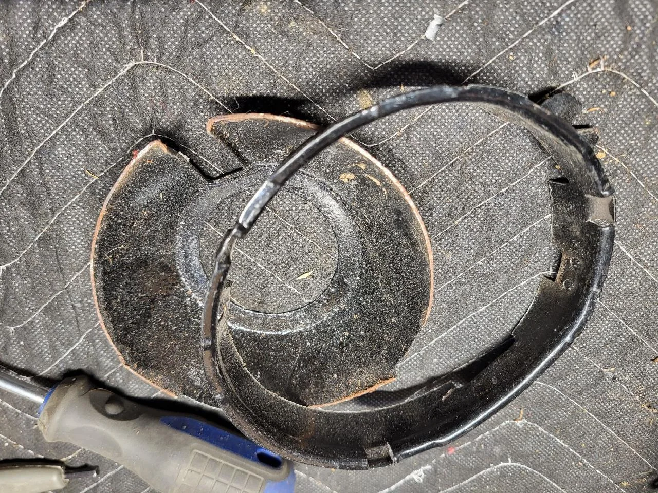

See the new LED headlights are too deep for the buckets. The instructions say cut the headlight buckets so I did that. An alarming number of features got cut off. Put that off for a future version of me to deal with. Also, after the bowl was cut from the mounting ring, there was nothing for the bucket to pivot on. The adjusters are two screws working against a spring. It needs the bottom to act as a fulcrum.
Watch SuperfastMatt

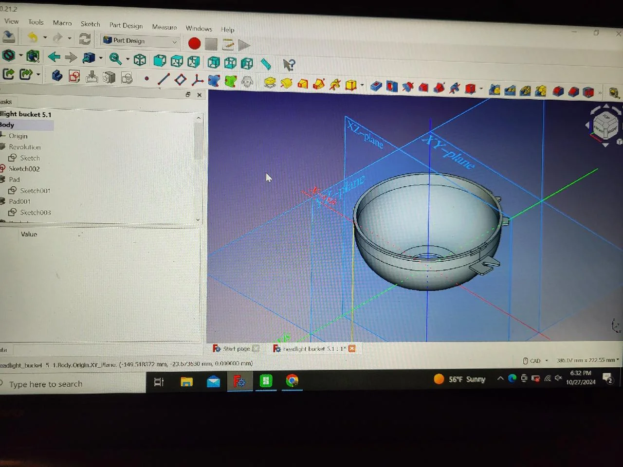

Buy a Bambu Labs X1C 3d printer.

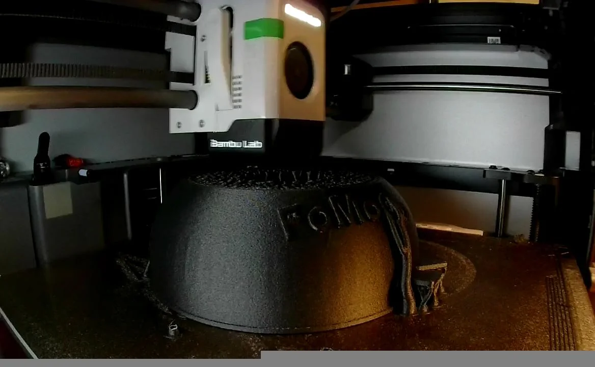

Re-learn solid modeling.

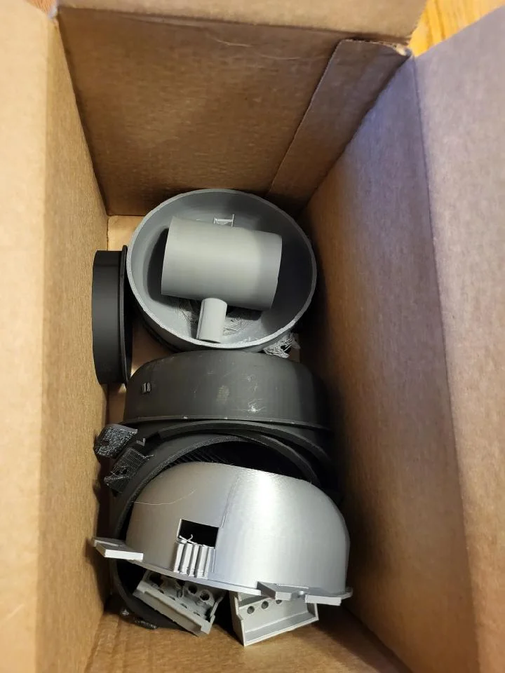

Print 7 versions of a headlight bucket.
Print 4 of the final version. Order new adjusters and springs

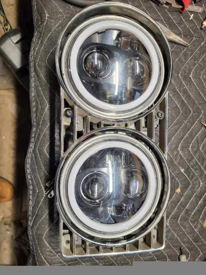

Assemble.
Easy, easy, lemon squeezy

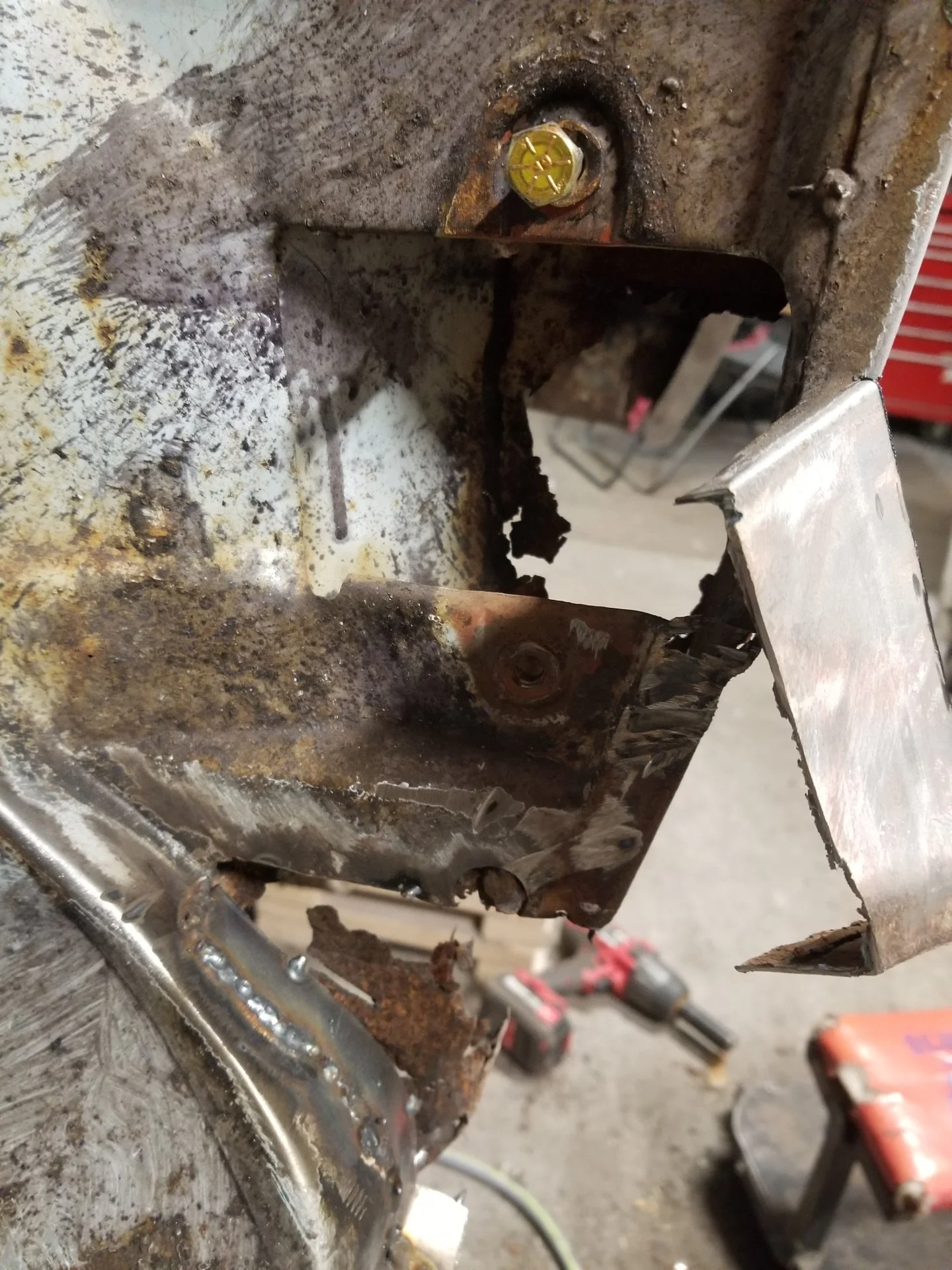

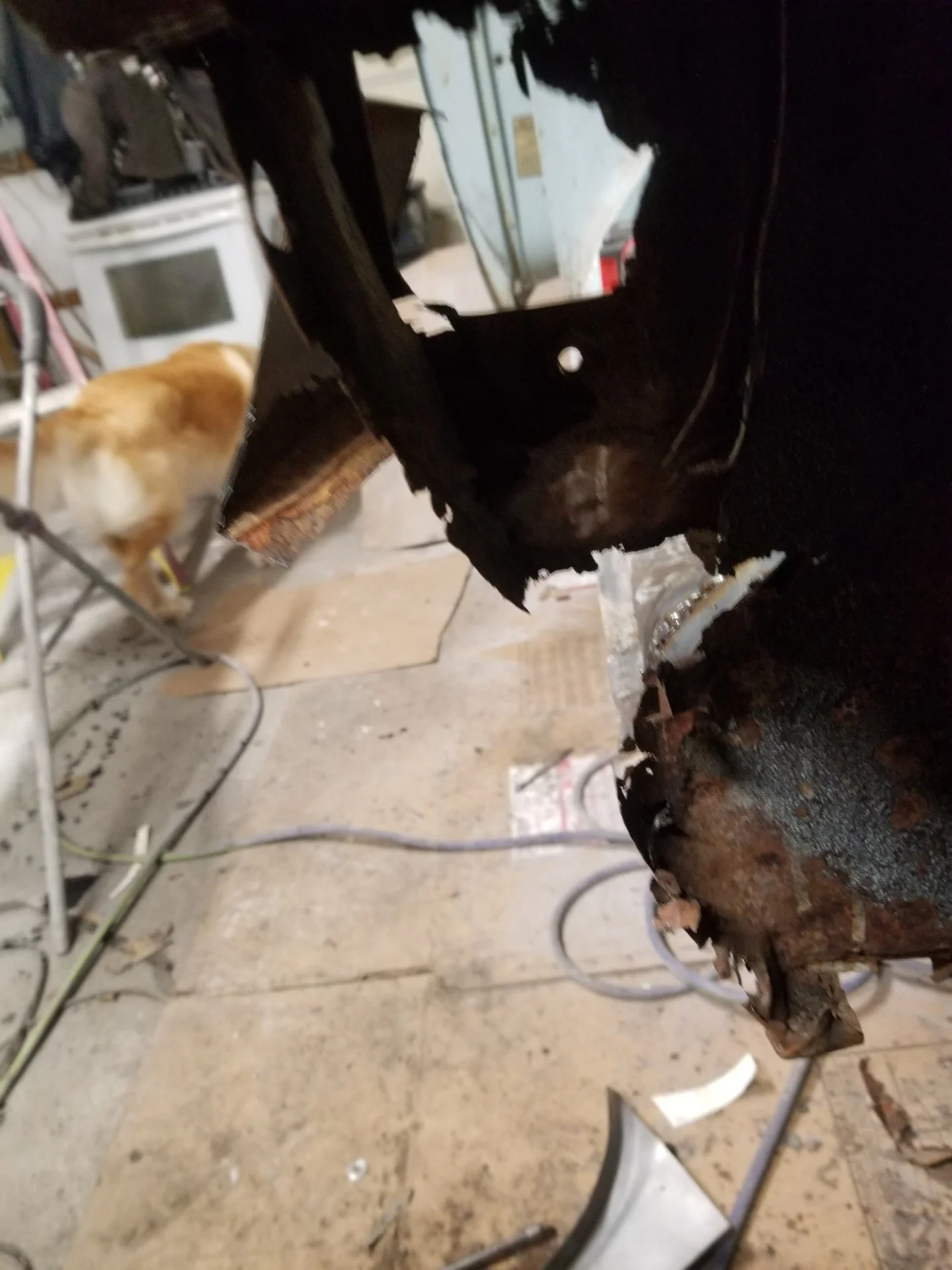

The dogleg hole required a lot of work. I ended up ordering a patch panel because of the wheel arch lip that fades away on the dog leg. I’m going to have to form part of the arch anyway. My plan is to use my bead roller with a custom turned roller. The inner wheel well was gone about 12” around the lower hinge. The hinge bucket was gone. The lower part of the door jam was bad. There was 4 layers together all needing repairs.
The outer door patch on the left is unfinished because I can't do gaps until the dogleg is repaired
Dogleg with the loose rust removed.
