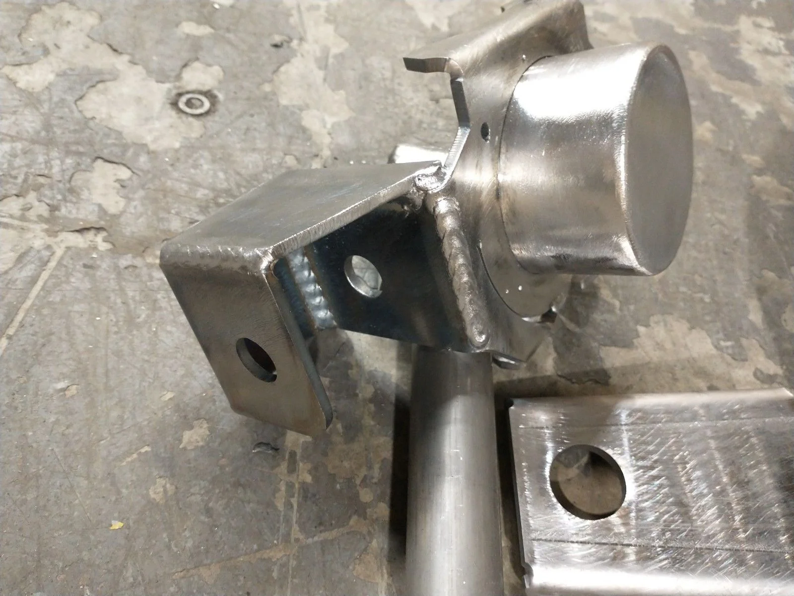

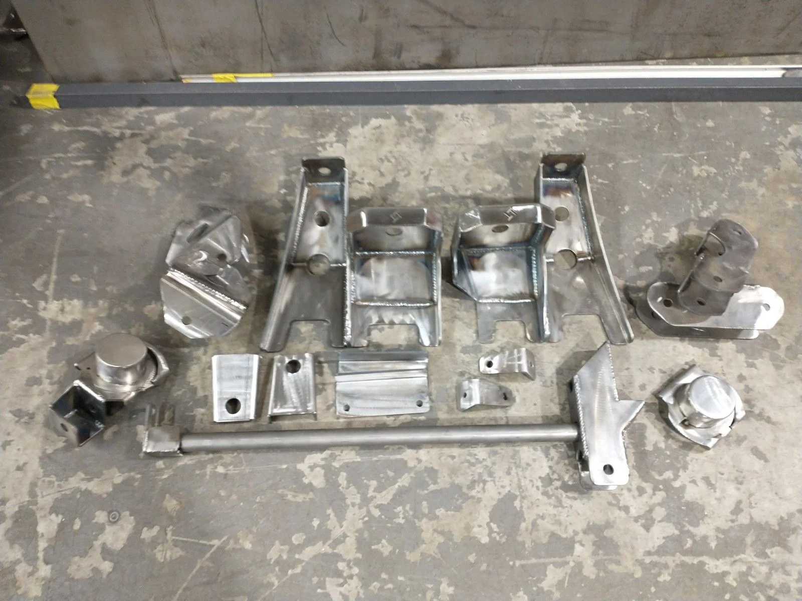

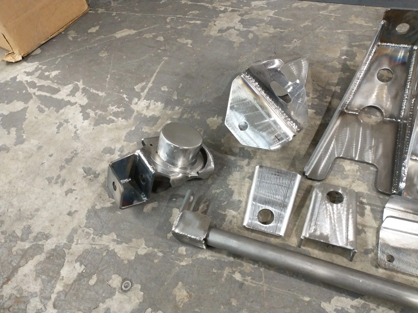

This kit is being finished up this week for the front and rear.
All frame brackets, properly ramped axle coil buckets to accept 80 coils, axle brackets for radius arms, panhards, rear upper and lower control arms with crossmember, front upper coil and shock towers, rear upper coil buckets with shock mounts and transmission crossmember adapter brackets.
We have had excellent results with the 80 axle swap and are finally caught up on all fabrication and orders. Total of 34 kits out in the world now in 5 countries.

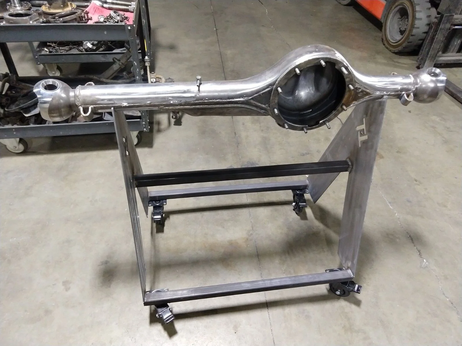

A little teaser pic of the 62 housing stripped and ready for brackets.
Will be ready to ship kits in approx. 2 weeks.
PM me for pricing and details.

Several have been asking for this kit. 60 axles for a 40/55 and 60 series. This uses a 60 axle with 80 coils and shocks, radius arms and panhard bar.
This is a 1:1 ratio kit... want a 2" lift ... order 2" lift coils.
Kit includes ALL brackets to convert your front to a 60 axle and 80 series components.
Currently ONLY offering to Trail Tailor Customs customers.
