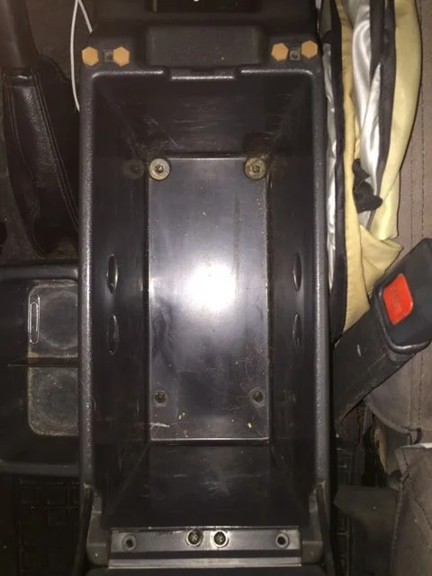

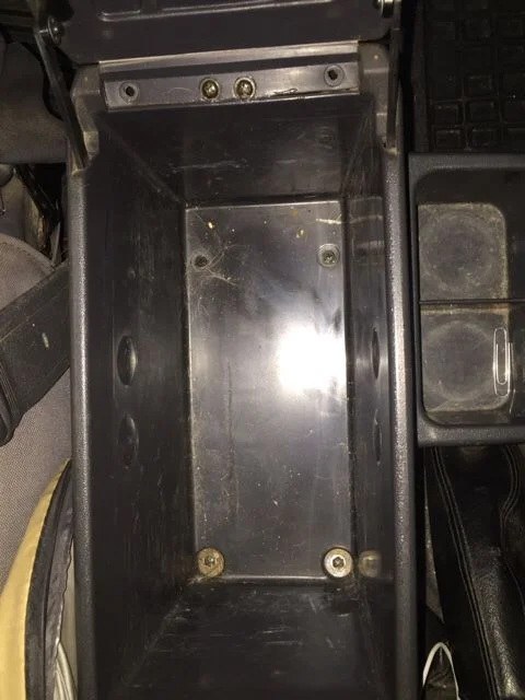

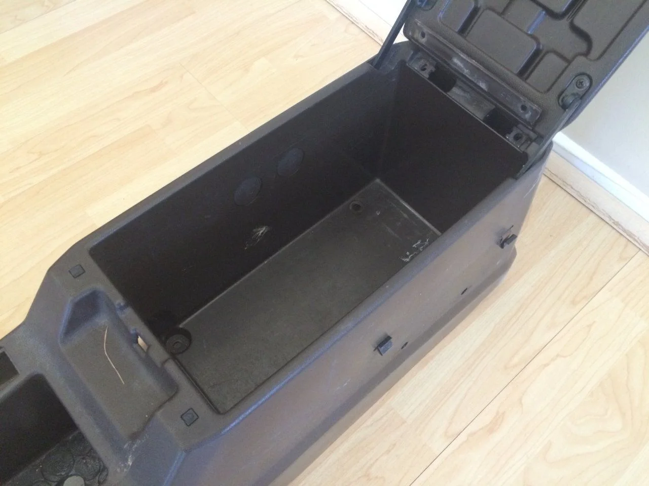

Can you take some pics of the 62 console you have...preferably empty :hillbilly:
Man it need to be emptied. Let me know if you need dims.

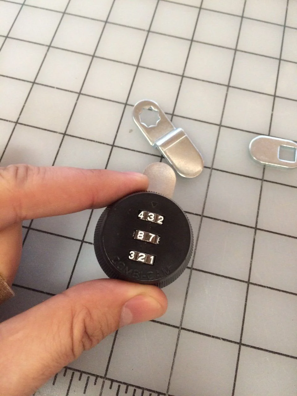

Just got the ComboLock in, man this is sucky. I'm sure it works fine but its too tall so it won't be flush with the lid so it will be exposed instead of hidden under a console liner. I'll also have to make a specific cam for it because it doesn't come with a height I need. Its Made in China which blows but its not exactly garbage, just not...well, nice. I need to hunt down other options if combo locks are that important to some of you.

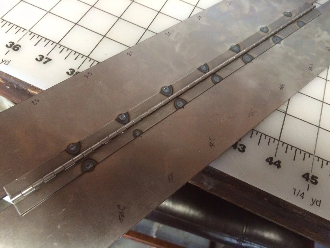

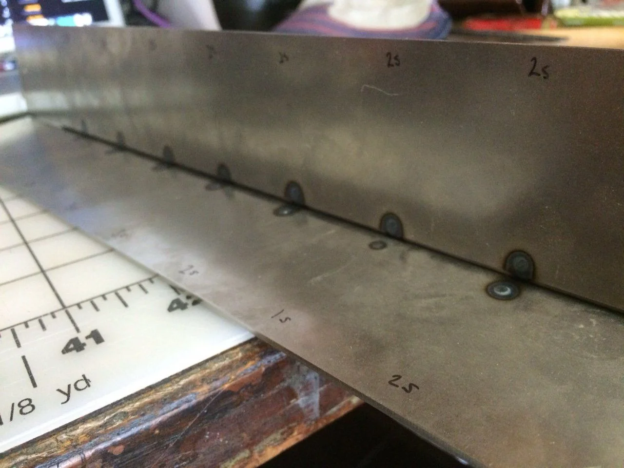

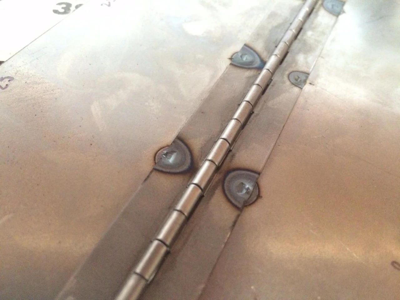

I also got in the hinge that I might be using. Now that I have it here I think I may go up a gauge or two and make it at least 1.2" wide wing instead of 1/4". I experimented with the spot welding a bit by changing up the timing and proximity to edge. I suppose I should do that chisel test but if I'm doing the hinge under the lid then there is no point doing that test.

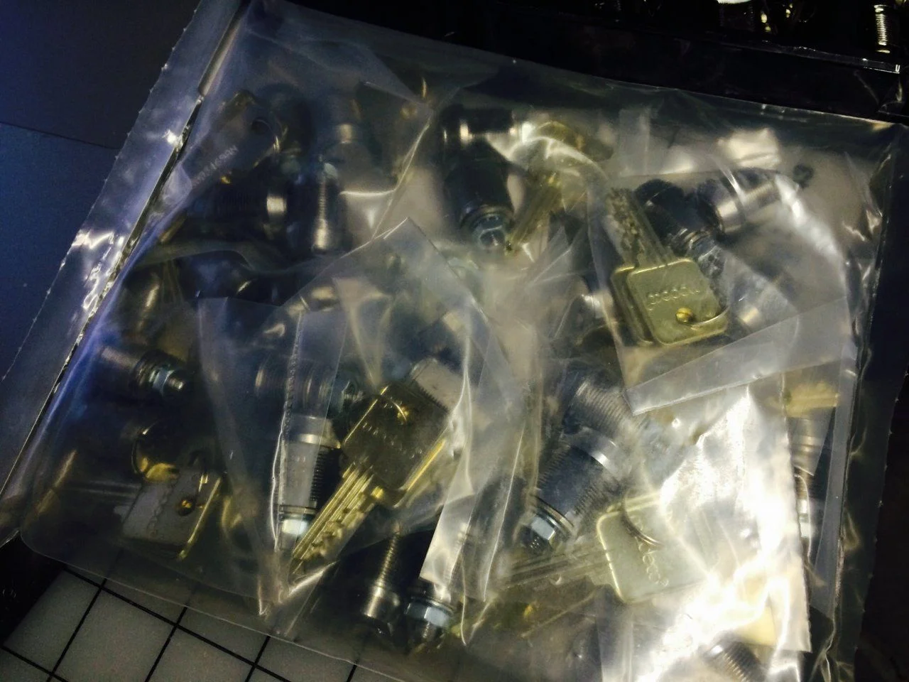

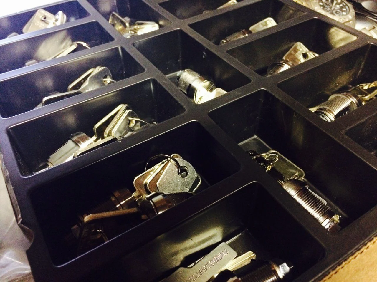

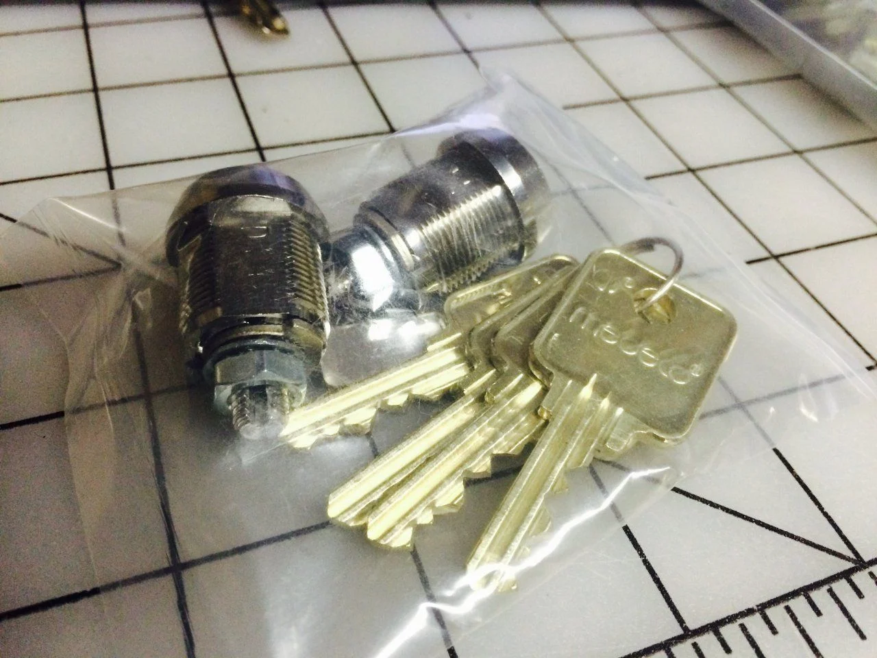

First, lookie what I just picked up!
Wanna see what $2500 of Medeco Locks look like? Ouch :(
The singles, the dual keyed-alike, the multiple keys, etc.

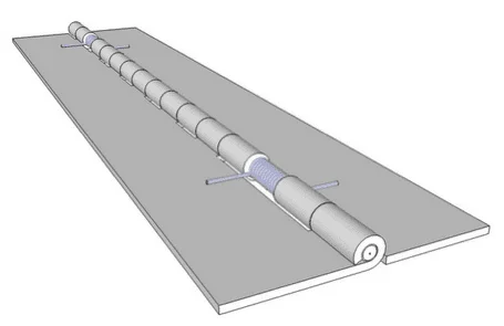

I was playing around with my mock-up and I got to thinking. Since the lid will be opening up and towards the back of the console (rear of the truck) I got to thinking about lifting the lid. No way in hell do I want to add a finger hole. I considered just using the key as the handle itself but then started wondering about the lid falling closed, especially if its on a decline. Not the end of the world and definitely useable. But I wanted something little more so I ordered up set up spring loaded hinges that are spring open. This way the lid stays open unless you want it pushed closed. I could also get spring closed that basically always tries to shut closed but I don't see that as being as useful. Since the hinges get spot welded AFTER the box and lid production I have some time to decide.

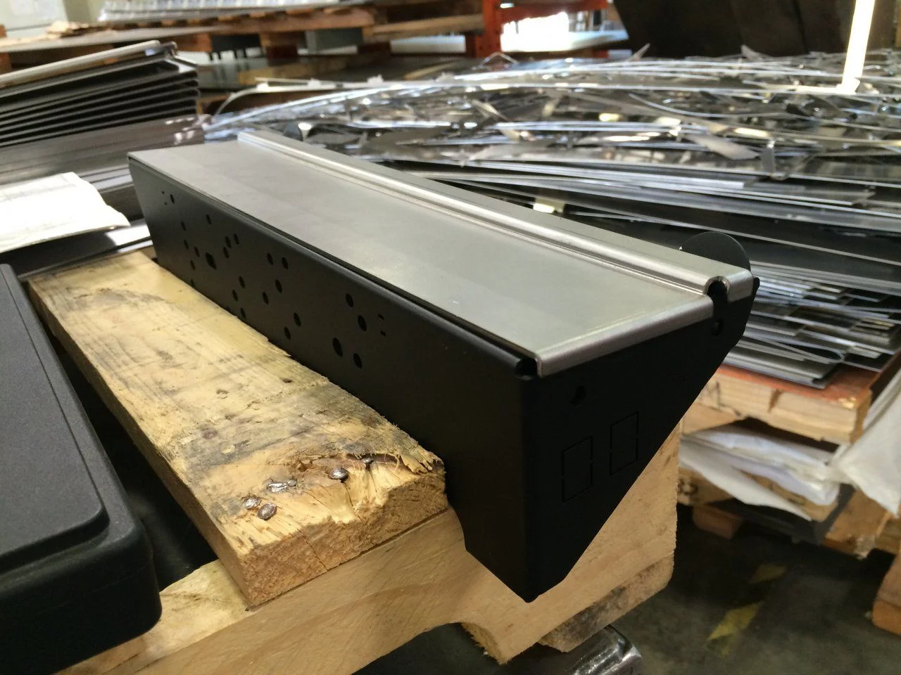

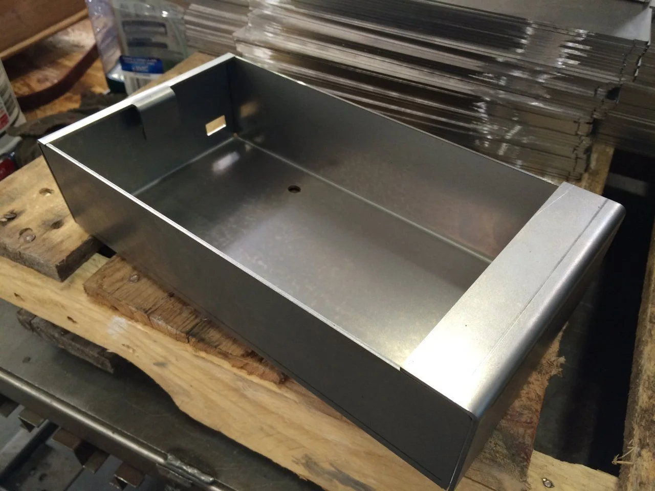

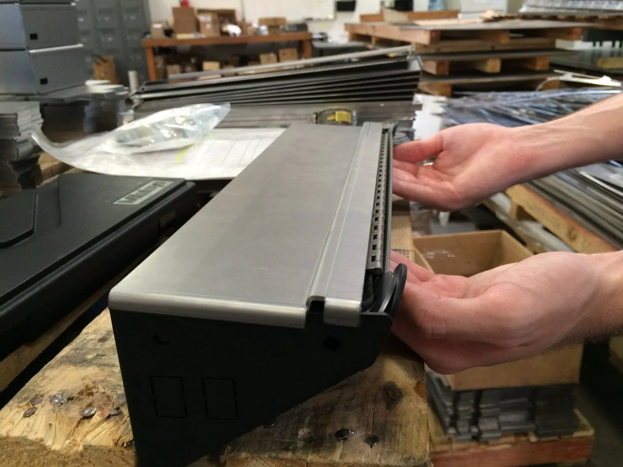

Alright guys, this isn't for the 60 or even 62 consoles...yet, but wanted you guys to see the progress on the 80 Series LockBox and LockingLid for the Fire Extinguisher Mount. After I finish making all of my mistakes on the 80 Series side then I will start the production for either the 60, 62 or 100 Series LockBoxes. I have to follow the cash flow so whichever I can get the more interest and orders (GroupBuy if I need to) then that is the LockBox that I put into production next.
