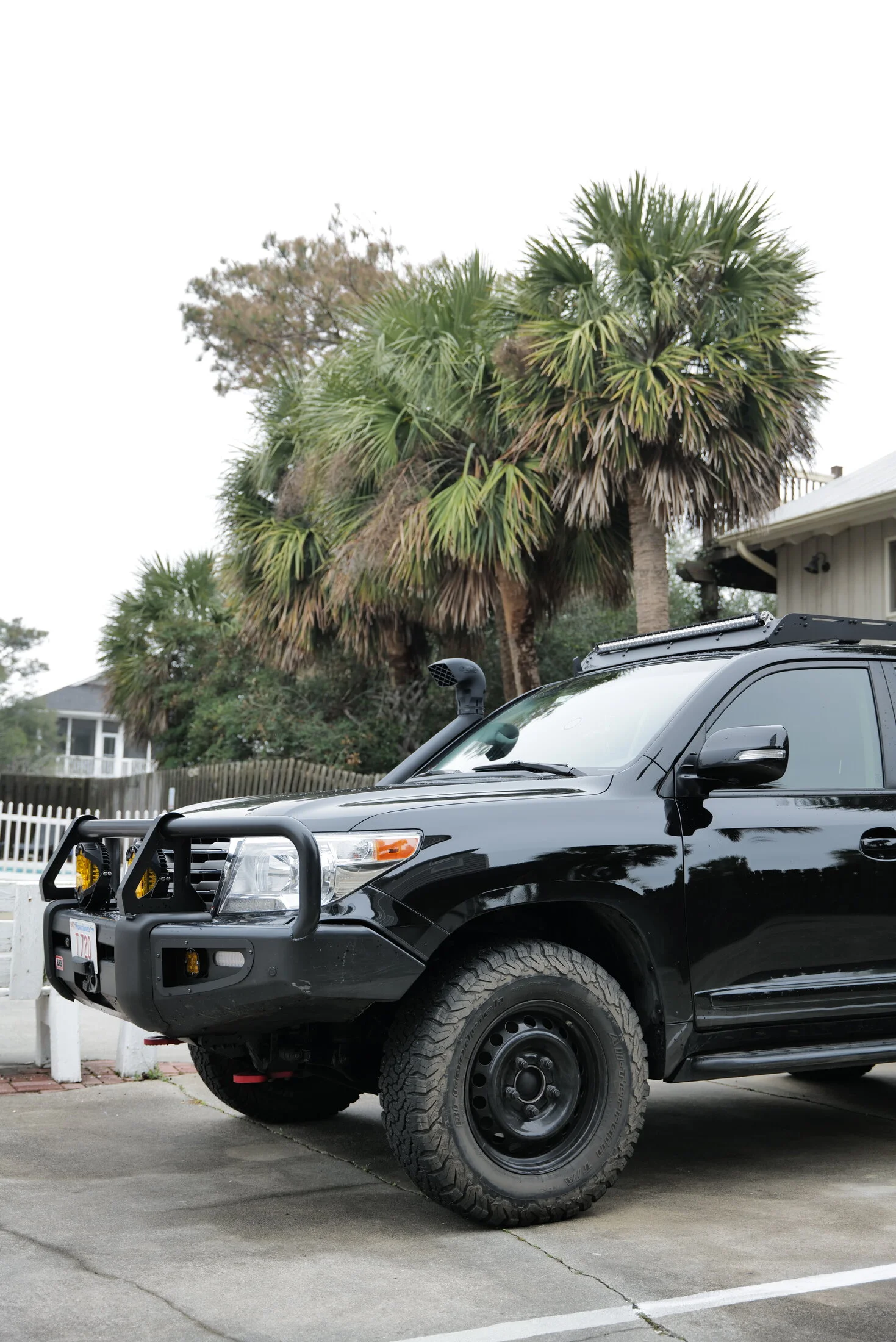

I bought some of the “bullet hole” style tundra steel wheels from Hubcap Haven years ago. Ran them for quite a while and loved them. They weren’t super expensive, and they come in the same size, width and offset as the factory wheels on my 2015. I refinished them in black prior to installing and ran them without the center/hub caps.

that looks killer, i suppose they are 265 75 18?

275/70/18, good versatile size. Worth noting that I was running these with the spidertrax 1.25in spacers
