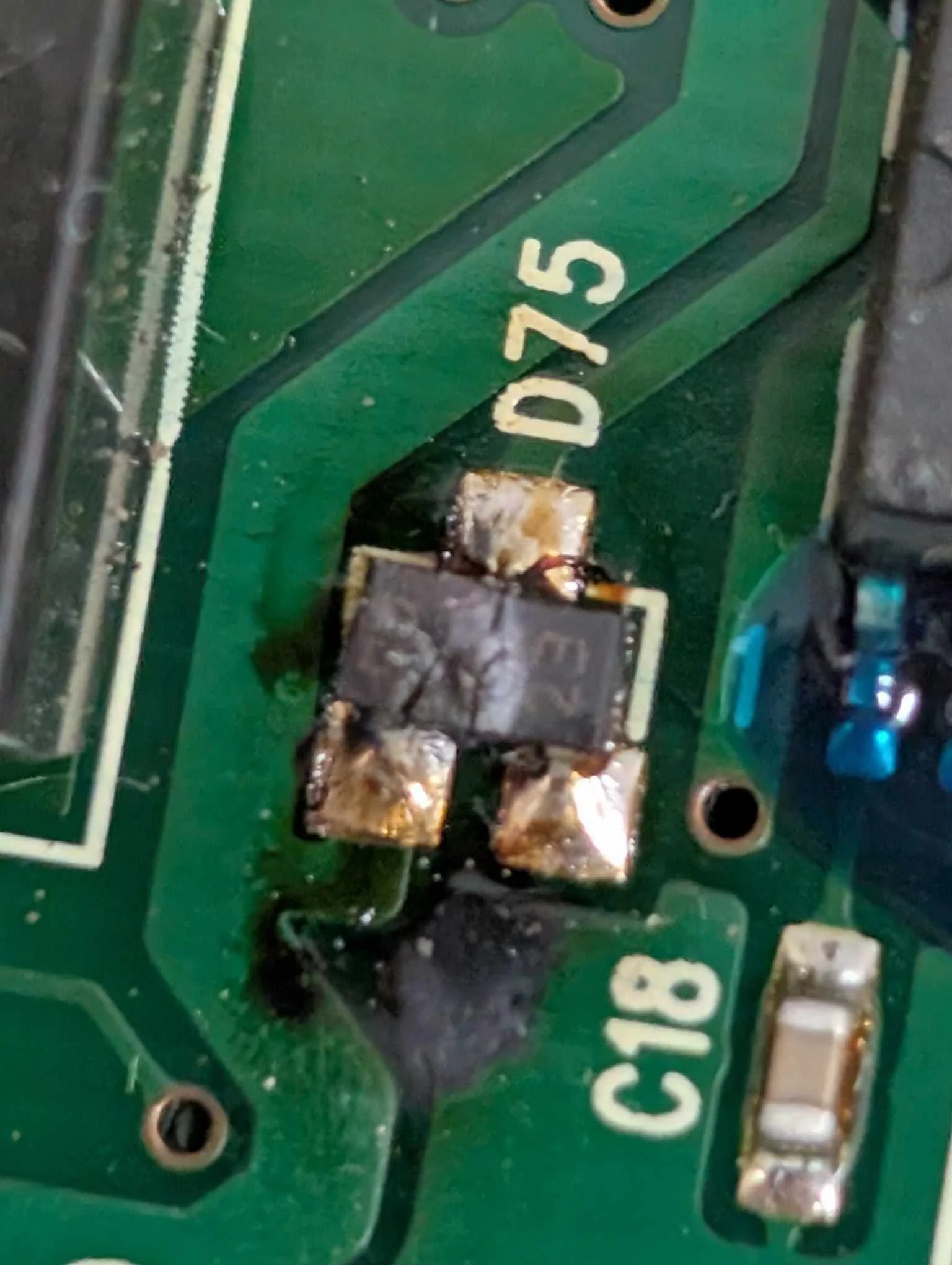

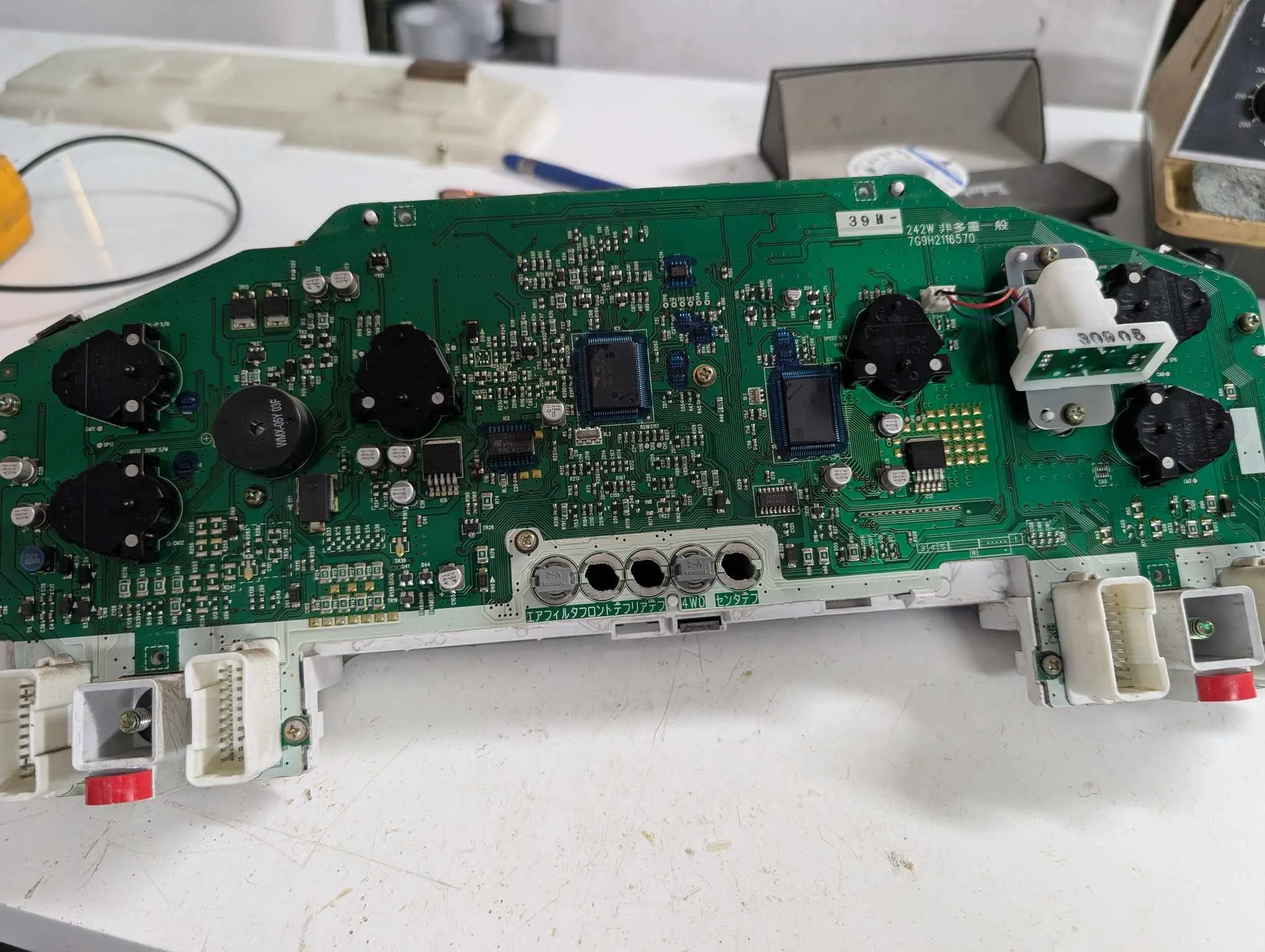

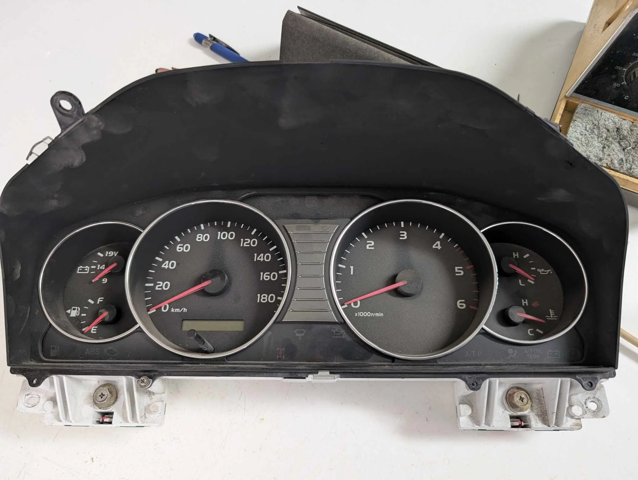

I just acquired a 2003 105 series cruiser (Aussie version). The battery, glow plug and fuel lights work, but no guages or odometer. Checked all fuses, then pulled dash out. Found a blown component on the board. I'm hoping/thinking its a 5v regulator. But since its blown, i can't read the part number.
Does anyone know the part number, or would any 5v regulator work thats the same physical size? Anyone have a photo of the board they can zoom in and see a part number or have a circuit diagram for part D75?
