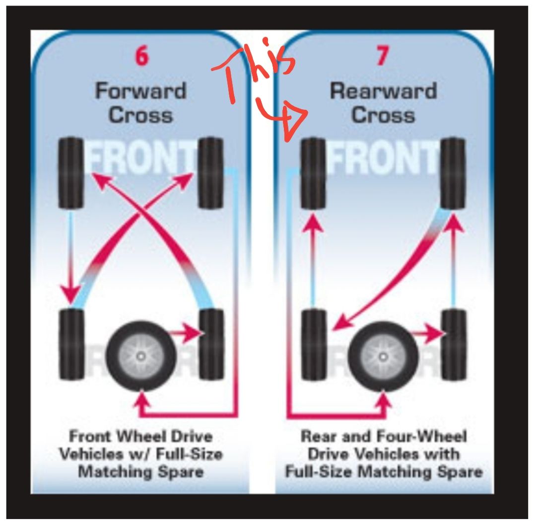

Hey, does anyone have a solid 5 tire rotation pattern that works well? Upgrading from stock wheels/tires to Evo corses and Wildpeaks and want to print out a solid diagram and keep it in the truck so I can hold the Toyota Techs hands when I bring in for service.

This is the rotation pattern I've been using...Others may have a better plan.

As long as you do the same pattern everytime, and the tires change sides and front to back each time, it doesn't really matter. I do:
Spare To Driver Rear
Driver Rear to Pass Front
Pass Front to Driver Front
Driver Front to Pass Rear
Pass Rear to Spare
Sometimes, if my rotation has been inadequate, or I'm starting to get uneven wear I'll rotate the best tires to the front, preferably opposite side from where they came from to reverse any cupping of the tread, then put the worst in the spare spot and the others on the rear. I'm about to have to do a "Targeted" rotation on my Duratracs because they're looking a bit uneven in the front since the last rotation 6k miles ago.
I've also been using the TireRack 5-Tire Rotation for Rear and Four-Wheel Drive Vehicles with Full-Size Matching Spare for 6 years now - very even wear:
HTH
HTH
I do this one as well. I have averaged 1mm of wear per 6k miles. This is on Les Schwab M/T terrains. I believe Cooper makes them but don't know for sure.
I do the four tire front to rear rotation, but every third time I X them. I will get 80+K with this rotation, have done it in the past with BFG AT KO’s
Interested to see what the collective thinks best.
This one (#7) is excellent. And also used by @gaijin, so it's good enough for me. I have used this for many years on all my AWD vehicles that have a full size spare.

I also use the rearward cross.
