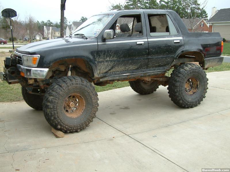

We choped the top of a friends 4runner back in the day and definately helped to clear trees better on tight trails or side hills. Its funny that when he started this build 15 years ago "Fort Knox" was the inspiration for a lot of the mods. I'm sure the same could be said for a lot of 2nd gen builds, it is an institution.
Looks Awesome!
Do you have any pics of that project as it was going together?
