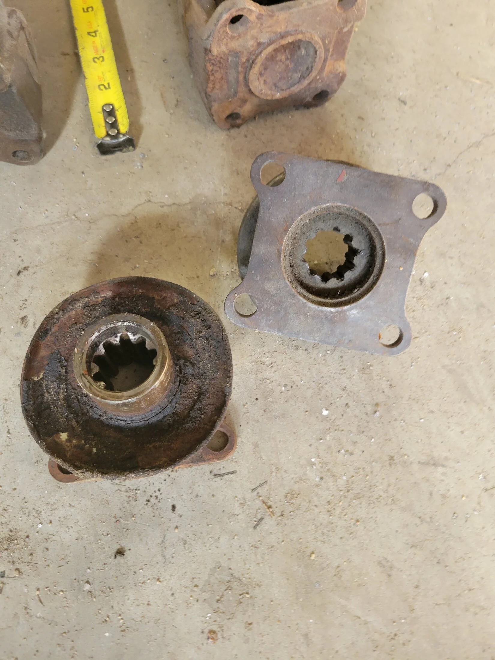

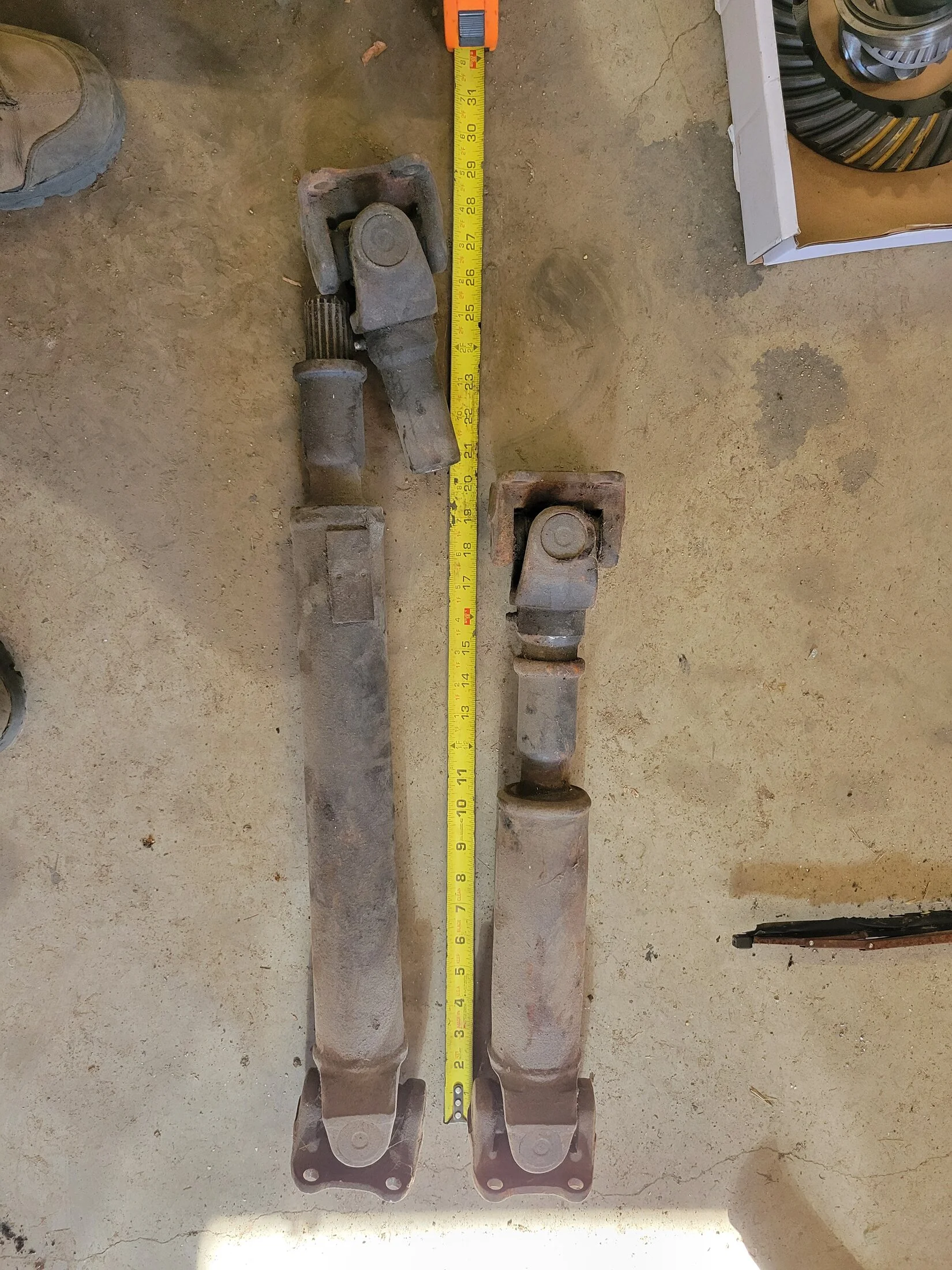

Putting a 4 spd in my ‘71 40, with a 3 spd TC.
Keeping the 3 spd brake drum.
Looking for a couple of 4 spd drive shafts to allow me to shorten the rear and lengthen the front on mine.
Need pinion flanges as well if anybody has those used.
Thank You
keep in mind the transfer case flanges will be different pattern so you will want to reuse your 3-speed driveshaft yokes on the 4-speed driveshafts.
4 speed shafts and coarse spline 4spd flanges.
Pm if interested
Thanks
Got those from cruiserland
