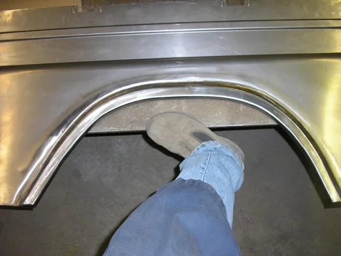

Here's a shot of my welded on wheel arch rib before an 80 grit flapper disc on a 5" Walter variable speed grinder set at speed 5 (out of 6). Someone mentioned keeping it flat and not gouging - a must.

Also, when you think your flapper disc has about had it - keep going. I find they last longer than you think. Another point to consider is that a new disc will remove material faster than you think because you were used to the old one you just changed out.
