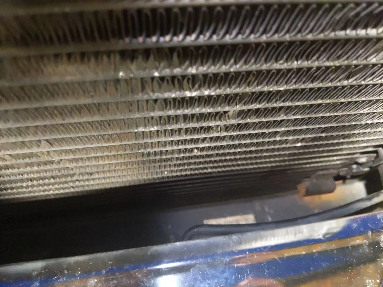

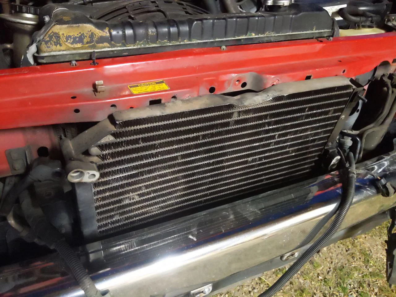

I'm having issues getting the new condenser in. Getting the old one out, I had to pinch down the top row of material to get it to clear.
It seems like if the radiator was loose, I could get it in. I think it has to go below the tabs on the condensor, get under the top crossmember, and then it can be pulled up and in place. Getting the radiator loose is tricky. I can only easily get at the top two bolts, and even with those loose there's still not really any more room.
Could anyone advise me on this? Thank you!
Seems like the FSM just says it should go right in and out. I'm wondering if something is bent, but I'm not seeing it.
