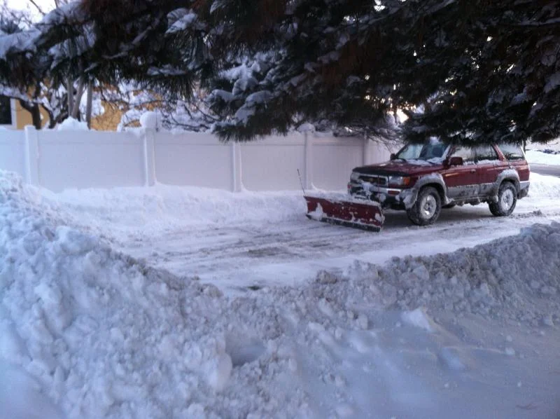

I made a snow plow a few years back for my 4runner. https://forum.ih8mud.com/95-gen-toyota-trucks/439163-3rd-gen-4runner-homemade-snow-plow.html Had a number of issues with the original plow A-frame and have since totally rebuilt it a LOT stronger with regular snowplow springs. (I used to own a snowplowing business, so I can completely understand the shortcomings of this, but I don't think the 4runner is up to the task of a fully size commercial plow.)
We got a good snowfall this weekend and I put her to work. Took a couple pics of one of my buddies driveways I plowed with it. The old girl does a pretty decent job for a lightweight SUV with a home built plow.

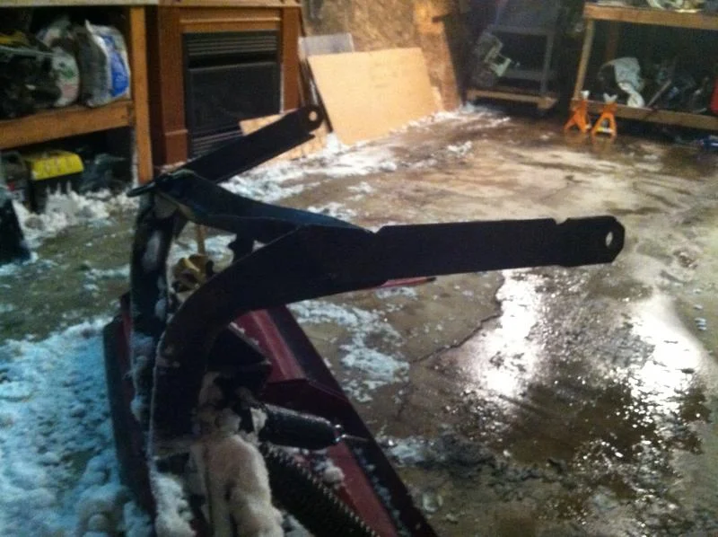

So... another big snow fall at my place and I bent the piss out of my home built A-frame for the plow. Using a custom built front receiver I really wanted to keep the mounts tucked up as high was possible. Most if not all commercial plow sub-frames hang low - for a reason - they push relatively level to the ground against the blade. Then when the blade hits and obstacle the force is more or less straight forward. On my set up the force was down at a relatively steep angle, so when tripped or just against a really heavy pile, the plow blade is pushed down and the weight of the vehicle is pushed up onto the frame. This is bad for light weight framed plow...
This will be the third iteration of the skinner plow. The first was simply too weak and folded after just a couple uses. This one lasted two+ years. I think the next one will be even better - and almost as light weight. I'll post pics when it's ready for prime time.

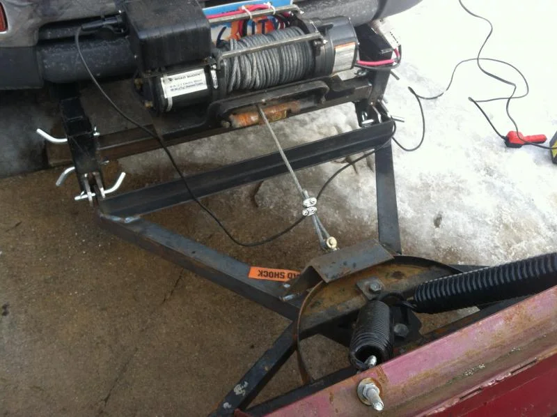

New plow setup. Push angles are MUCH better, and it remains almost entirely removeable.
I redesigned the front hitch - added two new receiver tubes on the outside. Then I added two drop hitches. From there I cut 1 face off two lengths of receiver tube and drilled them to match the drop hitch. I added a cross beam to stabilize the two sides and then a couple tabs are put on each side to push. Now I can adjust the push height. We'll see how well it works.

Works great. Much much better than the old setup. The push angle is really important to keep as level as possible. The new adjustable drops allow me to get a lot closer. Before when the blade tripped the downward angle of the A-frame would get steeper pushing the plow into the ground and the 4runner would want to climb up on it. Plowing over something like a shallow gutter was required me to lift the blade. With the new setup it acts just like a commercial plow. Follows the contours of the surface and trips just enough to go over the obstacles, but doesn't bind up. It's a lot less stress on everything.
When you're getting closer to building, PM me and I can give you some better pics of everything and measurements. This was just a light weight toy for my driveway compared to pro plows. But it works good enough for my current use. When in doubt about a particular design element I've tried to generally mimic design choices by the pro commercial units only lighter weight.
