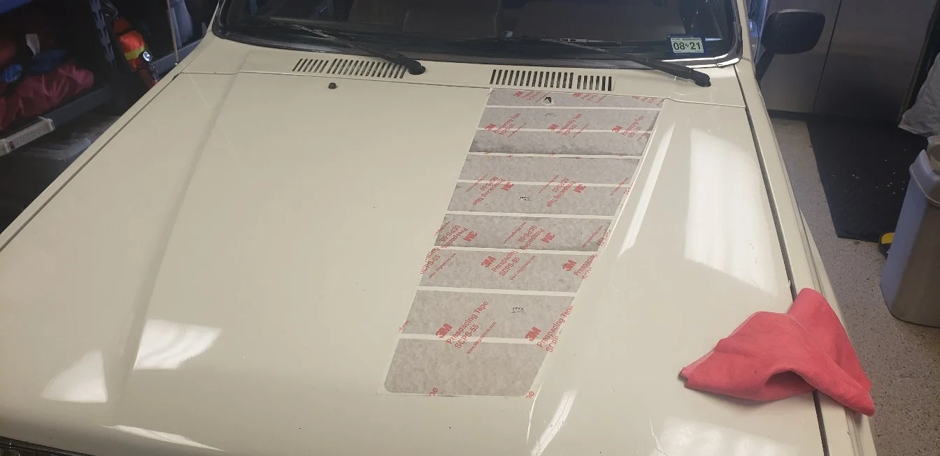

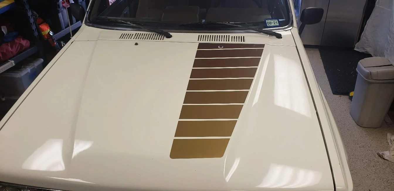

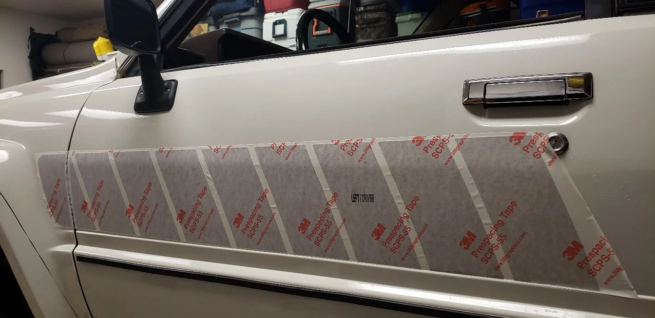

I went with James Dean Creations graphics, the more I researched, the more I was led back to them.
They make a quality product using 3M materials. I am very happy with their product. It took me years to learn "pay once, cry once"

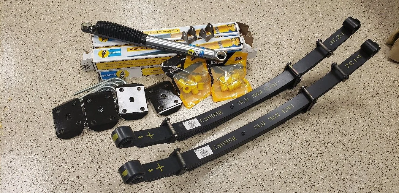

Hijack... What suspension are you running?

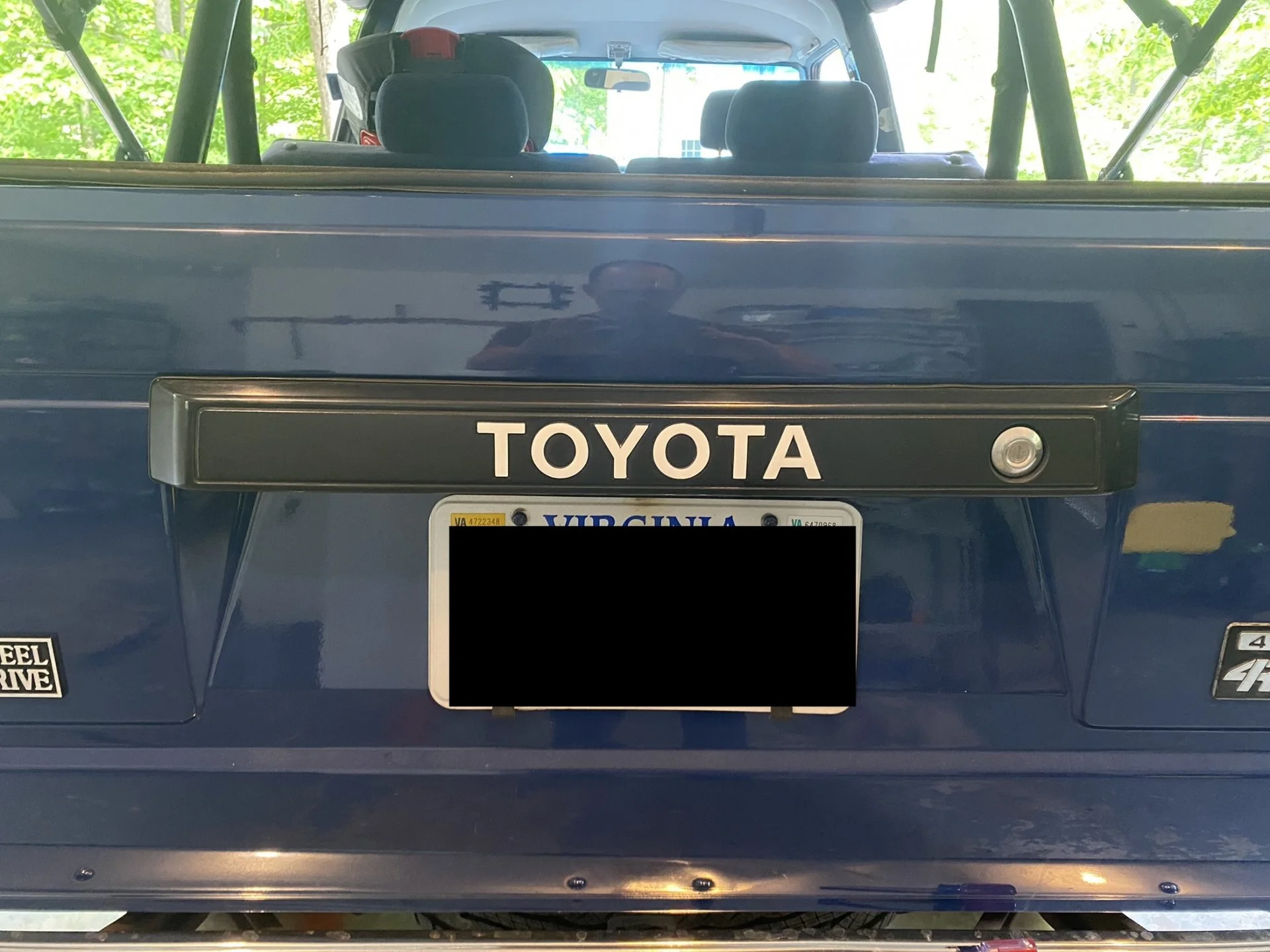

Also... I added some vinyl overlays (wet application) to the tailgate trim instead of painting... just to try it for 10 bucks, and so far I'm really pleased.

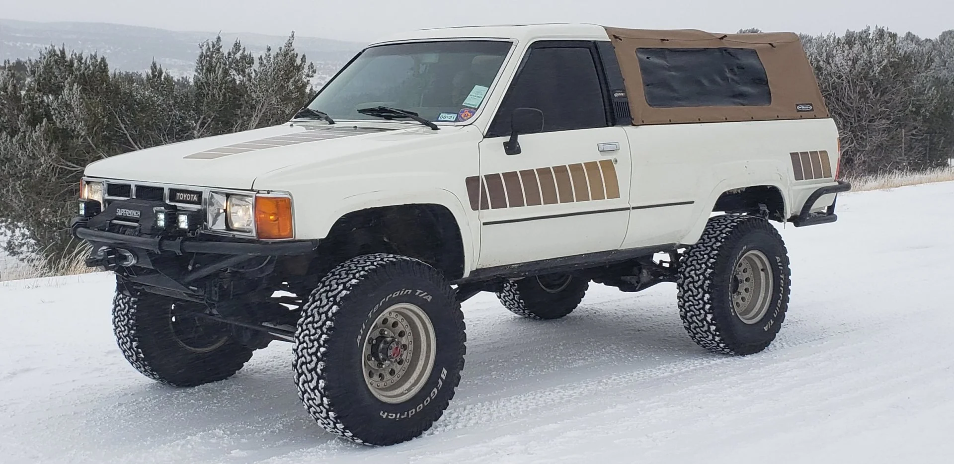

Old Man Emu medium duty springs & Bilstein 5100's.. 🤙🏼
Nice!. I'm worried about being too high in the back. Nearly same setup... softopper, rear bumper (4xinovations), and I'm building some drawers, but not huge ones... just some lockable 1/2" toolbox drawers... I only run 31s. Yours looks great! Any chance you could get me a top of rim to bottom of fender measurement sometime? Mahalo!
Measured from center of axel to the lip of rear fender.
Pre: 19.5" (worn out stock & add leaf)
Post: 23.5" OME's 🤙🏼
I'm running 32×11.50 r15
That’s way too big of a lift in the back for me. I’m looking for 20.5 maybe 21 at the most. I’m at 20.5 now with an add-a-leaf, but it’s from PO and it’s worn out.... not a great ride. But 23.5 is like 4+ inches over stock. That’s just too much for my goals. The search continues.... I’ll probably have to find a spring pack and remove leafs and what not. Thanks for the info!
