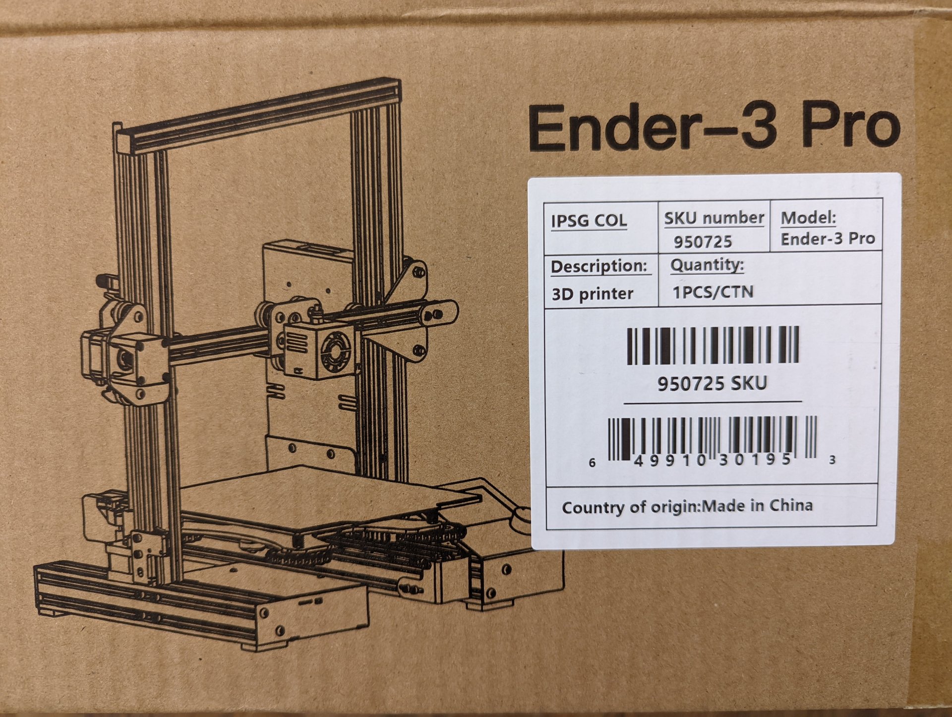

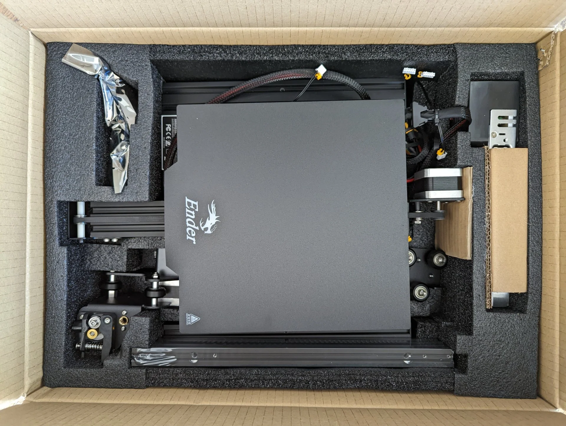

Well, I made the drive down to Parkville, MD this morning (the closest MicroCenter to me, about an hour away). Their website said they had 25+ in stock, but had a stack of more than 200 of them in one of the aisles. Picked up the 3D printer, a box of filament to get me started, and a "3D Make & Print" magazine that caught my eye while checking out.
I asked a guy I know who has some experience with 3D printing about the Ender 3 Pro. He actually has an Ender 3 and showed me some of the prints he has done with it and I was suitably impressed. At $100 it really seemed like a no-brainer.
George gives a good overview of what this guy told me - create the STL file, slice it, and load it into the printer - and play around with it to learn what you need to do.
I'll get it set up and let you all know how it goes.

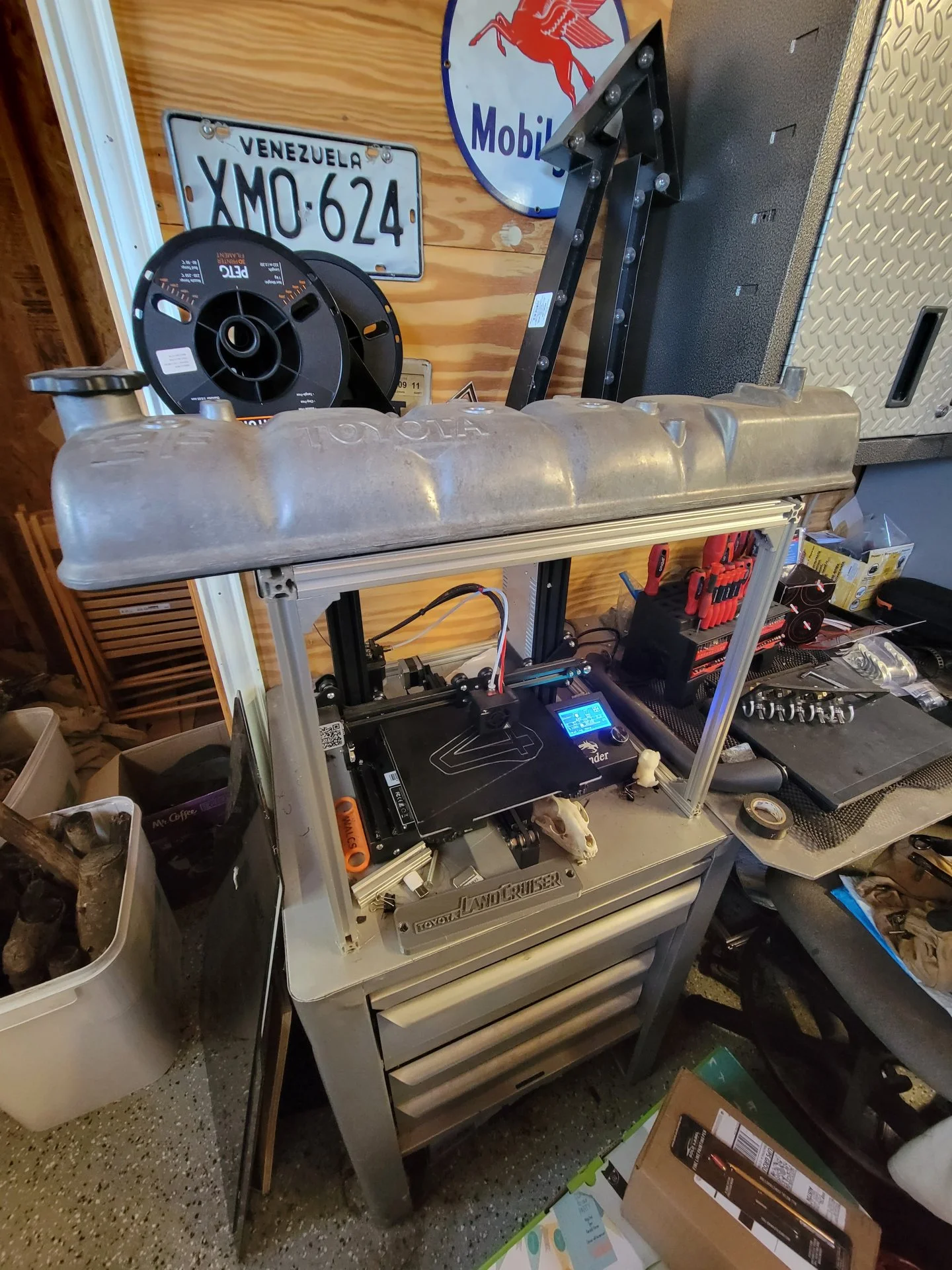

I am pretty impressed with this printer. It has been easier to just print, but harder to interpret the results.
The printer will come with Creality Slicer on the SD card that is included. I am getting much better prints with PrusaSlicer.
Thingiverse.com has been my go to for interesting free designs.
