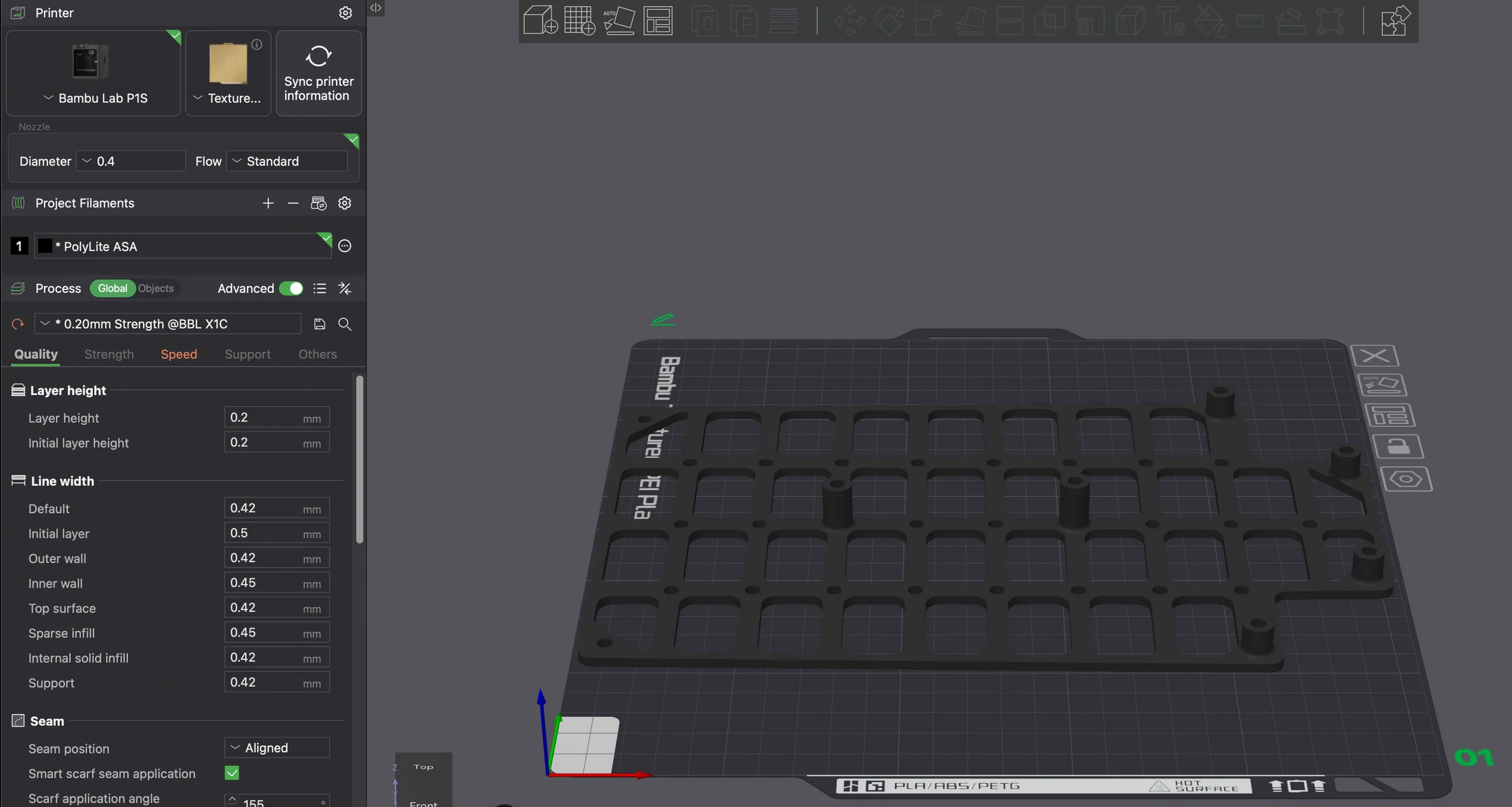

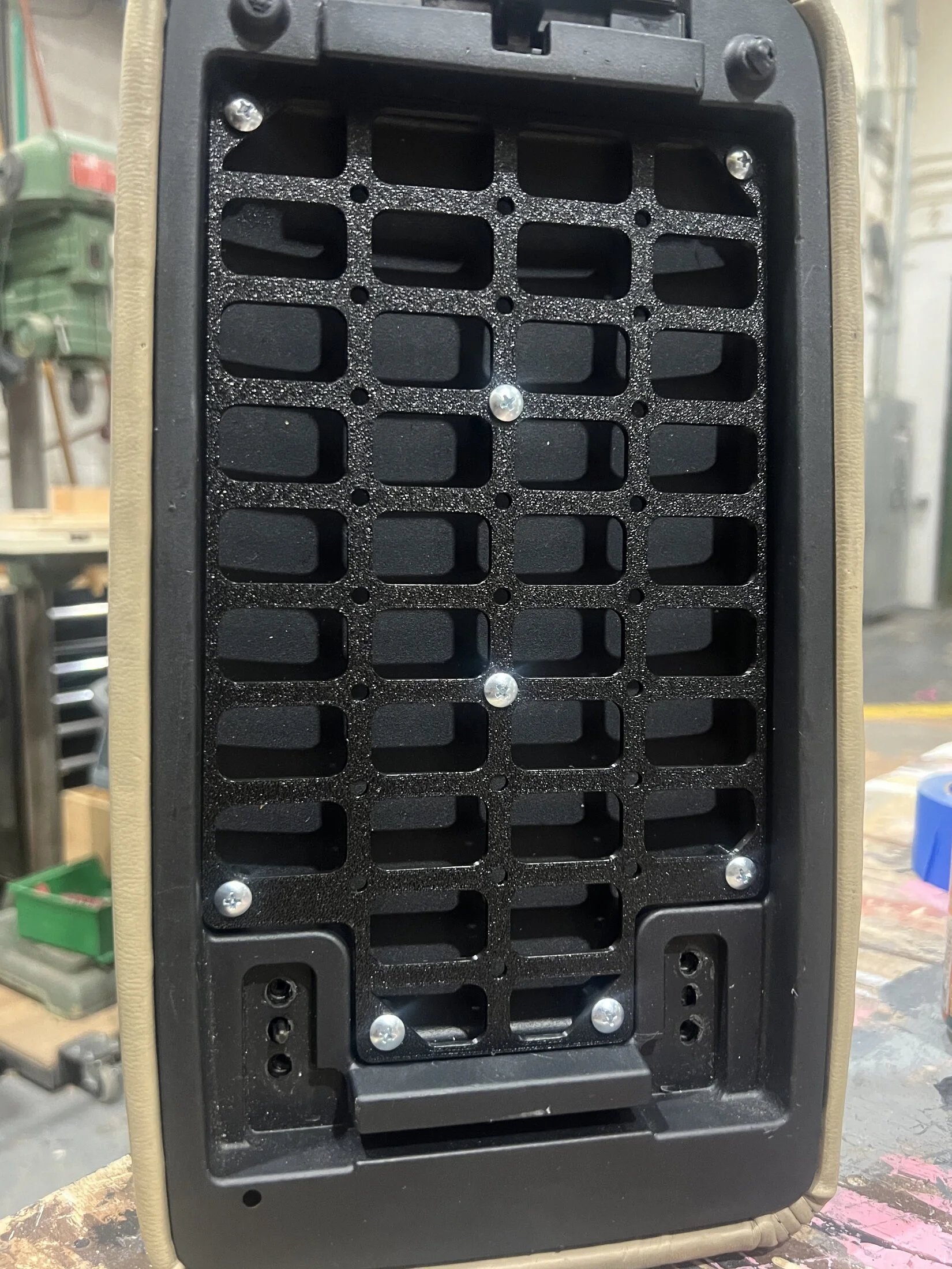

Hey all, I posted this storage panel I made on the What have you done to your 100 thread, and some people asked for the file, so I've uploaded it to MakerWorld.
Here's the link - MakerWorld Land Cruiser 100 Center console storage panel

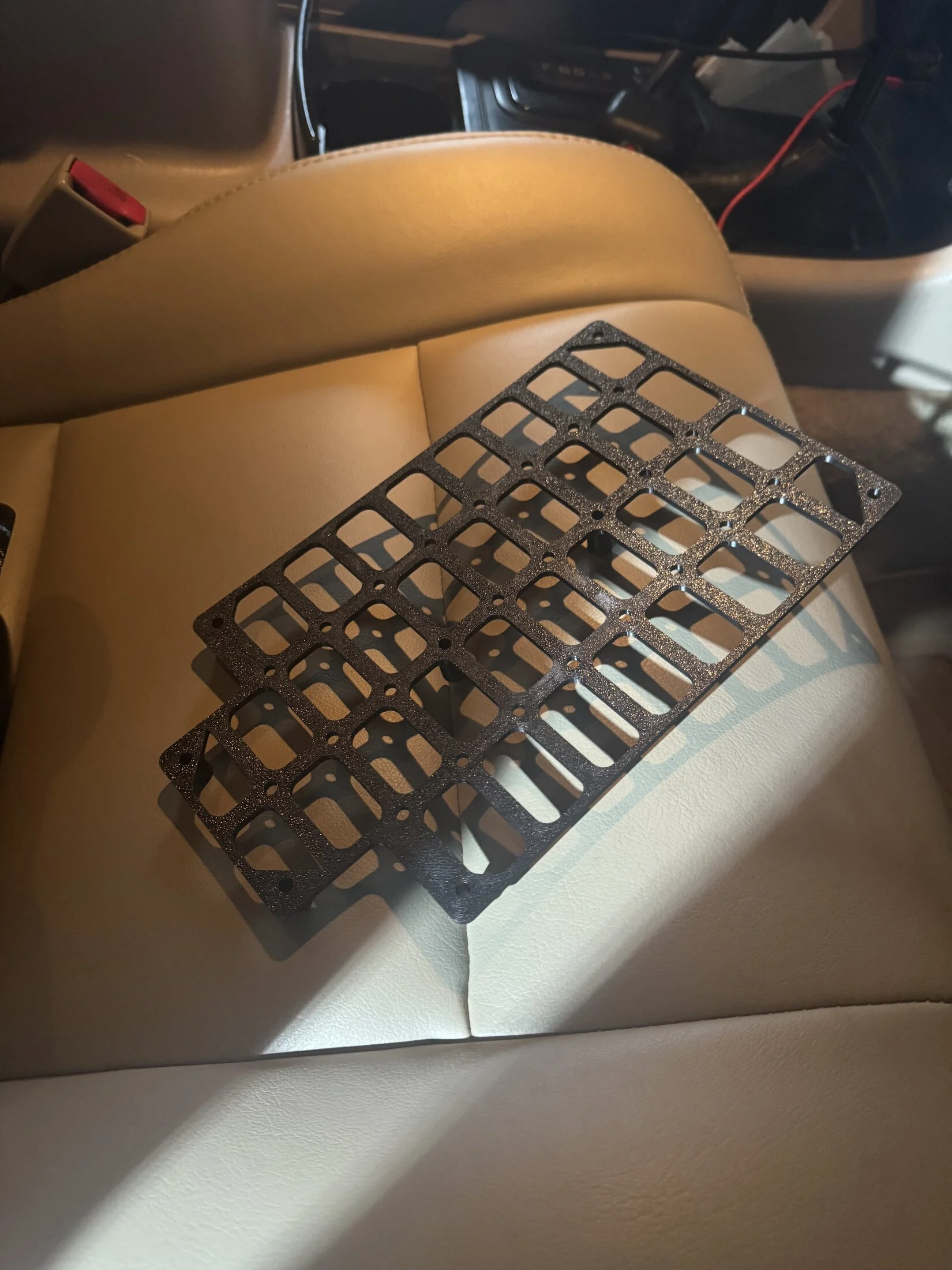

I printed it in ASA and designed it with ASA's shrinkage in mind for a better fit. It's about 1/8" thick and slightly raised up, so it should work fine with most tools that have pocket clips.
Hardware used - (6) 1" Sheet Metal Screws & (2) ½" Sheet Metal Screws
My 2000 Land Cruiser doesn’t have the cup holders built into the center console lid, so I'm not sure how well it fits onto ones that do.
Any feedback is appreciated, and I can make future changes if needed.

This is sweet. I have this old thing about the same size that bungee type webbing and was going to use that. But this is super cool.
I also like the little socket set you have
