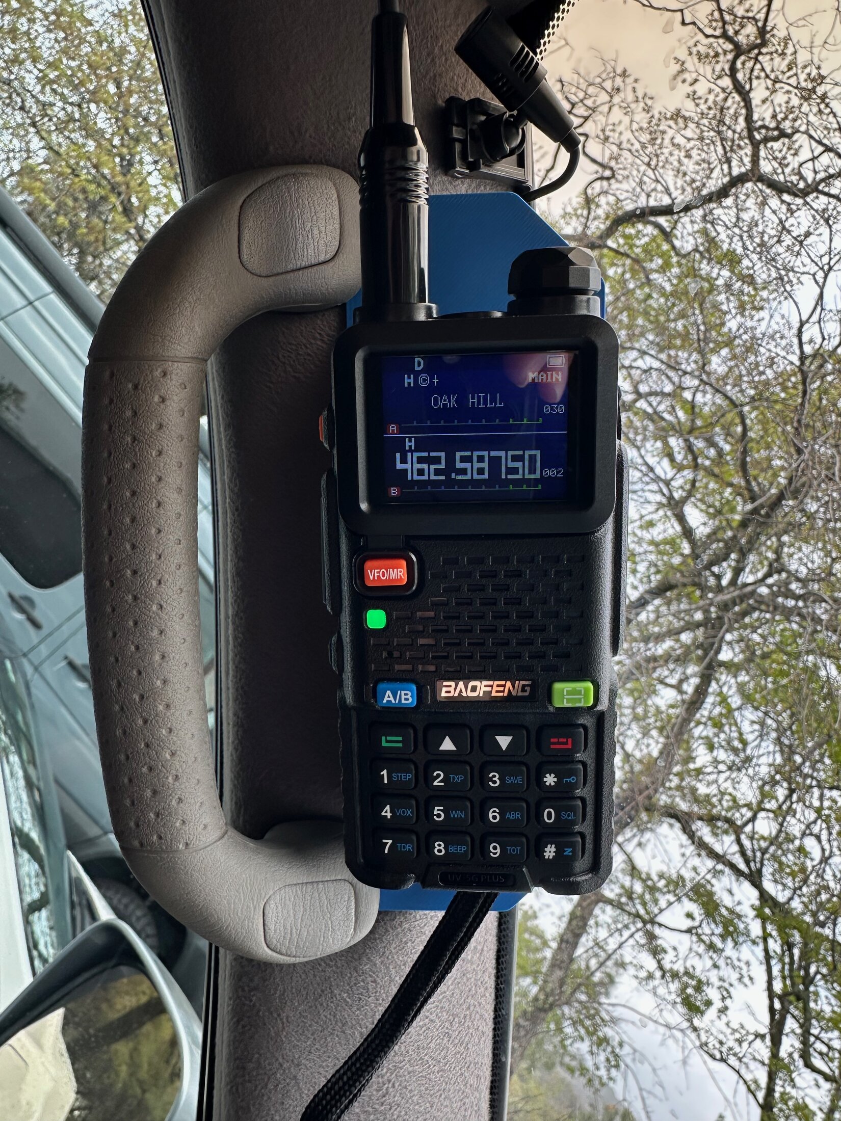

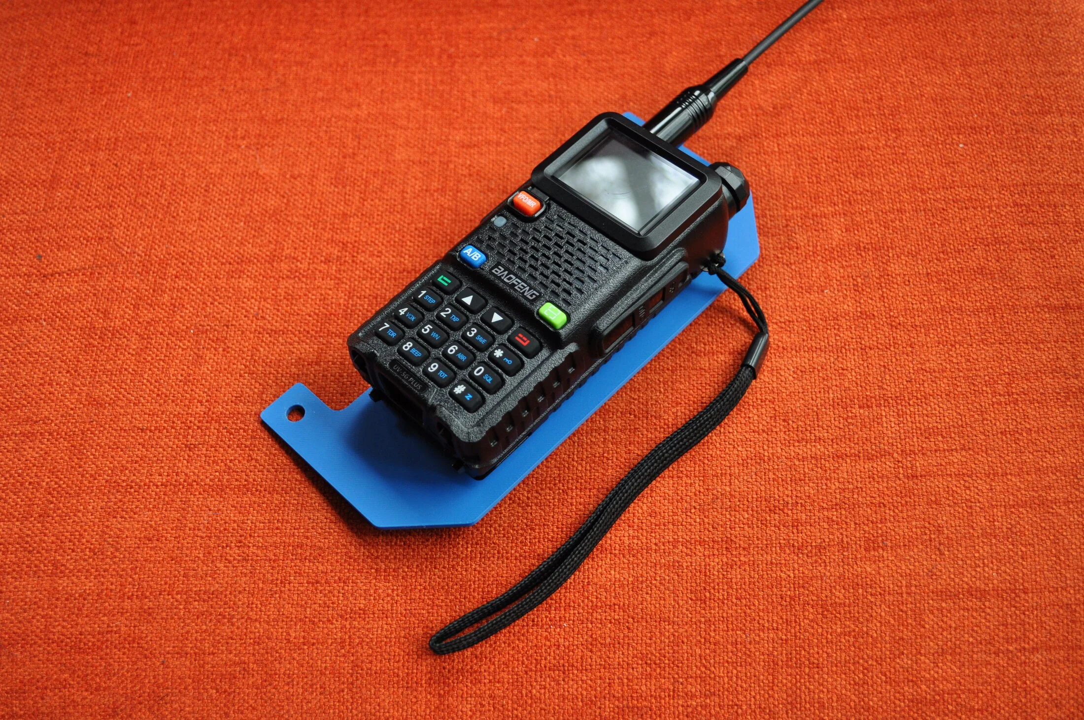

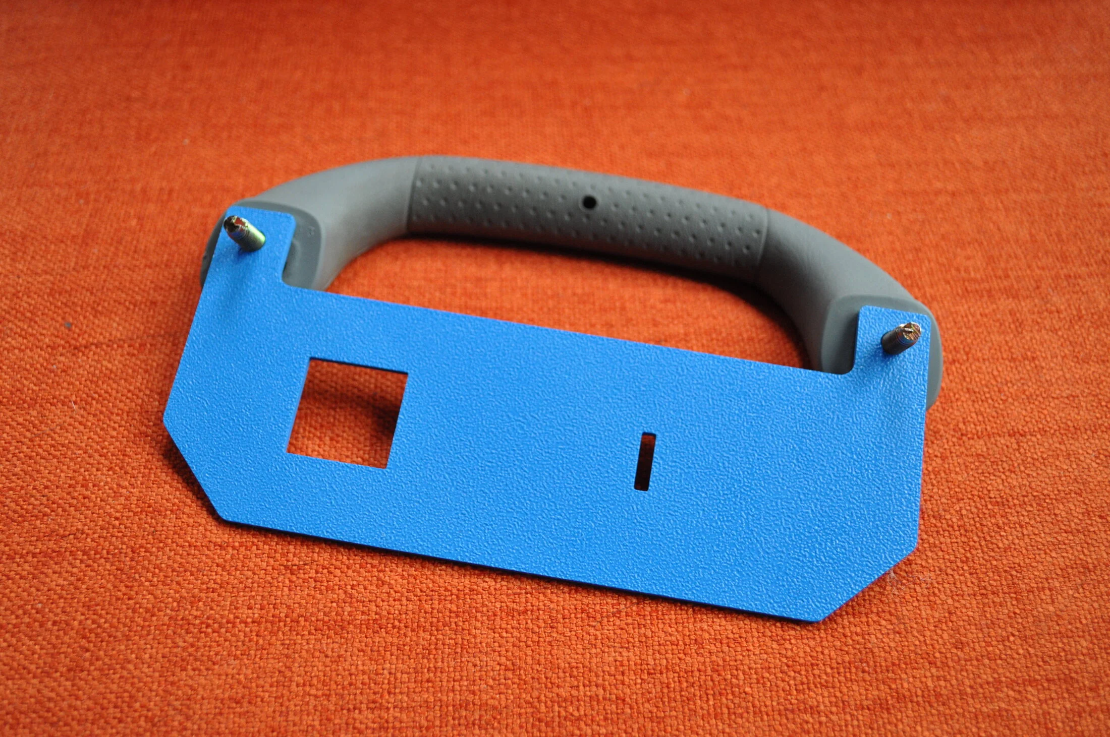

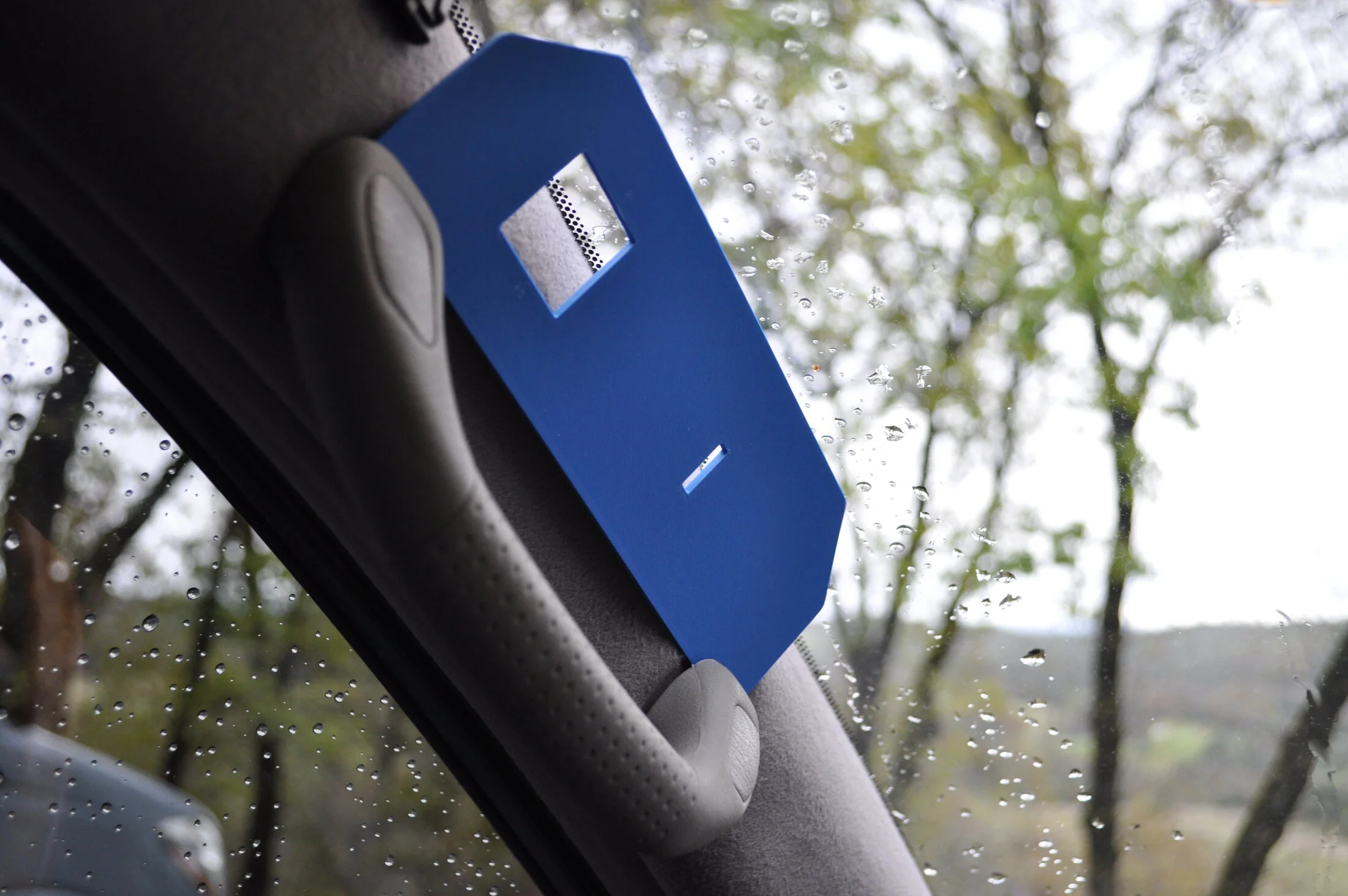

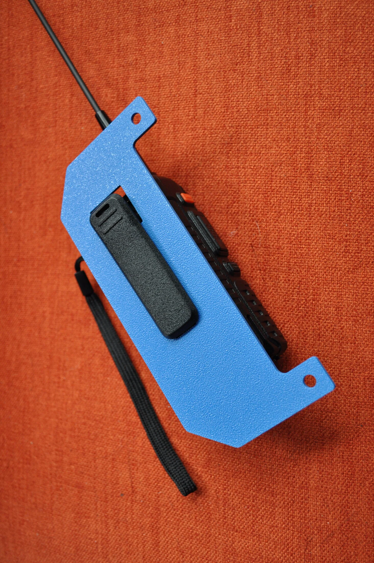

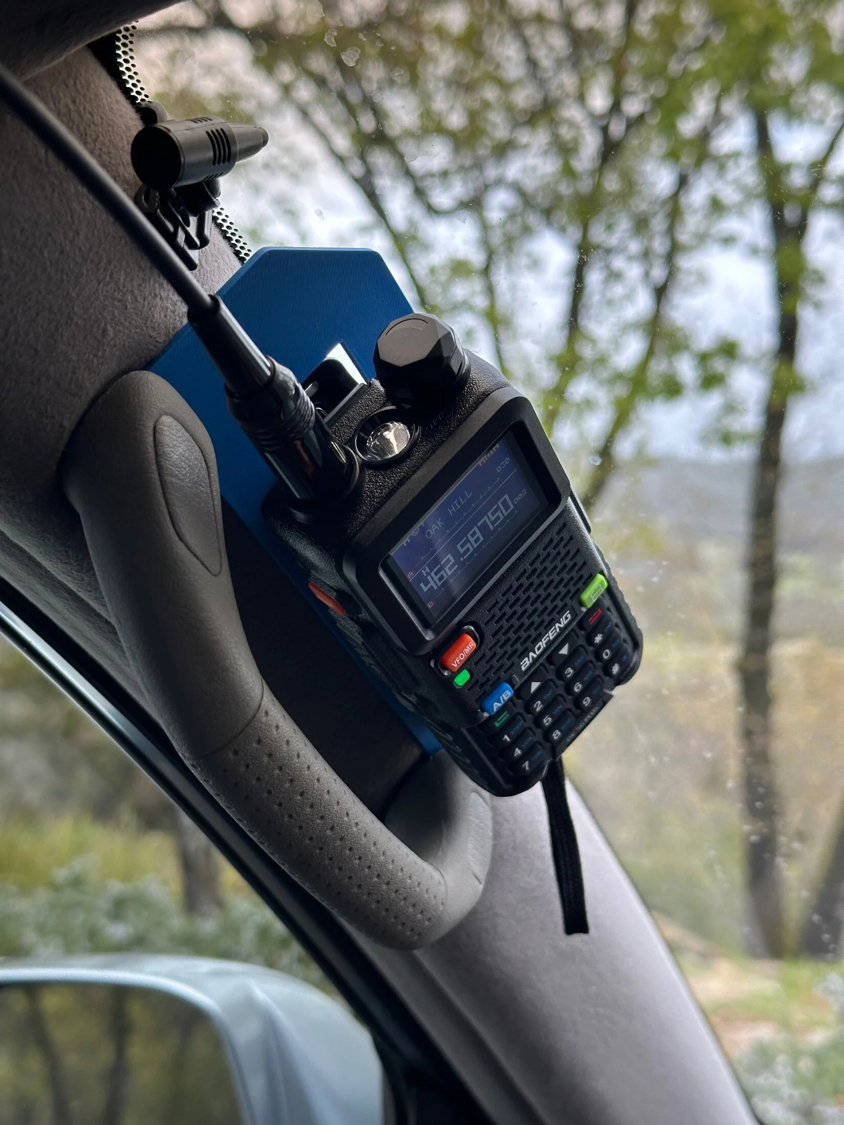

I got a Bambu Lab P1S and have been learning Fusion 360, so I needed a project to design and made this holder for my Baofeng radio. It uses the the belt clip to hold it to the mount and the small slot holds the bottom part of the clip in place.
You already have 1/3 of the ingredients for this recipe, the other two are a 3D printer and a Baofeng radio with a belt clip!
I made it for our 2003 LX and wanted to share with the group if you were looking for something to print that only takes just over 1/2 hour.
To remove it you might need to place your index finger over the back to press on the top of the clip so the bottom releases, but I have also been able to just lift up at the base of the radio and pull towards the top of the mount and it releases!
I think it is best to print it in PETG, ASA, or ABS for the conditions our rigs often see!
Thanks for looking, and if you print it, thanks for printing!
