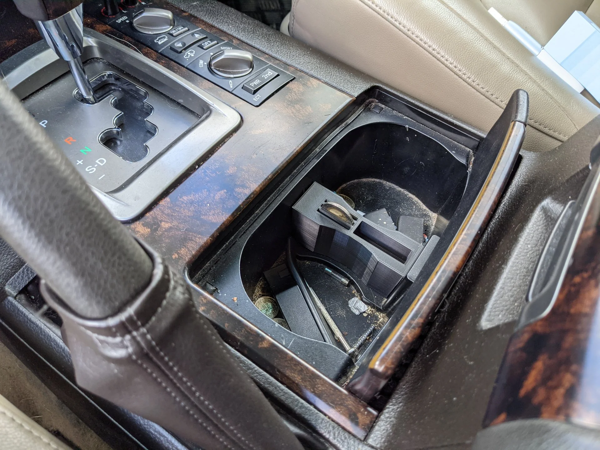

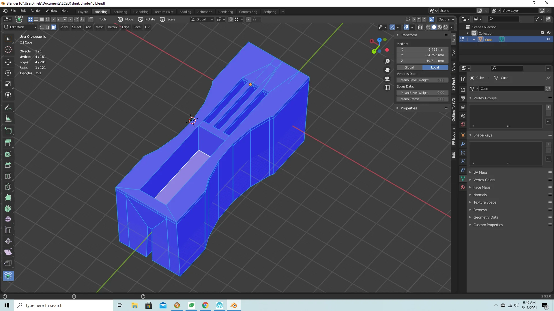

Hey all,
I am working on a 3d model of the drink divider. The Toyota version is fragile and after spending 45$ to get a replacement, only to see it break within 2 months, I decided to make my own.
Below is a photo of the model:
I decided to add some coin slots because that's personally useful to me. But I'm curious about your thoughts and suggestions so I can incorporate them in the model. I've given myself 2 more weeks to improve this version before releasing it for free (this thread and on thingyverse)
Question: the original divider has little arms you can use to stabilize drinks. I'm not sure I can make that but if you think this is critical then I'll give it a shot (more like 25 shots) to see if I can make a version that has it.
All feedback welcome but please note that I'm not a 3d modeling expert so there is a chance this is the best I can do. I'll share a picture of a printed version installed later today or tomorrow. It fits perfectly, tight but still removable.

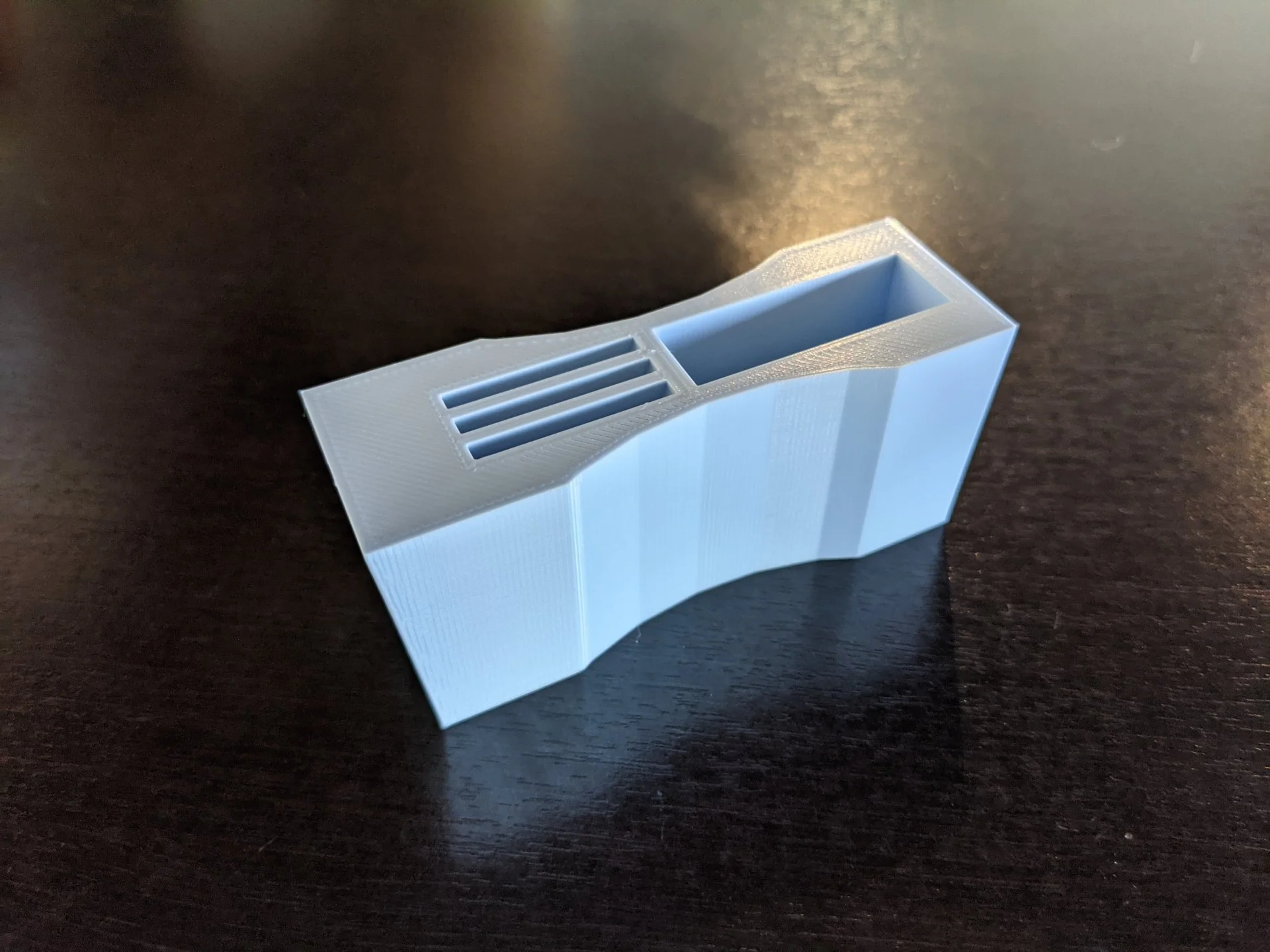

Cool project and nice of you to share the output with the community. One thing, and you probably already know this, but make sure you use a heat stable plastic. My son 3D printed me a great adapter to hold a coffee mug out of PLA (?) and in the summer heat it shrunk down so my mug didn’t fit anymore.
Whoa that is really good feedback. I only got a 3d printer 3 weeks ago and still need to learn about all the different materials. Currently I print everything with PLA which I now know is a problem. I'll look into the materials and hope the print tolerances stay the same (because right now it fits perfectly).
Btw here is a photo using light blue filament.
Anyway thanks for the good feedback!
Ps. My cup holder fit like a glove until a hot sunny day, and then it shrank. At first I thought my son was pullling a prank by putting a smaller part in the console, but he didn’t. I think he said ABS is better in heat, but don’t quote me on that, I may have it wrong.

I published the STL for the current version here:
I will think about adding drink support and I will take into account the suggestion from @PabloTX to offer different models for different drink sizes (thanks for posting the size of your cup)
