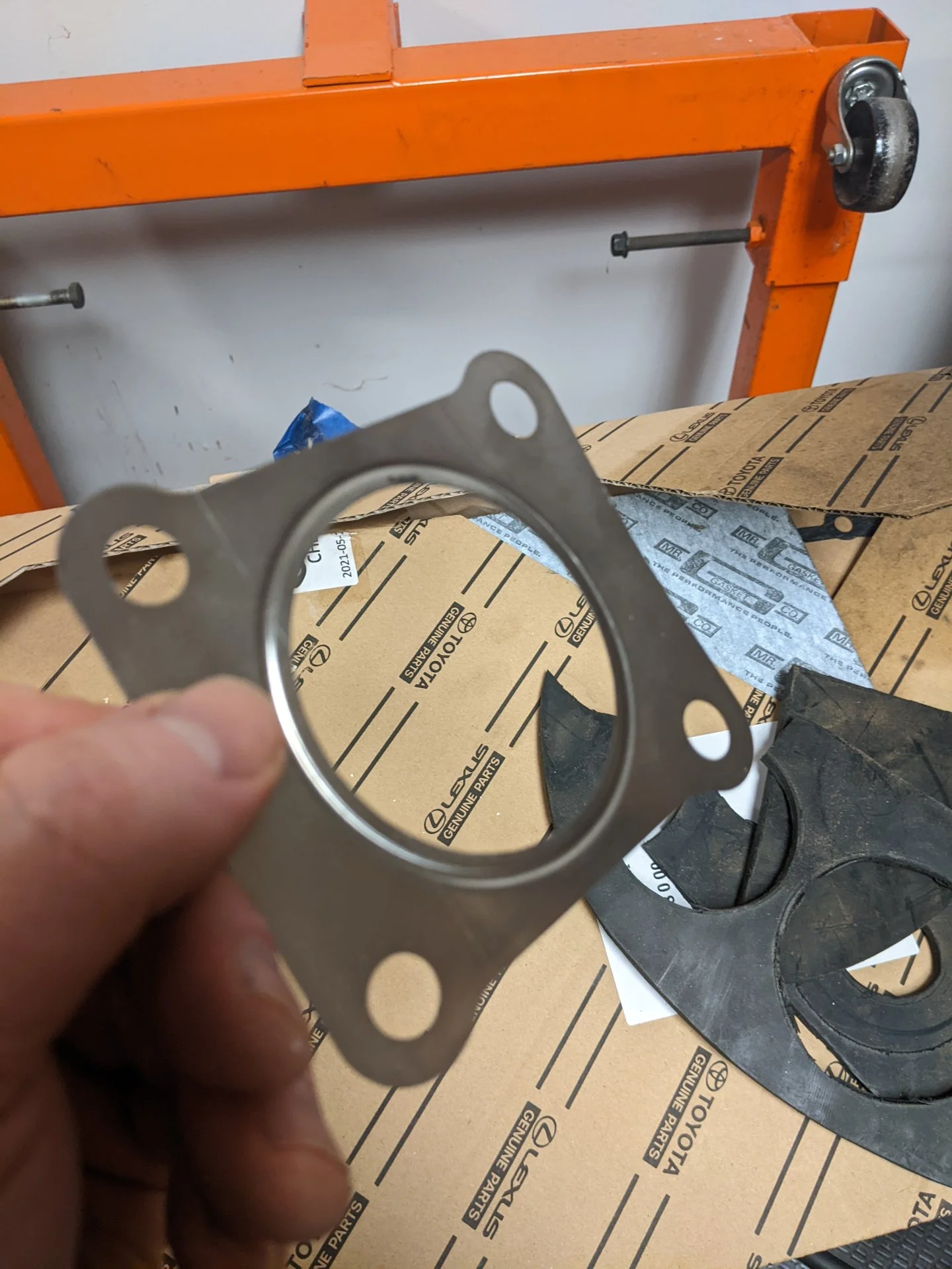

One should be a ct26 gasket which shouldn't be that hard to find? Toyota put those on everything.

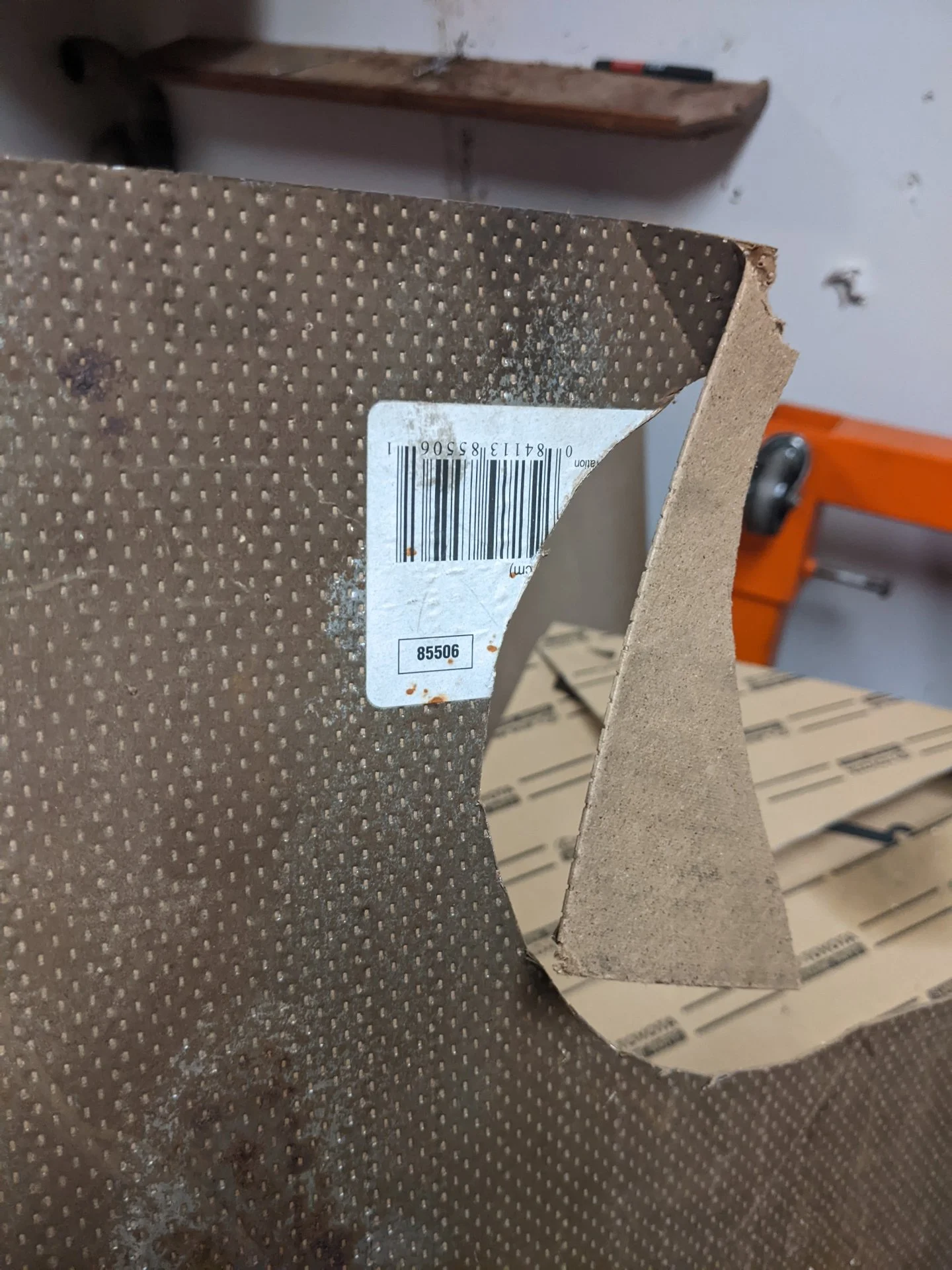

I made my own back in the day from a sheet of exhaust gasket material I got at lordco.
Metal on one side papery stuff on the other. Probably pure asbestos now I think about it. :confused:
This is the stuff I've used for ages for exhaust stuff.
Was maybe 15 bucks for a decent sized sheet at lordco....20 years ago so probably 1k now. :rolleyes:
And this is a real ct26 one. (I think) You can see the little ridge like he mentioned.
And this is a real ct26 one. (I think) You can see the little ridge like Rosie mentioned.
Yeah trying to get it fixed for next week, can’t seem to source a ct26 gasket in that timespan. Probably just going to make my own, I will check lordco for that stuff you got, does it have a steel core or just paper? Thanks!
Yeah it's steel on one side papery the other. Looks like a part number on the tag if you zoom in?
