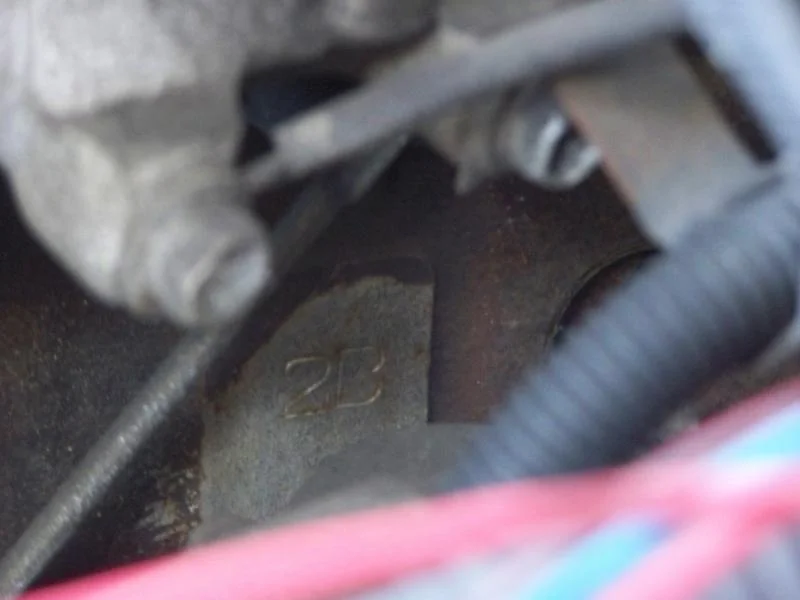

On the motor near the rear upper corner of the block you will see cast in the block "3B" if it is in fact a 3B. If I remember right it's on the left hand side of the block. To id age you would need the serial number and a chart showing the date range for that serial number.

Some pics of the engine can help ....Bell housing ,starter motor,casting numbers is there a 3B stamped on the engine,
Example
