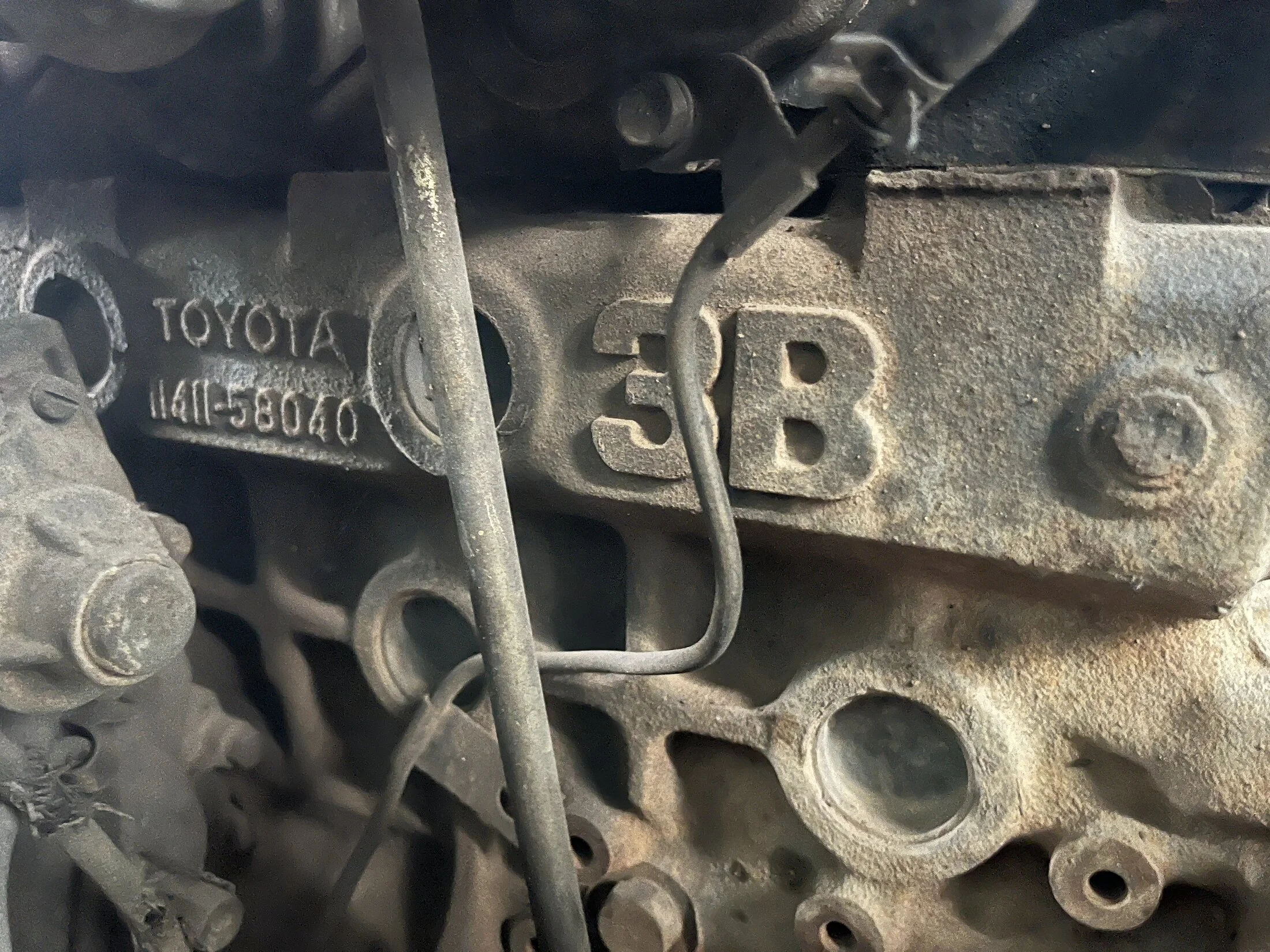

We found a (what I’m told) 3B from a 1989 70s series Landcruiser with descent mileage.
The casting code is: 11411-58040
I’ve been looking but cannot find anything with that casting code.

The engine pictured is definitely not a 1989 3B. It looks like a 3B made before August 1988.
What information are you looking for?
It's a 1984-1988 3B, very common old engine. The casting code on the block does not match any part number in the catalogue because it's a bare casting. If you buy a block from Toyota, it comes as a sub-assembly with core plugs, drain cock, main bearing bolts erc, so gets a different part number.
It's largely the same as the old B engine, just bored out to 3.4 litres vs. 3.0 litres. And it's likely to die a similar death to your B engine if you turbocharge it.
No big mystery.

Thank you very much.
That’s exactly the info I was looking for.
So it a purchased block not original to any vehicle.
Oh, I’m definitely not turbo charging it. I’ll settle for the 3500.
Am I right to assume that the 3.4 will equal the prior 3.0 with Turbo (sort of) in terms of power?
No, it's the same block that went into Landcruiser 40, 60, 70 Series, Coaster buses and Dyna trucks all over the world.
The B and 3B engines were never fitted with a turbo, so no way to know how your turbo was set up by whoever put it in there. But I would guess that it will feel slightly less powerful, especially at speed, than the 3.0 turbo.

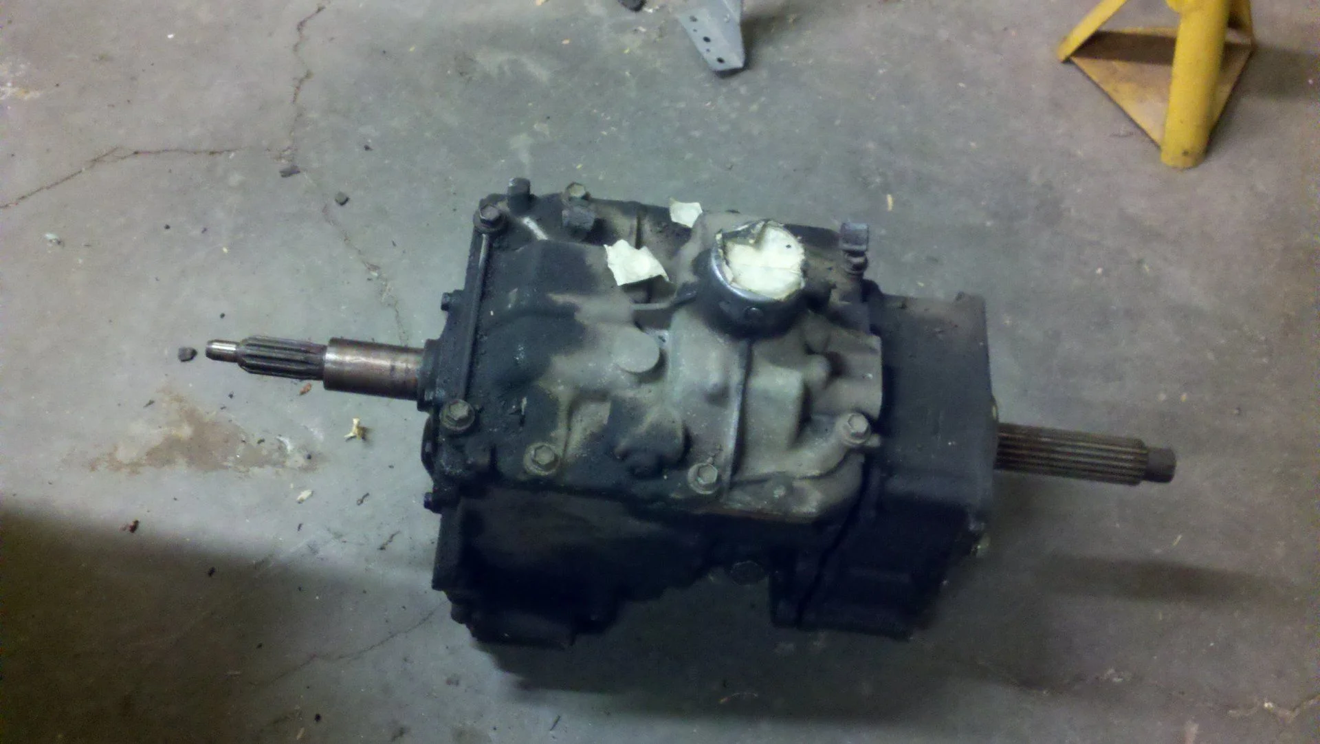

One more question if I may.
So I rebuilt the transmission and transfer case that was in the car that I bought with Terrain Tamer rebuild kits. It’s a 4 speed.
The used motor I’m buying has a transmission attached to it.
Do you gather it’s also a 4 speed or a 5 speed?
If you move that piece of cardboard, we can check. A 5 speed will have an external shift fork shaft coming from the aluminium top cover of the transmission, acrivating a crank on the top of the extnsion housing (between the transmission and transfer). The design of the top cover makes me think it's a 4 speed though.
Ok I’ll check. Thx
the rib forward of shifter hole shows a 4sp top plate. The 60/70 series 5sps are domed.
Sure looks like a 5speed spacer.
Yea I just checked with the seller. It’s a 4 speed. I might as well just use my rebuilt one. Thx
