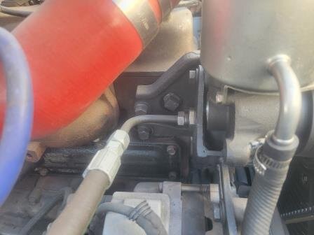

Now for the symptoms. Basically, the system boils and spews coolant out of the overflow bottle, quite a bit of it actually. I’ve tried quite a few fixes and have run all of the tests that I can think of. I don’t fully understand the coolant flow pattern through the head/block… I appreciate any help/advice/knowledge you can share.
  • I confirmed flow through the radiator
  • I confirmed the thermostat is opening (it’s been a while, but I think it was 180 or 185 F)
  • I also ran it without a thermostat
  • I confirmed that the water pump is pumping (took the top hose off the radiator and ran it to an empty coolant jug with the thermostat out
  • I’ve gone to great lengths to “burp” the system to get all of the air out – including loosening a sensor below the thermostat to let out the air under the thermostat
  • Since the 3B sat for so long, I flushed it with water for 20 minutes, backflushed it from the rear driver’s side port in the head, ran radiator flush for 20 minutes, flushed it again, ran it for 20 minutes with water, drained and refilled it.
  • After all of that, still running hot. Then I realized that I didn’t provide a path for the water to get from the rear of the engine back to the water pump – DUMB! So, I installed nipples on the rear driver’s side port in the head and the input port on the water pump. I was kicking myself and we really thought that would solve the issue. No luck, same overheating/boiling over.
  • There are still ports that I have plugged off since I don’t have an oil cooler and no heater. Anyone know if I need to open any of these and route them somewhere to get proper coolant flow? I’m guessing that coolant is just sitting in the head/block until it gets too hot and boils.
Thoughts?
