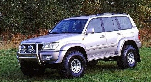

An example of what it would take to fit your 37's (a whole lot more than the typical 2.5" spring/torsion lift):
Arctic Trucks

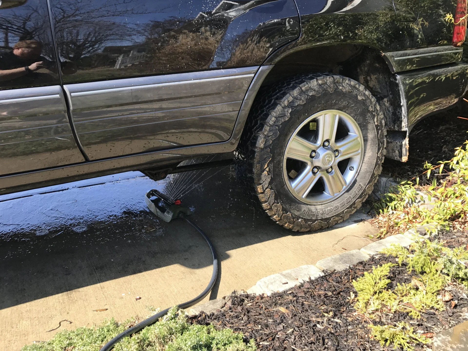

Throw a sprinkler under the truck seems to get most of the clay/mud
